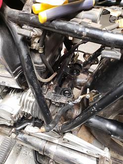

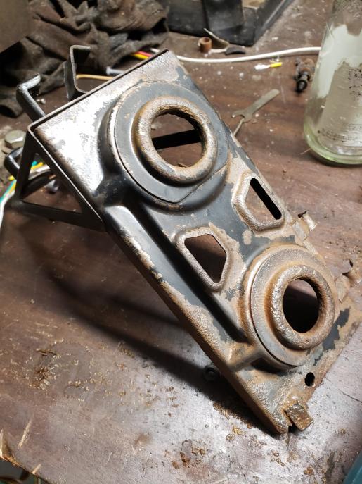

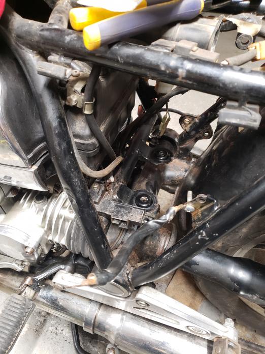

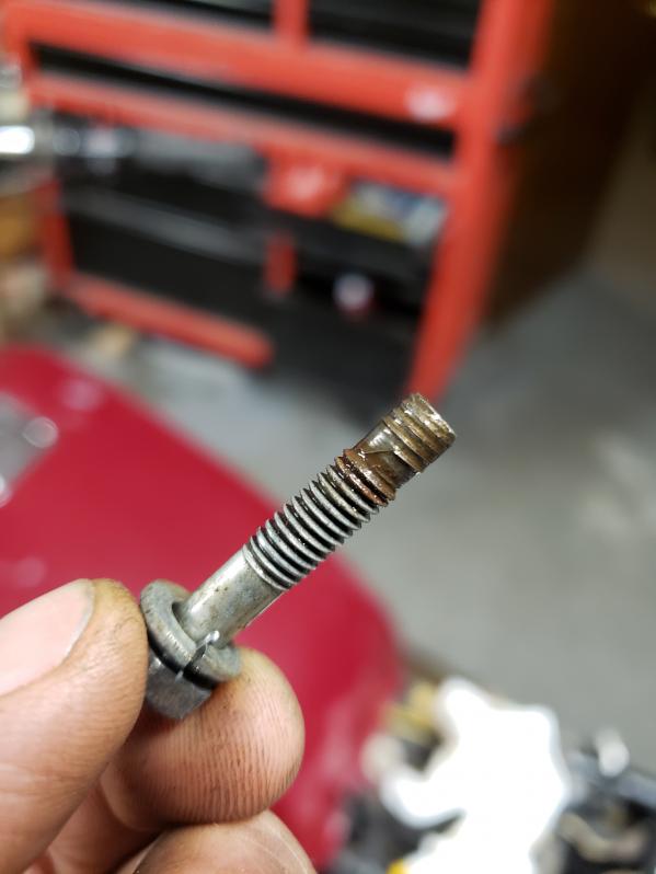

        Anyone know of a trick to remove the dang battery tray? Old battery blew and I've got some rust to manage, but the left-side bolt that connects to the rubber shock damper is apparently impossible to move. It spins freely from up top, but I cant figure how to immobilize the nut that dang bolt engages to. Halfway to cutting away the plate underneath thats blocking access! Evening #2 butting my head against this thing.
          • 8939
          #64
          Maybe try drilling a 1/4" hole in the center of the head of the bolt and then break the head off. Hold the bolt head with a small needle nose vise grips or a wrench to keep it from spinning while drilling..
          • Bax
            • 344
            • Merrimack, NH
            #65
            Hi Eab, I just did some preservation work on my battery tray a few weeks back and there should not be a nut on the end of those bolts. There is a steel sleeve that joins the rubber mounts together but the bolt, IIRR, fastens to a tapped hole. Guessing you have a stripped mount here. Thinking that prying up on the tray while turning the bolt out or the previously suggested bolt head removal are the options.
            ---Bax
            • Eab
              • 60
              • Rhode Island
              #66
              ---Bax
              This seemed to be it, plus a few shot rows of bolt thread - didn't even torque it that hard, thinking PO might've? Anyway for anyone that has this problem: I got a long flathead through a Very narrow gap underneath the housing and levered up the bottom of the bolt while ratcheting (did I mention I nabbed a flea market compressor ) and all of a sudden the bolt was fighting a bit, then backed out! Tray has seen better days but it's salvageable. Bax's suggestion didn't pan out exactly but it got me in the right direction, muchas gracias! Click image for larger version

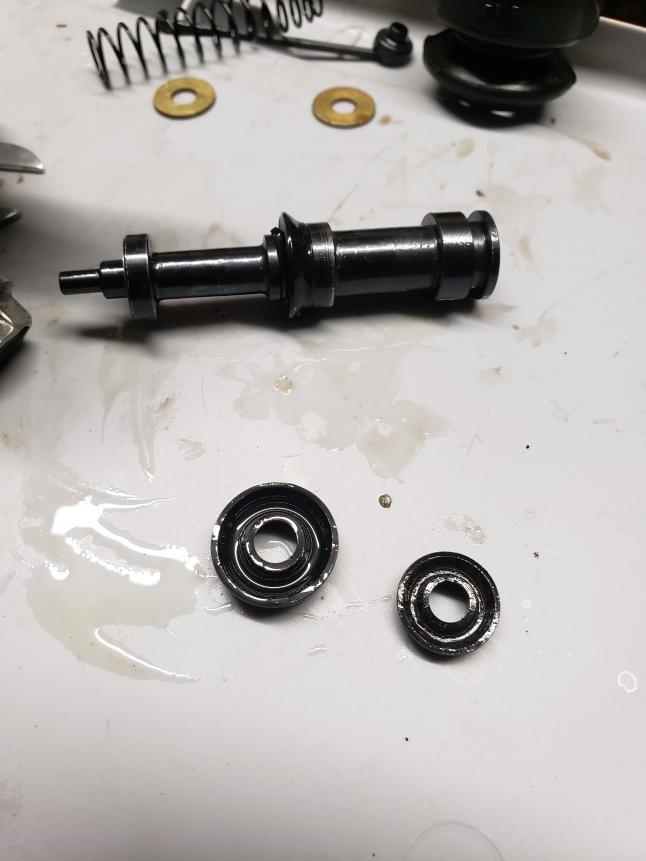

                        Rebuilt it with a kit and all seemed well. After a few days I went to put it on the bike intending to bleed it, no dice. The cup and piston had worked smoothly at the start, but I noticed it seemed rougher until it stopped working entirely, wouldnt bounce back. I break it down again to see whats up and it looks like the dang seals have tripled in size. Check out the photo, thats the OEM seal and the replacement, both had been the same size when I put the replacement in a few days ago. Used DOT3, but I've got to think this is a chemical reaction of some sort? Anyway, not thrilled. The gasket thats still on the piston has swollen too, no way it's going back in the housing without shredding apart. Contacted the manufacturer to get new seals, we'll see how that goes. Ugh. Click image for larger version  Name:	20201019_224707.jpg Views:	0 Size:	43.0 KB ID:	860046
                        Edit: 95% certain this is the result of rookie BS on my part.
                          • 8939
                          #72
                          I've only seen rubber seals swell like that when carb cleaner was used instead of brake kleen. Otherwise the seals could be defective. Could the brake fluid somehow be contaminated?
