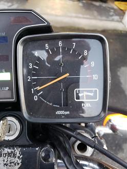

                          Just took the first (legal) ride, local side roads topping out at 40 (not due to malfunction mind you). Changes gears no trouble, got smoke off the engine a bit but I think thats just misc cleaning chemicals, spilled oil residue etc burning off. Tested the idle when I got back home to see what it'd do with zero enrichment, it idles at what looks like around 850 when it's relatively warmed up, which seems suboptimal. I believe the spec is around 1100... the revs go up very slightly (when its hot) when I hit one of the carb mounts with WD40 so it looks like there's a leak there, but its not dramatic so I'm thinking it's not a huge problem. Figure I'll rub in some hylomar blue into the cracks and see if that changes the game any. Might be that the vacuum leak is whats hurting my idle.

                            Congrats on getting it out on the road! I always wished my bike had a fuel gauge like yours. Oh well, at least my XS1100 has a low fuel light, which is more than I can say for my XS650 or my Suzuki TS250.
