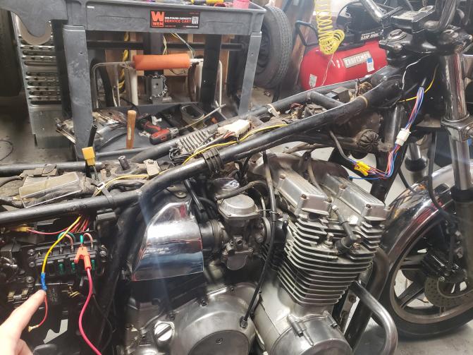

            What's your schedule like this weekend? Plans later tonight but this is my off weekend, plus my SO is on a trip with her family so I'm going to be doing a lot of fiddling. Swapped out the main ground and redid all the crimps near the fuse block and I'm still getting the same results on turnover. Still stumped - I was able to run it before jumping the solenoid contacts but even that isn't doing the job now. Click image for larger version

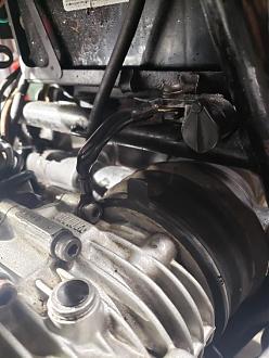

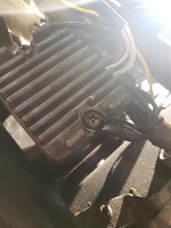

              Try running a second ground wire from the frame/battery connection to the engine. I used one of the middle drive bolts. I'll try and get a photo later today.
              For the voltage leak, try unbolting the positive lead from the solinoid and see if you still have a draw.

                  #98
                  Key in the off position and the positive terminal pulled from the solenoid and I'm getting .5 volts across the main fuse terminals.
                  There's this loose wire that had been tied into the accessory port before, can't see what it does but I suspect it's related to a three-way toggle on the top of the head light housing (possibly handlebar heaters that some PO added and removed?). When I re-engage that wire to the post it had been attached to, the voltage across the main fuse jumps to 7.5, with the key in the off position. Could some remnant of whatever this was be causing the leak? I've left this thing disconnected as I've been troubleshooting this. It's the yellow wire in the photo, you can follow it all the way to the headlight housing.

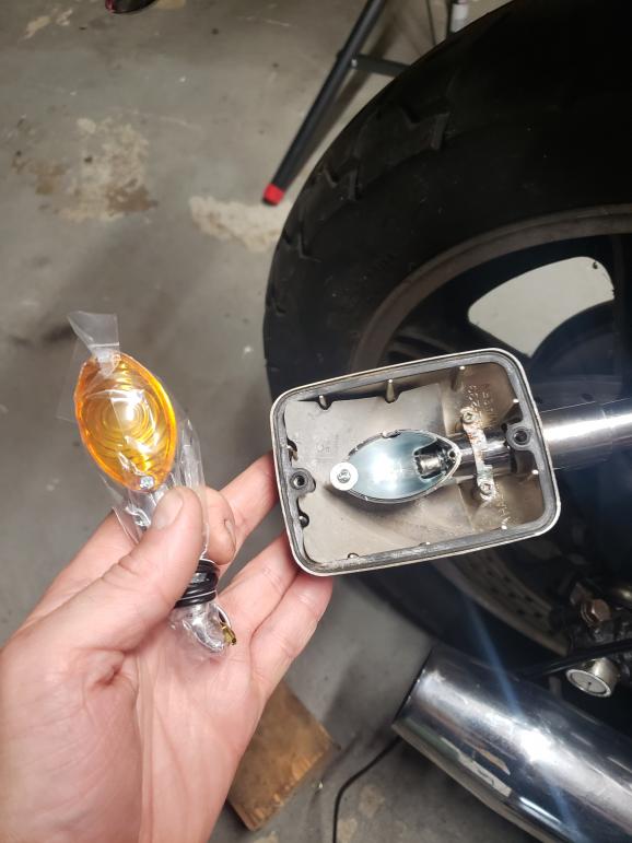

                    Figure I might as well solve SOME problems at least this afternoon: got these replacement turn signals in from Mike's. Apparently material being chrome also applies to plastic... but I've found a workaround. Old signal housings are in great shape though the rubber boot and wires are no good, be a shame to let them go to waste HAH Click image for larger version

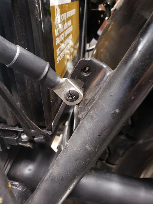

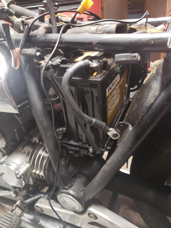

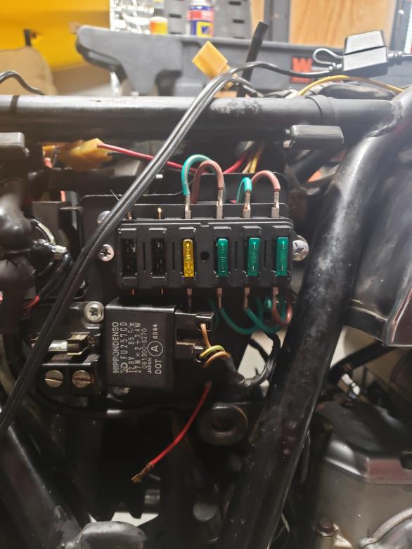

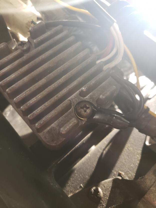

                      Also, these ARE the three grounding points....? A lot of folks have said this sounds like a bad ground and I've serviced the heck out of these three points: wire-wheeled away corrosion etc on both the wire and grounding points, and it seems to be acting the same regardless. For good measure I cleaned up the connection point from the hot wire to the starting motor as well.
                      In the process of checking the starting motor one of the bolts holding it on snapped so... hopefully I don't need to replace that. #@*%. Click image for larger version

                          EAB, while you are checking and cleaning up wires. Behind the fuse panel are two large connectors that have been known to melt so check clean or replace those. Probably not related to your starter problem just an area of known issues. With your 6 fuse holder you can discard the fuse accessory block.
