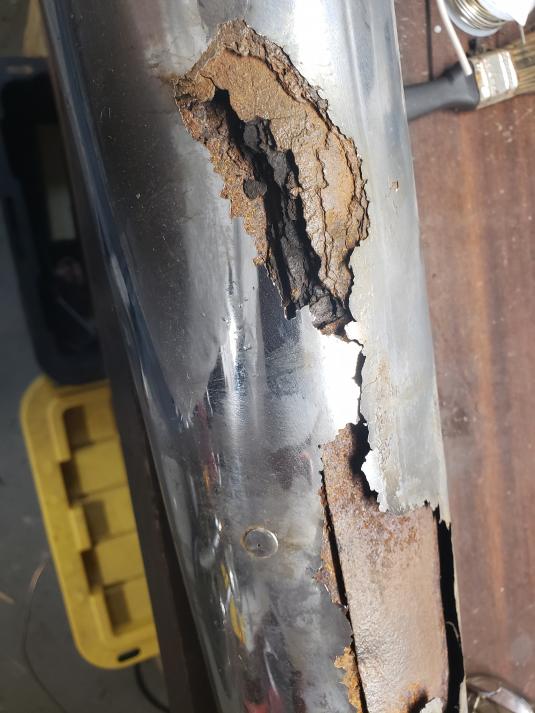

        Got the pipes off... afraid they don't look any better from this angle. I'd been hoping for some (potentially ugly) magic bullet but it looks like this is going to be The Expense for this rehab. That stings a bit. Click image for larger version

          You're probably going to have to find something used. Mac was the last, and none of the vendors show as having them. If you can save your headpipes, mufflers shouldn't pose a problem.

            They look pretty rotted out,,,,,check out the "search" section for harley mufflers,,,,you can saw off the old mufflers after the crossover or before, keeping the headpipes which are probably good,,,,get a pair of harley mufflers, a pair of muffler pipe adapters and you will be good to go,,,,,unless you can score a reasonable factory set,,,,,,Mike in San DIego
