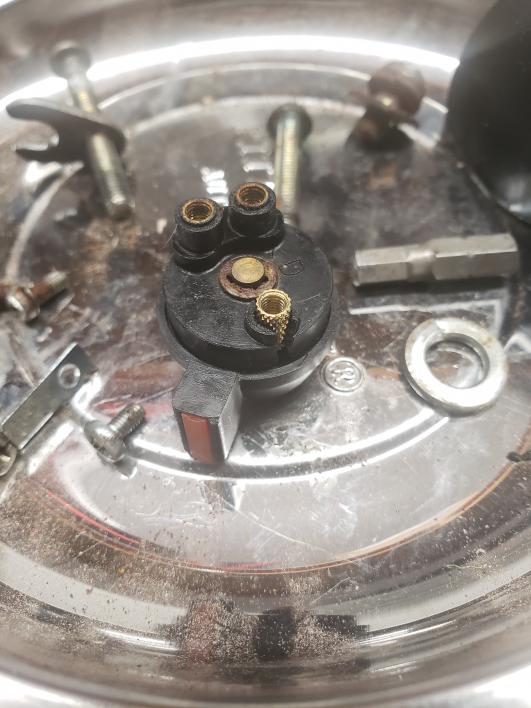

      Well, here we are. The kill switch, which looked mint from the inside of the housing, was rusted at the contacts And has a cracked housing. Anybody know if it's possible to get just the toggle switch, vs the whole assembly? Probably out of luck. I could try to patch it with epoxy or similar but it's not hardware I want to fool around with. Click image for larger version

        • 7840
        order a right hand switch assembly for any lat '70's Yamaha. You now have all the new parts you need! Wire ends and length are the difference between models.

          Got the new switch And new solenoid en route - despite a cleaning it's not holding up its end, and I'm picking my battles.
          Learned three things last night!
          1) the cutoff switch was engaged even when reading "off", starving the starter of powe

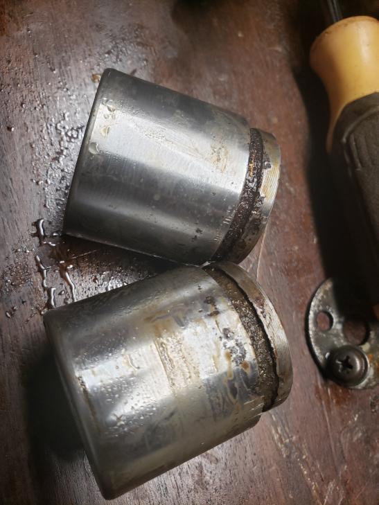

            Got the front brakes disassembled. The cylinder necks (that engage with the rubber) are badly corroded. Anyone know if that's problematic? It's only the tapered portion, hoping i can grind off the rust and put it back into service. And I'm not gonna toss the brake pads!

                Looking possibly at replacement brakes. Thought I could wire wheel and sand off the rough patches on the piston, but it Does Not want to get back inside that sleeve. I'm not sure it'd make for a good seal anyway, looking at it. Click image for larger version

                • Bax
                  • 344
                  • Merrimack, NH
                  Can get kits with replacement stainless pistons from Brake Crafters

                    Good call! Got them coming with the rebuild kits. There are a few aspects of this rehab I don't want to mess around with.

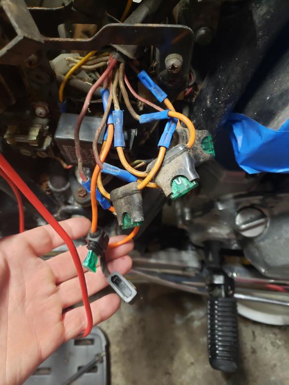

                    I wonder, do folks doing a rehab like this generally pull all the wiring out and redo with fresh wires as a matter of course? I've cleaned up the ground connections and all, but if broken wiring inside the sheathing is a pretty standard problem, I'll bite the bullet. Got to track down a usable fuse panel anyway, so I'll be fiddling with the electrical in any case.
                      • 7840
                      That looks like my first attempt to replace the fuse box. As long as none of the wires are rubbing against the sharp edges of the sheet metal, you should be OK.
                      The main problem areas with the old wires are the connections. Clean or replace connectors that are dark colored, and replace any that look like the plastic has gotten hot. Tony has the replacement parts here: http://www.oregonmotorcycleparts.com/ he is a member of this board, and has been for quite a while.
                      Her is a link to the electrical on this site: https://xs11.club/forum/repairs/battery-electrical-aa This has all the info you will need to decide how far you need to go with the wires.

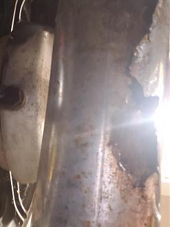

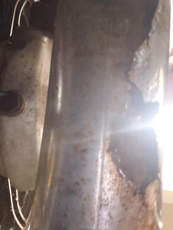

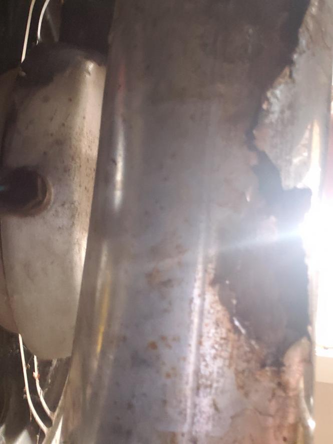

                                Ah that makes sense, sorry. I've addressed the control unit issue at least, did it the hard way, but now I'm on to what I suspect is the Big Problem: exhaust. I've got significant rust on one of the silencers, but from what I've read here replacements for this particular thing are Very hard to come by.
                                I'm trying to figure ways to address this. I don't know how to weld, and don't have the kit for it, but if I have to pay someone to do a little work that's OK. I'm mourning the chrome pipes look a bit, but other parts of the exhaust are pretty rusted (not as bad as this!) elsewhere.
                                I want to get it up on my bench to look it over, but I can't see how (once it's disconnected) to do so. It's the stock unit, with the small boxes built into each where they connect in the middle. My Haynes doesn't cover the removal procedure. Under normal circumstances, I'd fiddle around in some hopefully nondestructive way but with the exhaust being as irreplaceable as it is, I'm breaking out the kit gloves.
                                Anyone know how to get the exhaust off this thing? I'm guessing it involves disconnecting the two halves (right and left) but I don't want to bet my pipes on it. Click image for larger version
