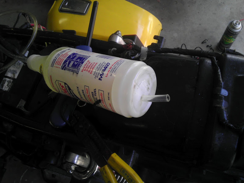

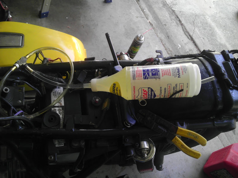

        fuel bottle
        I made a little auxiliary fuel tank from an old empty Lucas Fuel treatment bottle.
        Drilled a hole in bottom just slightly smaller than some clear line I had.
        Cut off cone shaped tip to just smaller than the line also so line could be press fit in both - cut line about 18" long...
        Measured where line would be inside the bottle if 2" stuck out bottom of bottle, then drilled 4 small holes in the thick fuel line. Now when bottle is filled, line in hole in bottom keeps fuel from dumping out when filling. Screw cap on and turn upside down after hooked up to a fuel tee.
        I just set bottle on frame and it gravity fed the bike fine - you could squeeze lightly or raise up if you need more flow.
        The line out the bottom acts as a vent and allows free flow out nose.
        Anyway its nice to be able to work without big tank in the way.
