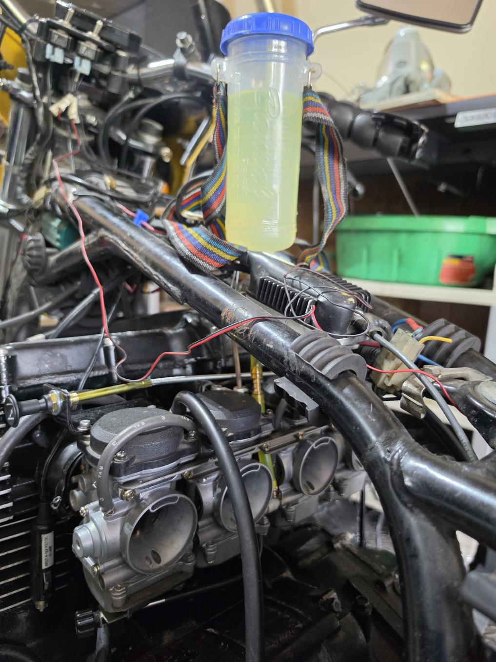

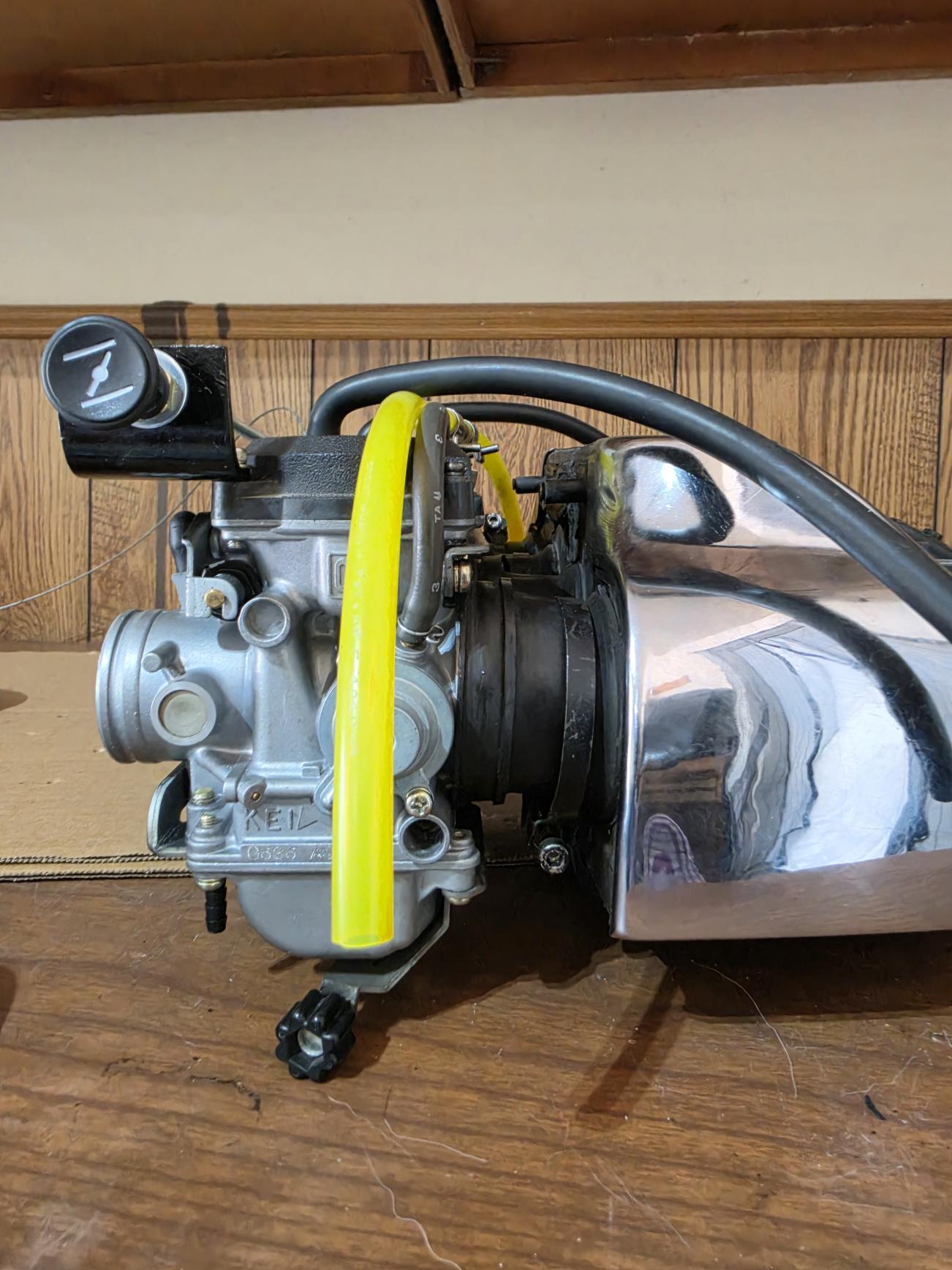

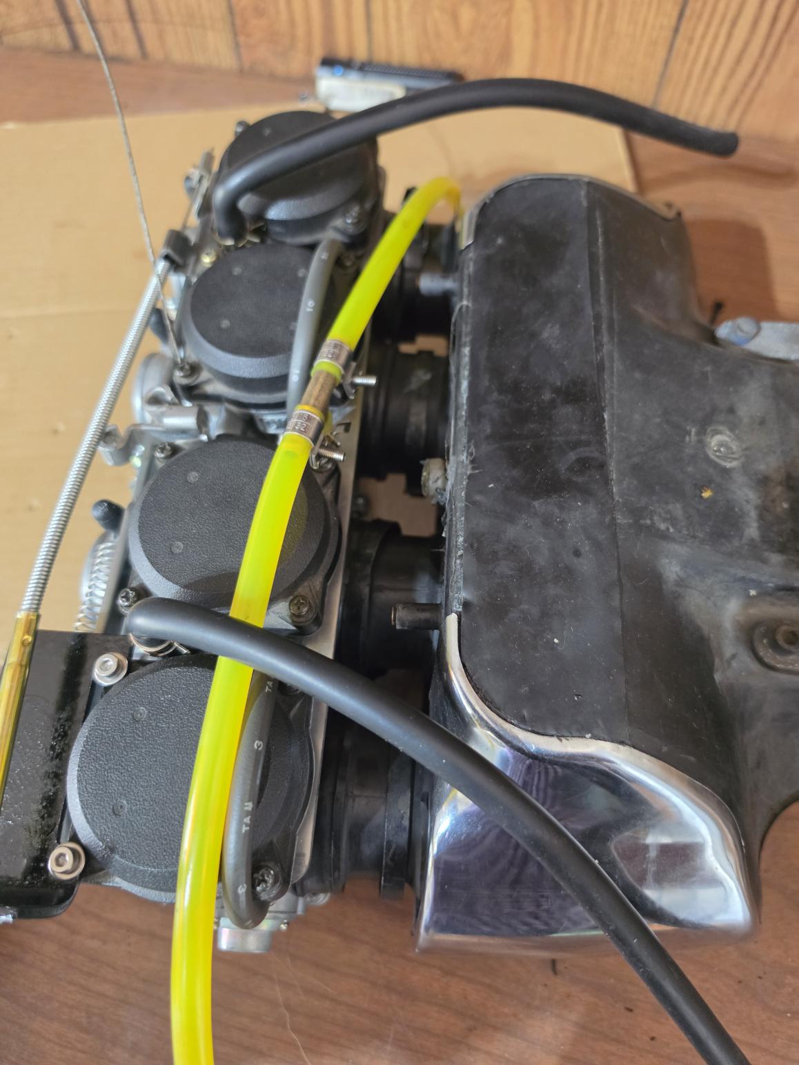

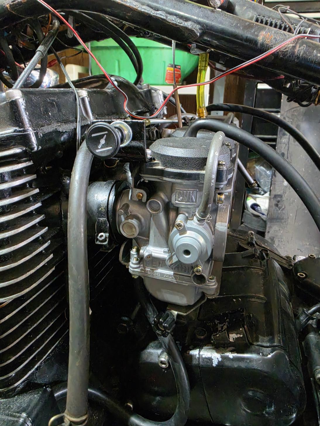

                Okay, a couple things to confirm:
                1. The carbs WILL mount to the OE airbox
                2. The carss will mount to the OE intake manifolds without issue
                3. The carbs take a decent amount of gas to keep the float bowls full Click image for larger version
ID:	890818 Click image for larger version
ID:	890819 Click image for larger version
ID:	890820 Click image for larger version
                  • 3993
                  #38
                  okay, got it started. I'll have to pull the carbs back off, and put the airbox on to start getting an idle, then swap the plugs to see what's going on with the tune.
