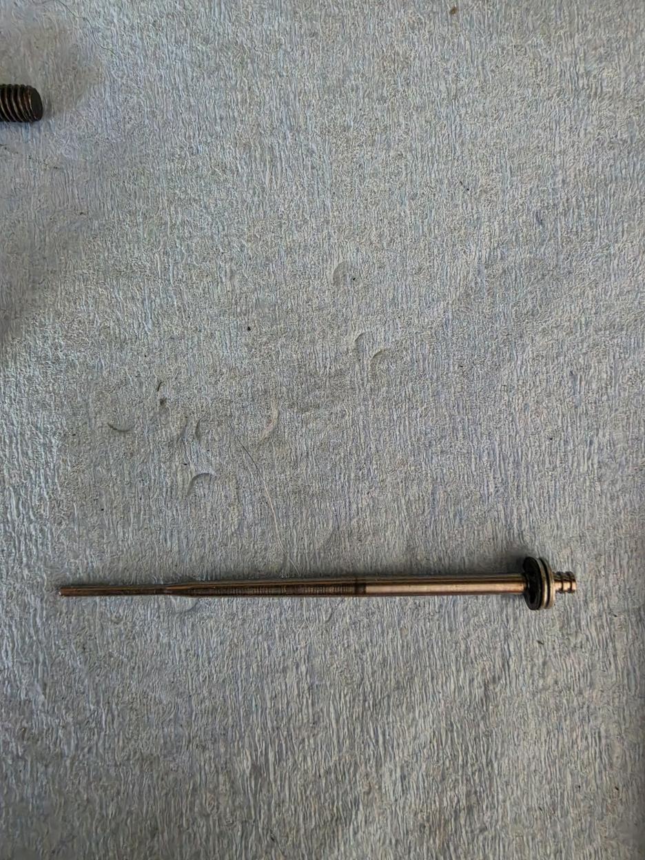

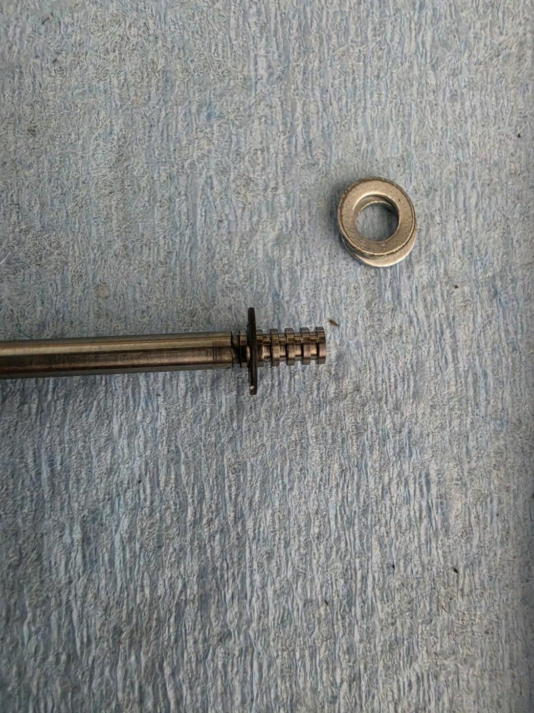

A needle with adjustable clip says an aftermarket jet kit is installed. Pull the bowls and see what main jets are in there. If those were jetted for pods, you may already have 130s or 135s in the carburetors. There were basically four main players in the aftermarket jet kits for the ZRX.
If you would take a picture of a needle I can give you an idea who's needles are in there and helps to know where to start.
Clarify: Shimmed needles with clip in the lowest position. Is there a shim under each clip, or only the two shims on top of each needle? It's a minor detail, regardless the clip in the lowest position is as rich as it can get on the needle.
The two shims on top are to take up the space between the top of the aftermarket needle and the bottom of the plastic spider that sits on top of it. It makes no difference in the jetting as that's controlled by the underside of the clip. Some guys swear you need them, other people who are in the know that I've talked to you say it makes no difference. I personally don't run them on top of the needles. However if you have them, leave them on top unless you're going to use one of them to adjust to half clip position.
Typically the clip is put in the middle position, middle of the road to start, on most needles it is the third one down. There's one brand of needle I believe that has six positions, you'd still want to be in the third one down.
I'm probably as curious as you are as to what is in those carburetors already. It will be real helpful to know as much as we can.Last edited by Bonz; 06-23-2026, 08:20 AM.Howard

Well, I was wrong, second from the bottom:
2H9 Mod, Truck-Lite LED Headlight, TECHNA-FIT S/S Brake Lines, Rear Air Shocks, TKAT Fork Brace, Dyna DC-I Coils, TC Fuse Block, Barnett HD Clutch Springs, Superbike Handlebars, V-Star 650 ACCT, NGK Irridium Plugs, OEM Exhaust. CNC-Cut 2nd Gear Dogs; Ported/Milled Head; Modded Airbox: 8x8 Wix Panel Filter; #137.5 Main Jet, Viper Yellow Paint, Michelin Pilot Activ F/R, Interstate AGM Battery, 14MM MC, Maier Fairing, Cree LED Fog Lights.Comment
Well, I was wong: seconf from the bottom. Six positions.1979 XS1100F
That is a Dynojet needle, they have the aggressive shoulder step and six Clip positions.
Dynojet kits for the ZRX 1200 also had different diaphragm slide springs that are lighter than stock.

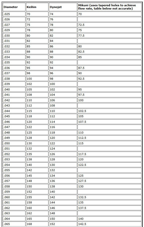

Dynojet has their own jet numbering system, but that's just to be different in my opinion. However, your jets may be the Dynojet style in the carburetors already. As from the first page of this thread, the DJ numbering system is quite different than Keihin.
Little of that necessarily makes a difference if you are tuning from the ground up, but that's what those carburetors most likely have.

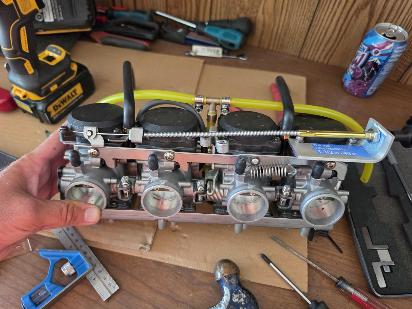

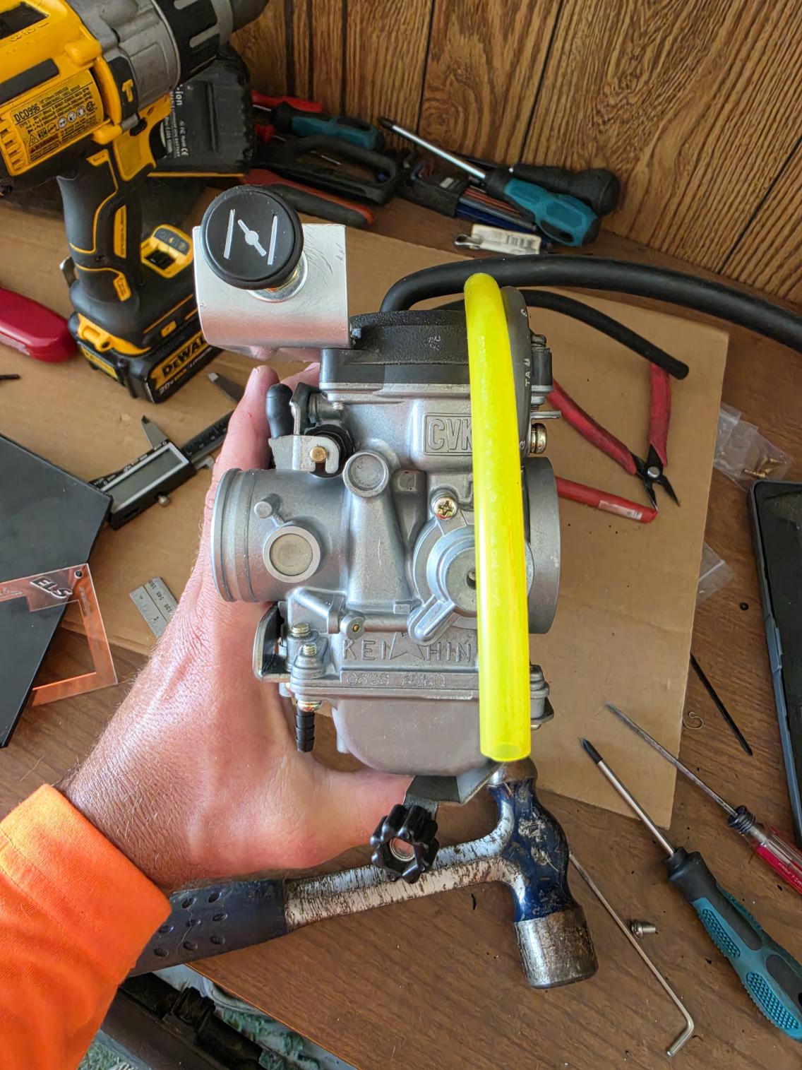

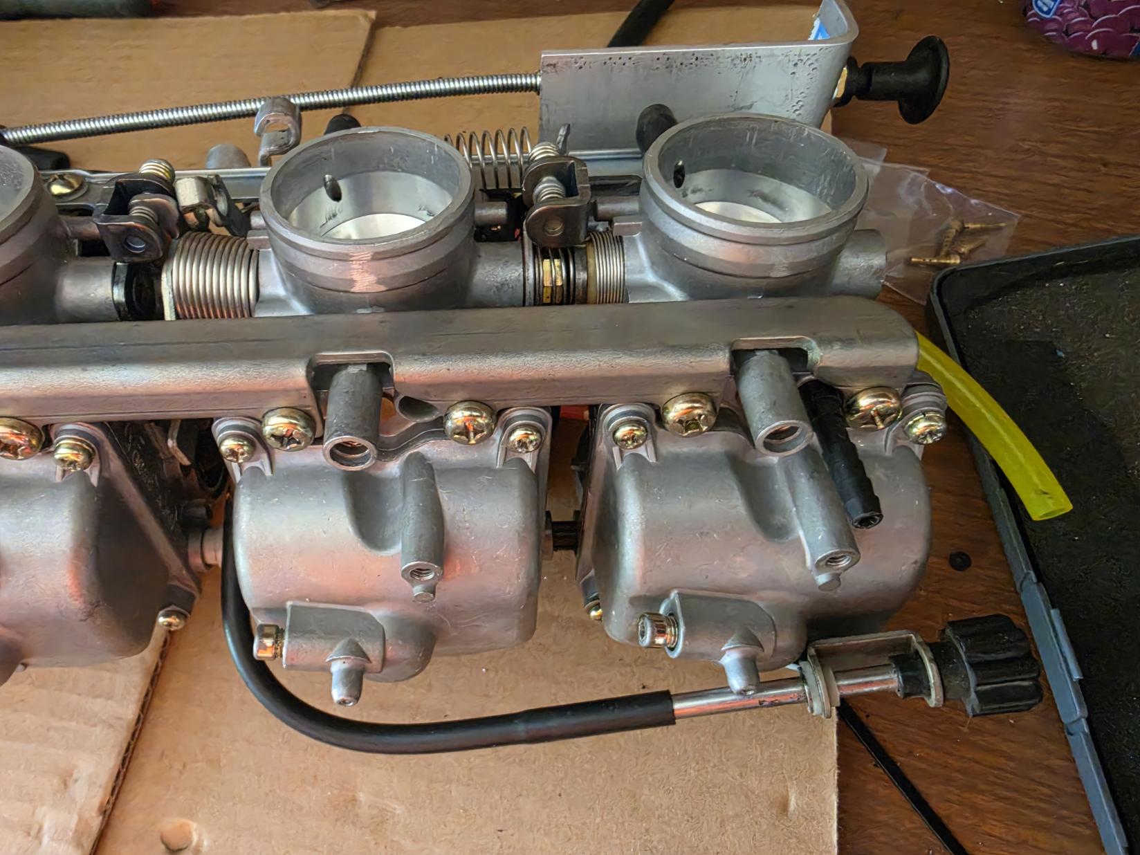

Making progress. I'll pull the choke bracket back off and paint it black. My days of access to a mill are over, so it's good enough from a workbench.
I have 140 mains, with 38 pilots in, to start. I have the A/F screws out 1-1/2 turns.
Three sets of new BPR6ES plugs ready to tune with.
Next up is mounting and throttle cable fitting.1979 XS1100F
