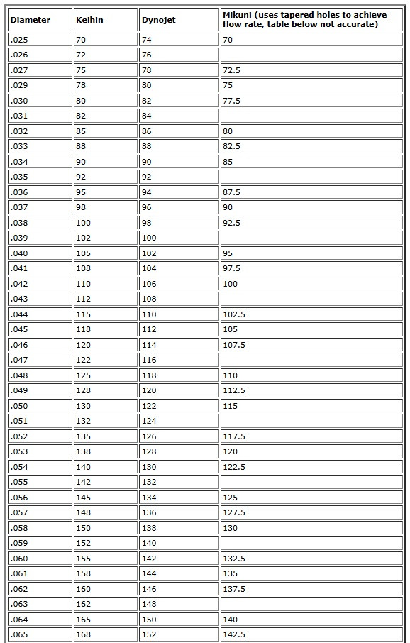

Name:	Jetsrus jet compare chart.jpg
                  • 2053
                  Note: Chinese jets are drilled cheaply without much quality control. You can have two jets with the same number with different orifices due to burrs. In the end you are not saving any money. They are almost impossible to work with. The bike will run but it won't run right.
