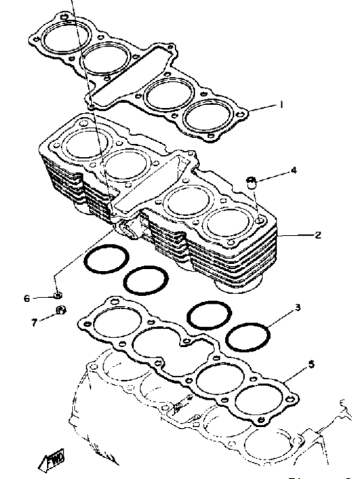

    And oil could run down under the right side cover from the front and make the seal leak seem worse
    I believe the answer to this is yes. I have oil under both L + R side covers and neither of my crankshaft seals leak. The wind will blow that oil all over the place making it very difficult to pinpoint leaks.
    Once these cylinder O-Rings go bad, oil will eventually seep past the base gasket, up the cylinder head studs and out...

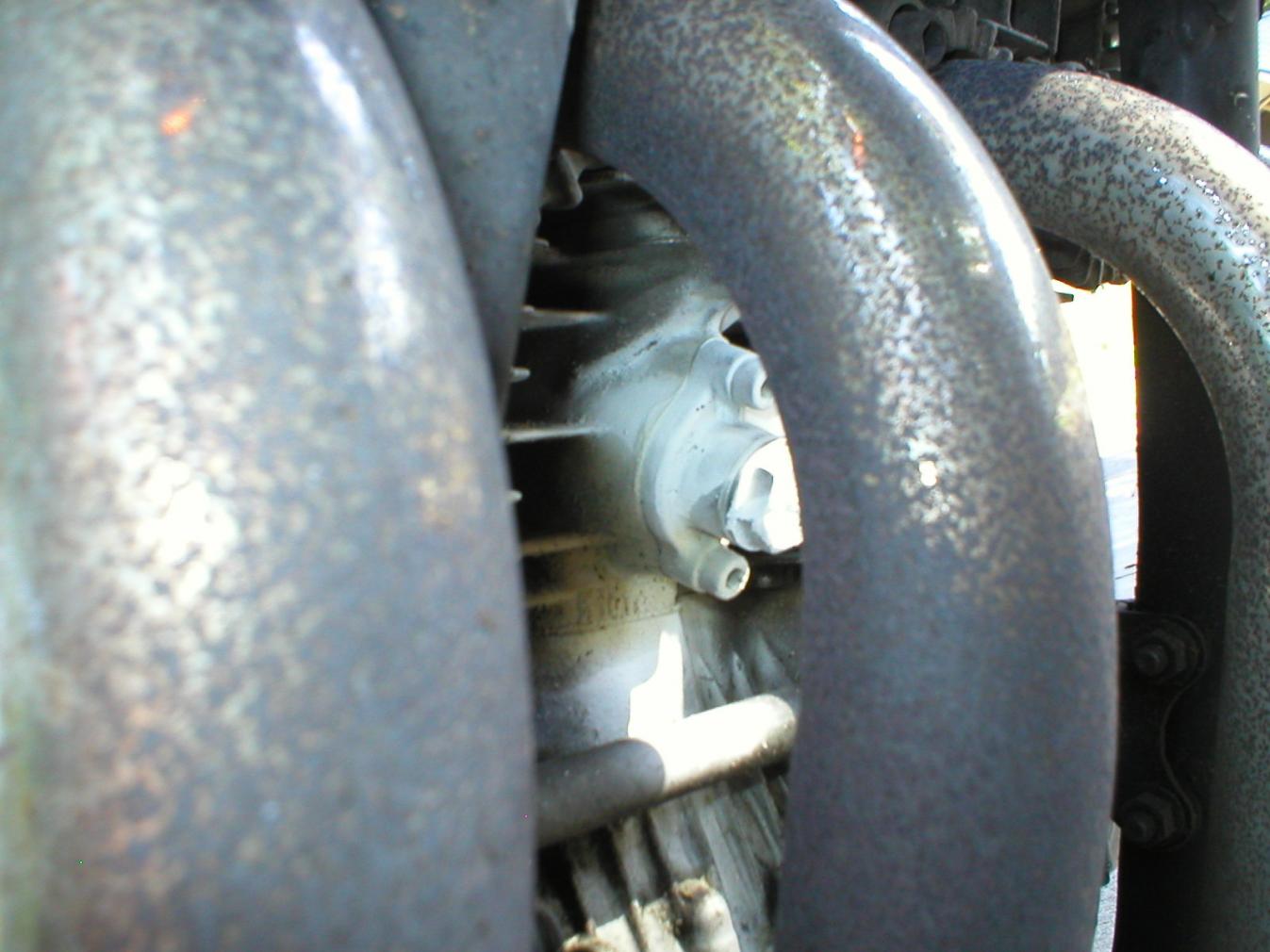

ID:	879517 Looks like the tensioner bolt and gasket are good. Leaking from the inside right bolt and for awhile.

        #48
        I installed a tensioner froma Venture/ Ventura? I got on E bay.
        Probably from a Venturer (note that the Venture was the 81H).

          #49
          Some tensioner housings are thinner than OEM which makes the bolt bottom out.
          Skids (Sid Hansen)

              #51
              Yes. The bolts are different. I did install correct bolts for the tensioner.
              The cylinder bolt is what I meant to say is where oil is leaking.

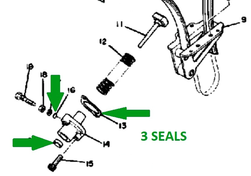

                #52
                I have an oil leak at the chain tensioner. Can it be anything else than the gasket behind the tensioner. It's a 1978 XS1100
                  #53
                  Yes, there is a seal on the original XS1100. It plugs the hole on the outside. You can try and clean it really well and then seal it with high temp silicone.
                    #54
Name:	3 SEALS.jpg
