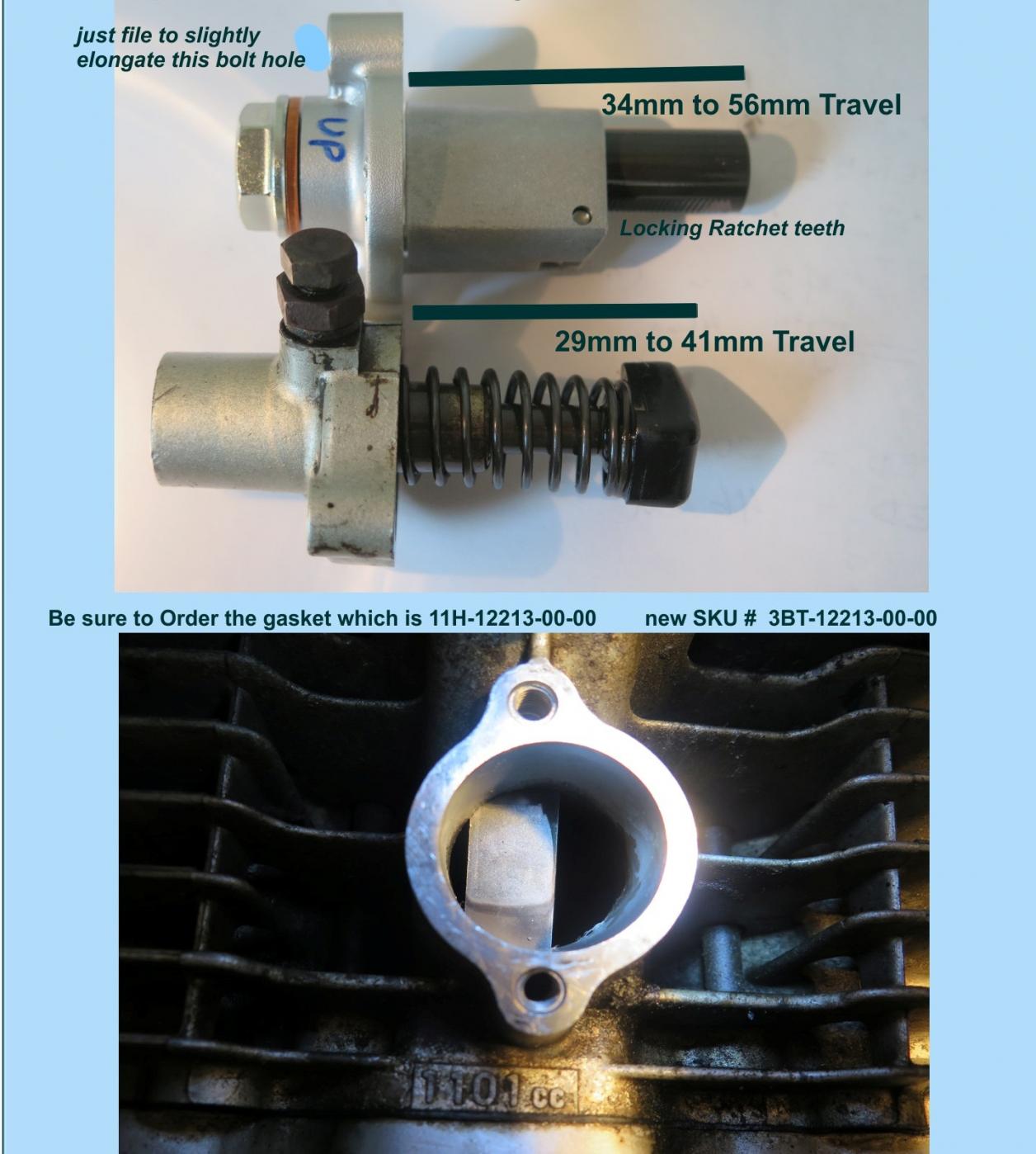

    I'd buy another tensioner gasket and try again.
    Make sure the mounting bolts aren't hanging up on the side walls of the tensioner.
    I had a leak like yours, and I had to file the mounting holes of the Vmax tensioner to get the bolts to sit properly and stop leaking.
      As Mike stated, it sometimes requires a little filing on the right hand side of the holes to keep the tensioner from distorting upon tightening.

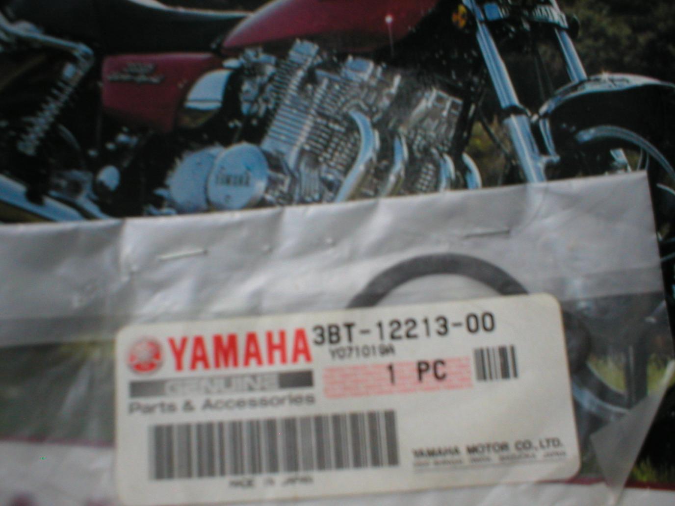

          That's the wrong gasket. I re-used mine after filing like y'all said. We'll see...
          80 G

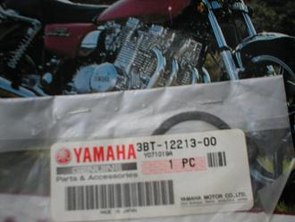

            Picked one up at Martins in Ocala about 4-5 weeks ago, they had it in stock. Apparently there's a superceded part number that doesn't show up on the parts fische except at dealerships.

              I got that one at Martins in Ocala day before yesterday. It doesn't quite fit any which way.

                Seeing that mine still has an ever so slight leak I'm going to try filing those holes like DEEBS etc al have suggested. The gasket Martins sold me fit just fine and there didn't seem to be any interference getting the bolts in but a wise man knows what he doesn't know.
                  #38
                  The original 1978 part number was 2H7-12213-10-00.

                    #39
                    Yea thats the one that works

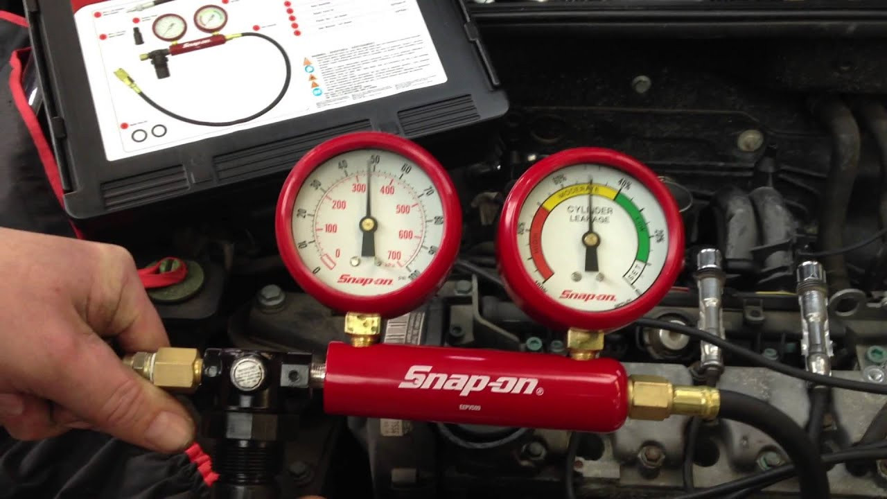

                                Speedlimit85, You seem to have a few leaks in different areas of your motor. Make sure your breather is not blocked somehow. Might have excessive crankcase pressure. Could be leaky compression rings. How many miles on that motor? A leakdown test could determine if you have a ring problem.
