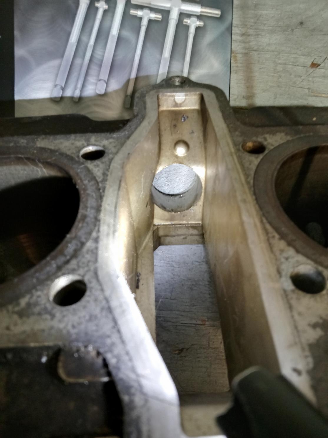

            I just looked at the part of the engine with the tensioner, the bolt holes do not go all the way thru, so it is probably the gasket leaking.

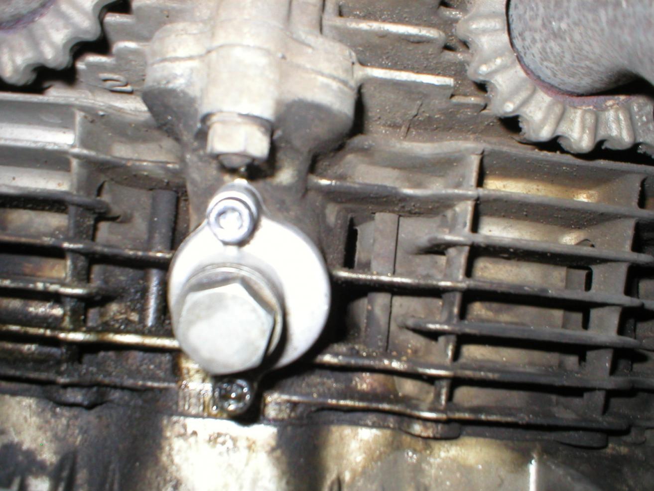

                          I think you're right the oil seep is likely the gasket. Looks like the old OEM and new ACCT tensioner have it in the same spot ( yes I got the v-max bolts --right ones and I tightened careful ).
                              80 G
                                Looks like the beginnings of the base gasket leaking. Look where the head bolt studs pass thru the cylinders on the bottom. If it's oily wet a bit, that could be the culprit. I hope that's not the case.
