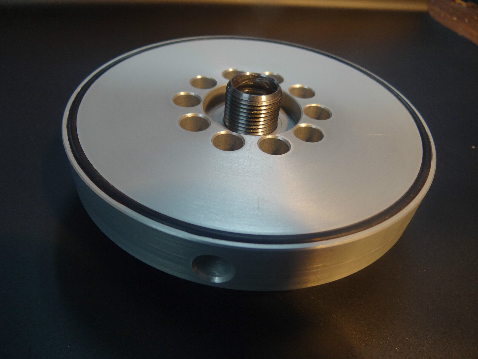

    Just trying to save some machining time
    Hi TC,
    I sent you a PM about this project but in addition, I just noticed you enlarged the 1/8" holes to 1/4" and six 1/4" holes equal one 5/8" hole, not the 3/8" in my PM. Also can you not flip the jaws in your 3-jaw self-centering chuck to save you the hassle of manually centering the work in your 4-jaw each time you set up?
    Admittedly, unless it's a very good 3-jaw it won't re-center closer than 0.005" or so but this project don't have a precise concentricity requirement.
