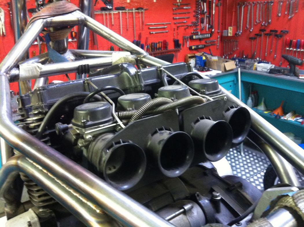

        Suzuki carbs installed with stainless steel supports added to keep them from moving up and down. The supports are fixed to the rubber air intakes to keep them from vibrating.
        Click image for larger version  Name:	3412010-A-8-B89-4-CBE-B0-F6-9156-C78-CD886.jpg Views:	0 Size:	130.3 KB ID:	876265

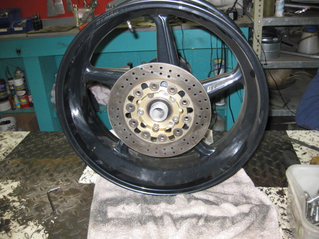

        Magnesium Dymag with floating rear Brembo disc:

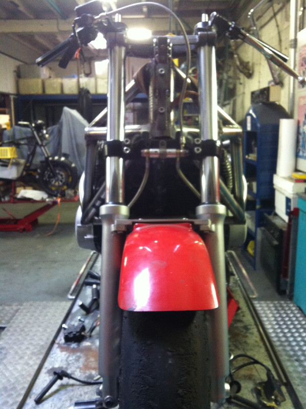

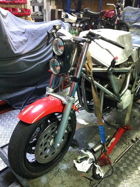

        Pre exup fzr 41mm forks with early Gixxer front fender:
        Click image for larger version  Name:	6668865-D-4204-4359-B543-C669-CB504422.jpg Views:	0 Size:	142.7 KB ID:	876267

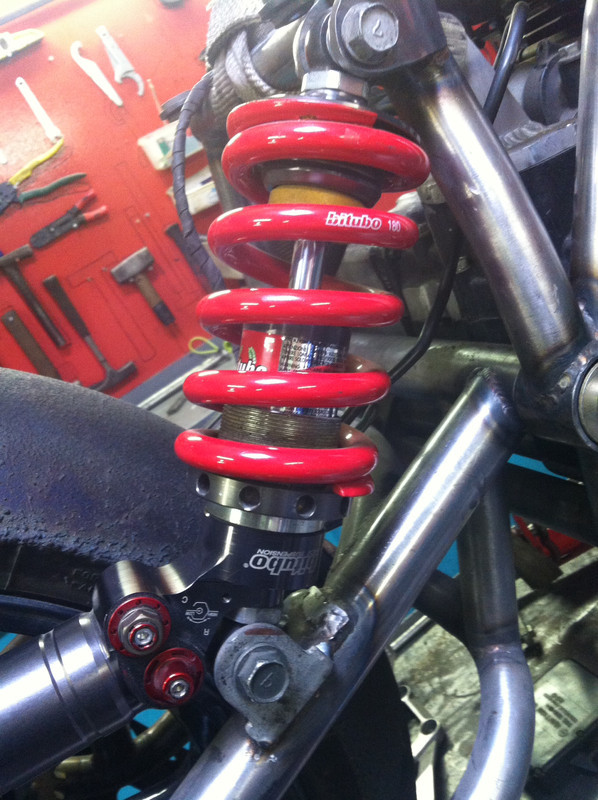

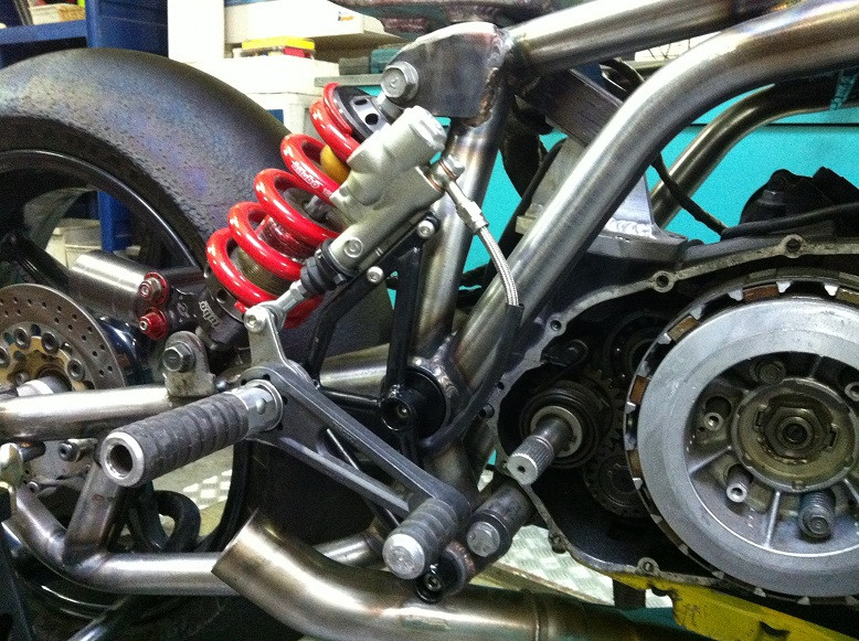

        I sold the Fournales air shock and replaced it with a Bitubo race shock for a Kawasaki ER-6:
        Click image for larger version  Name:	69977-A68-18-FE-4-DAE-AA8-B-A9-C444739-A0-E.jpg Views:	5 Size:	159.6 KB ID:	876650

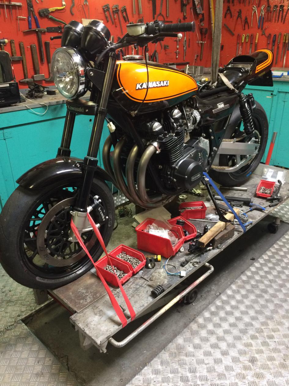

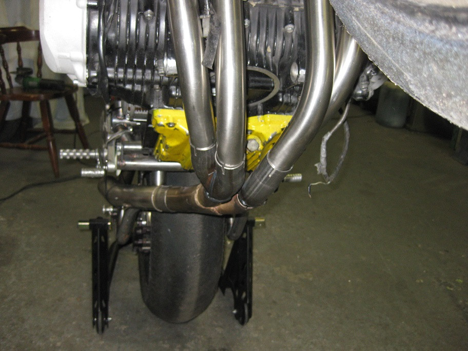

              Well.... I have started work again on this never ending story and before writing again about it wanted to refresh some posts with new pictures as the old ones were lost during the transition to the new site. So I did that and it took me an hour to add about 18 pictures and after I finished I entered and got the message that only 5 attachments are allowed.... So, it's getting late now and try to refresh some pics from the beginning to the end in the next weeks. After that I will start posting some pictures of the new work done on the bike.Hope you'll like that.
              Here a couple of teasers that did not make it to the end ....the 4-1 had to go...

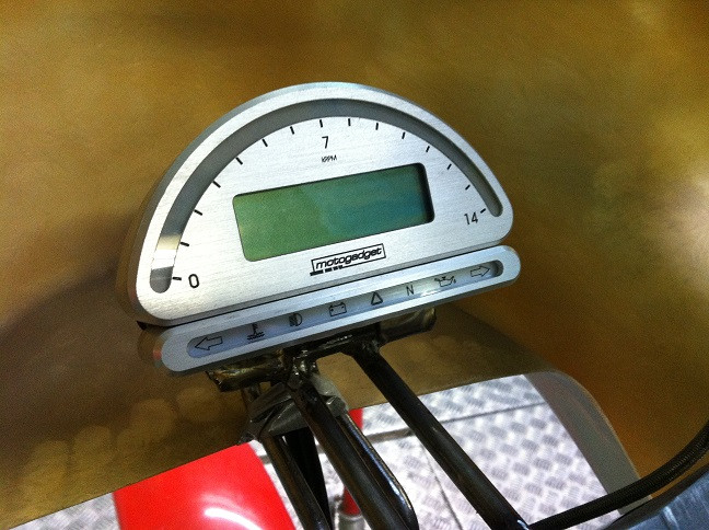

              This Motogadget electronic speedo / tacho had to move as it looks too modern...

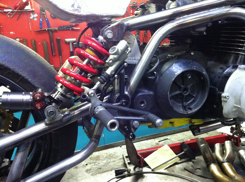

                          Thanks man. Sadly that RC exhaust did not make it either. As of now you'll see some work that did make it to the end...

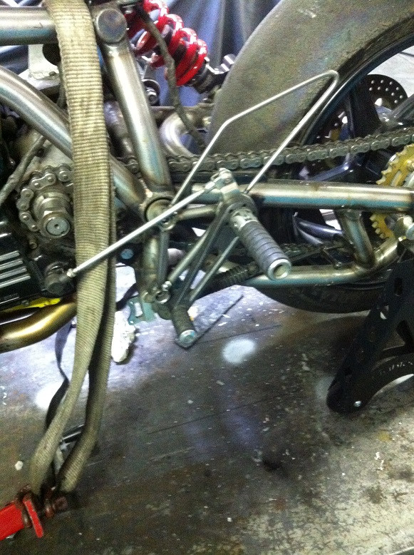

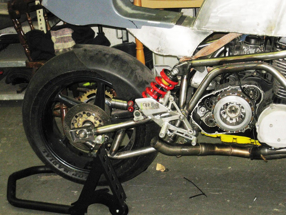

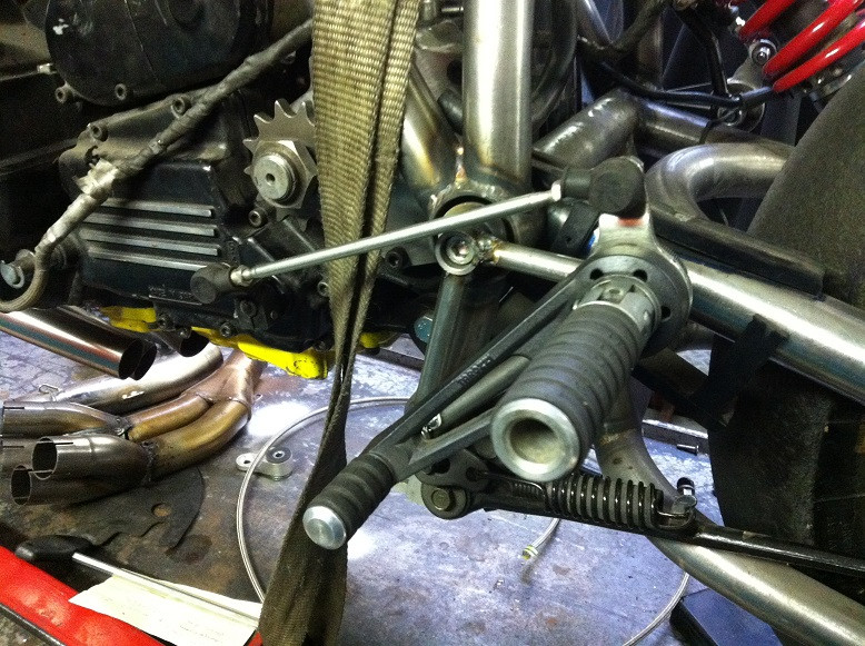

                          I bought some Tarozzi footrests that look a bit period and with some pieces of round steel and some machining I was able to make something to my taste.
                          This is the left side:
                          I did add a small gauge safety guard to stay clear of the chain
                          The right side was a bit more difficult because of the rear brake pump... a Brembo unit for a KTM with integrated master cylinder. I had to tilt it sideways to get the lever working properly..

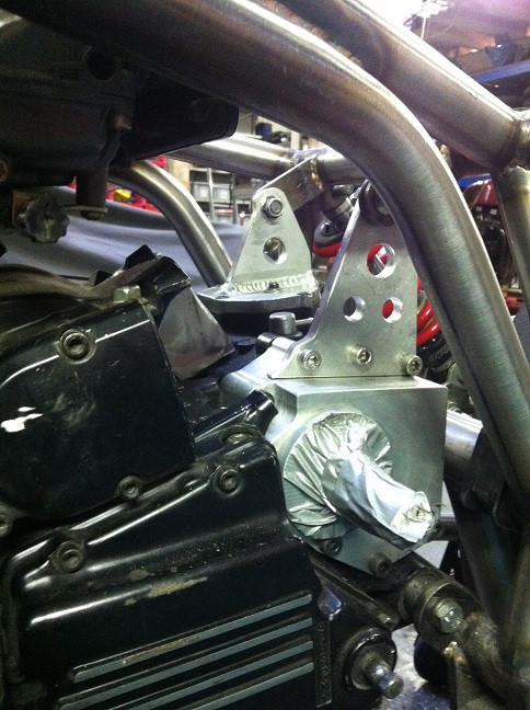

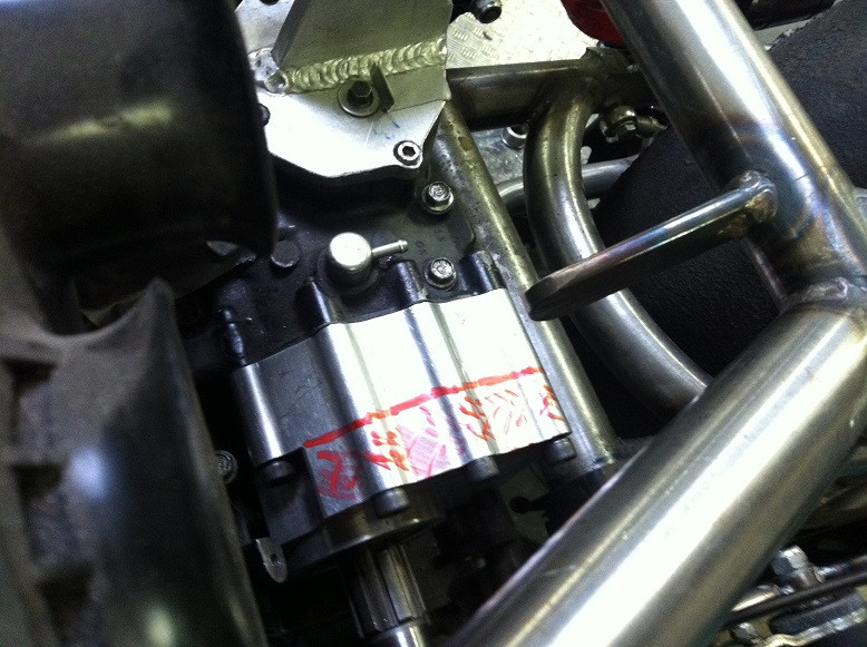

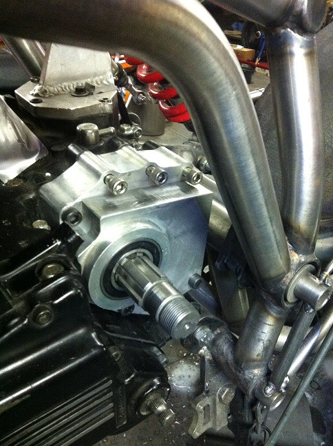

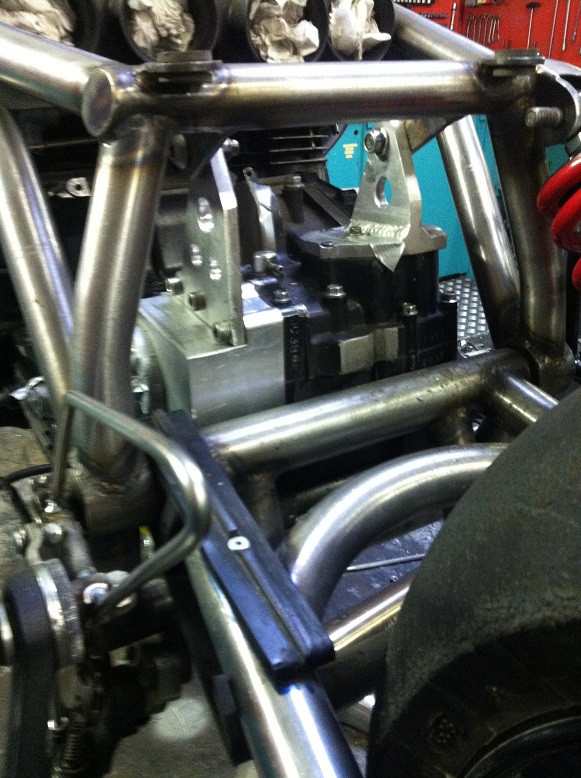

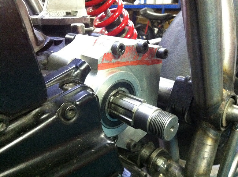

                            I also made the 6th engine mounting point. As you know I used the lower rear and the upper front ones in combination with a tube. That tube had the same size as the frame and was bolted in place of the rubber engine mounts. Eventually the tubes were bolted to the frame to become one rigid combo. The 5th engine mount came in the same spot as the breather cover on top of the engine.
                            And this was the solution for the 6th one (as I need 6 in total).
                            Click image for larger version  Name:	20171114fa.jpg Views:	25 Size:	181.5 KB ID:	876714
                            Click image for larger version  Name:	20171114da.jpg Views:	25 Size:	153.1 KB ID:	876715
                            After a bit of milling ...
                            Click image for larger version  Name:	20171115ba.jpg Views:	25 Size:	137.1 KB ID:	876716
                            And finally..
                            Click image for larger version  Name:	20171121aa.jpg Views:	25 Size:	178.9 KB ID:	876717
                            Click image for larger version  Name:	20171121ba.jpg Views:	25 Size:	132.9 KB ID:	876718

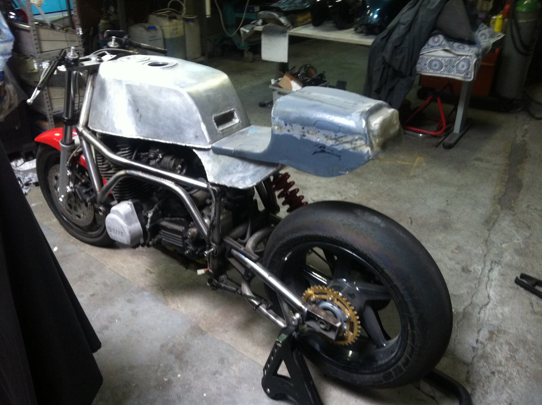

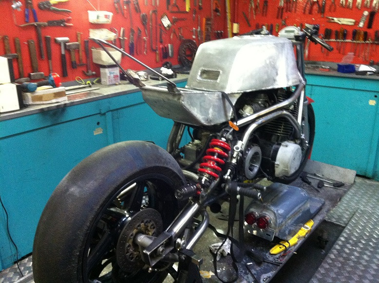

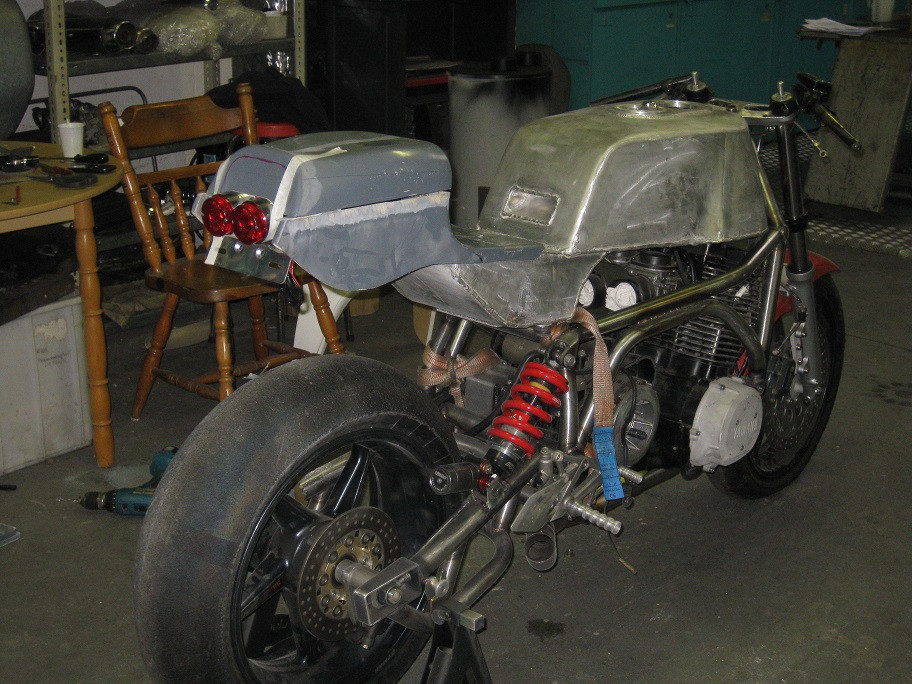

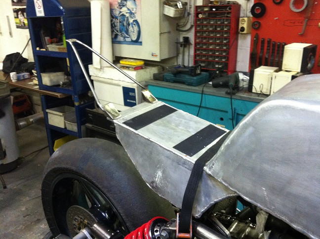

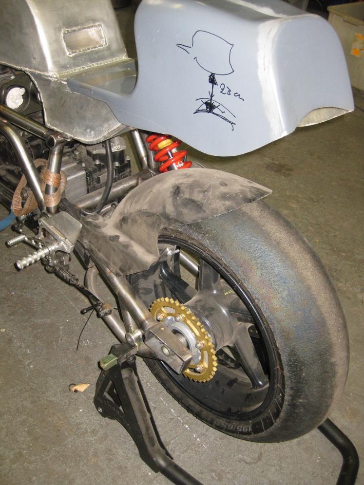

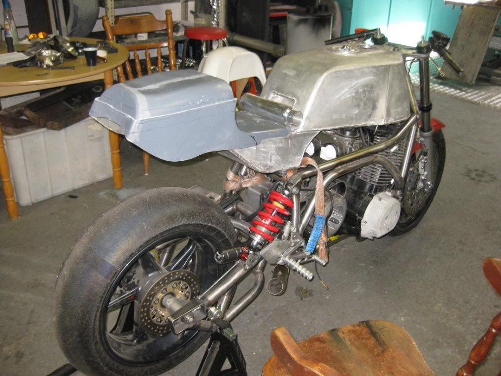

                              I decided to lower the seat hump to get it more in line with the fuel tank, this is before the change:
                              Click image for larger version  Name:	20140619ca.jpg Views:	0 Size:	112.8 KB ID:	876720
                              Cutting it up was the easy part ... looking better already:
                              Click image for larger version  Name:	20140707ca.jpg Views:	0 Size:	113.7 KB ID:	876722
                              Then the healing process,fixed everything in place and added fibre glass, mostly on the inside.. That definitely looks way better..
                              Click image for larger version  Name:	20140708ba.jpg Views:	0 Size:	217.3 KB ID:	876724
                              Added a mounting point to get the rear lights in the right angle..
                              Click image for larger version  Name:	20170418c.jpg Views:	0 Size:	220.1 KB ID:	876721

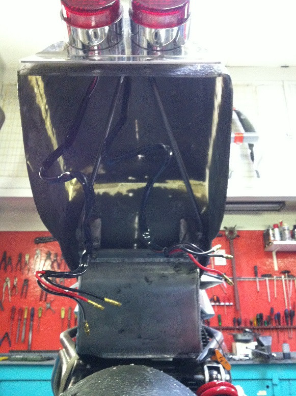

                                I fixed the rear lights to the seat and need a support for it, although it is not that heavy.. better be safe than sorry.
                                Click image for larger version  Name:	20171031oa.jpg Views:	25 Size:	135.0 KB ID:	876727
                                Click image for larger version  Name:	20171031ka.jpg Views:	24 Size:	206.3 KB ID:	876728
                                Click image for larger version  Name:	20171031na.jpg Views:	24 Size:	161.7 KB ID:	876729
                                First I wanted to close the bottom of the seat but I decided to make everything as light as possible, just like the rest of the bike.
                                Click image for larger version  Name:	20171031la.jpg Views:	24 Size:	170.2 KB ID:	876730

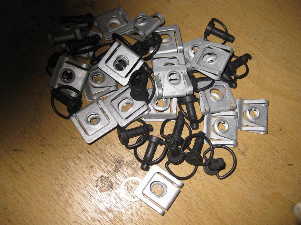

                                To keep everything in place I use DZUS quick release fasteners all over the bike. The seat gets one on top where the support sits and later another two halfway the seat fixed to the lower fuel tank.
                                Very handy.
                                Click image for larger version  Name:	20140619ia.jpg Views:	24 Size:	116.2 KB ID:	876731
