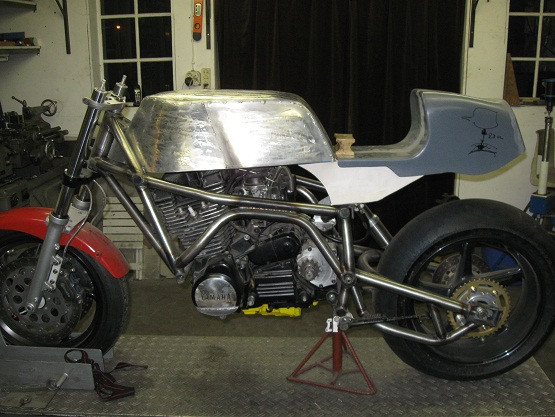

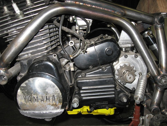

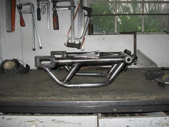

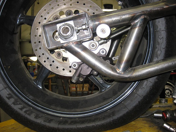

                          changed the long chain adjuster with a shorter and square one, works better, also a new bottom shock mount is now in place..
                          Click image for larger version  Name:	20091228h.jpg Views:	3 Size:	88.6 KB ID:	876629
                          back in the frame, added some bobbins to the swingarm at the front of the adjusters (barely visible in the picture below..see the allycoloured circle)
                          Click image for larger version  Name:	fototoestel 11-11-2012 092a.jpg Views:	0 Size:	118.4 KB ID:	876593
                          we're discussing the new tank but engine mount and ignition cover have been welded in the meantime
                          Click image for larger version  Name:	20091228g.jpg Views:	0 Size:	106.8 KB ID:	876609

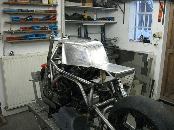

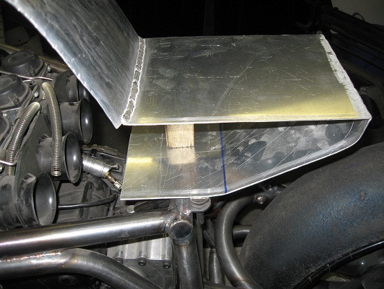

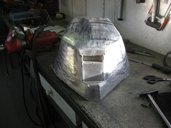

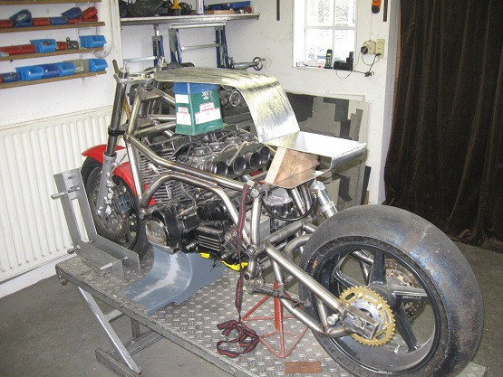

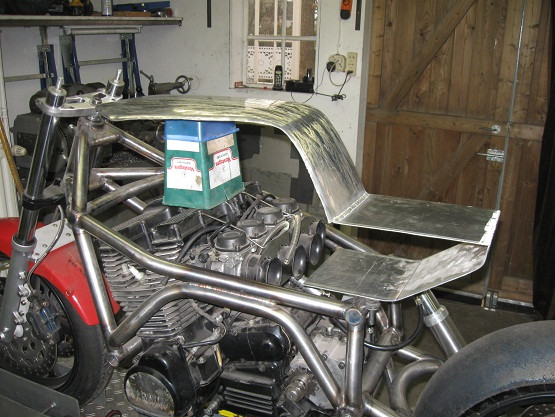

                            Today first metalwork started. 2mm thick aluminum. The lower piece will be part of the fueltank as well. Should look a bit like sidecovers. I skipped the idea of a monocoque fuel tank / seat combo. Seat will be bolted on top of the lower part of the fuel tank. That way I can change the looks more easily, just bolt on a different style of seat.. and make sure it will be stable enough to hold my weight..
                            and already one of the sides added...
                            last side part added for the day ..

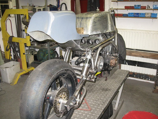

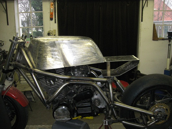

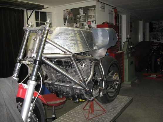

                              Still going strong ... bit more welds sides and bottom plate pulled more straight so they look more like the kawasaki tank..
                              Click image for larger version  Name:	aaa6.jpg Views:	0 Size:	94.5 KB ID:	876601
                              Tank off to add the "grabbing hole" on the front. There will be another one at the back as well..
                              Click image for larger version  Name:	aaa7.jpg Views:	0 Size:	76.7 KB ID:	876602
                              Inside and nose piece of the bottom..
                              Click image for larger version  Name:	aaa7-1.jpg Views:	0 Size:	69.3 KB ID:	876603
                              piece of cardboard to get to the final form...
                              Click image for larger version  Name:	aaa8.jpg Views:	1 Size:	97.8 KB ID:	876604
                              And the seat added .. Starting to look really good..
                              Click image for larger version  Name:	aaa9.jpg Views:	1 Size:	89.7 KB ID:	876605

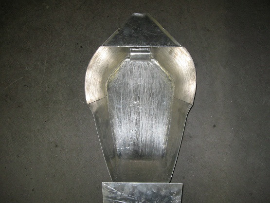

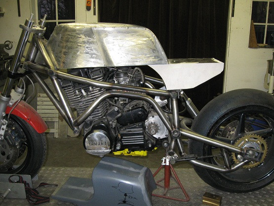

                                Pictures are for trying the sides of the lower tank portion.. and of course the radius for behind the carbs ..
                                Click image for larger version  Name:	20120118f.jpg Views:	2 Size:	89.7 KB ID:	876662
                                Next:

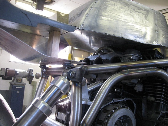

                                As Q and his Solidworks are no longer available I made up a drawing from the bottom of the tank, just to visualise things better.. excuse the dutch language...
                                Seat is still tilted backwards, that must still change. Top of tank and seat must be in one line..
                                Here a view from below. Bottom of the upper tank installed, not yet opened up. Small tunnel (invisible now) for middle of valve cover and throttle cable ..
