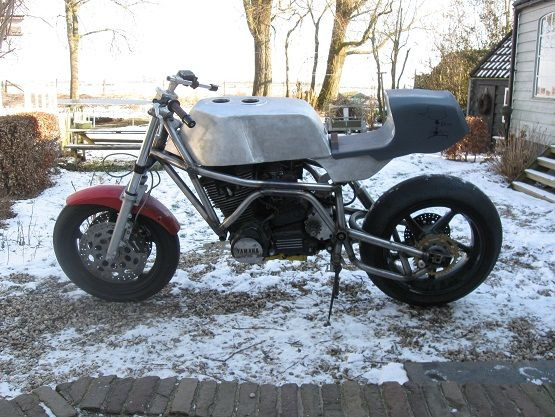

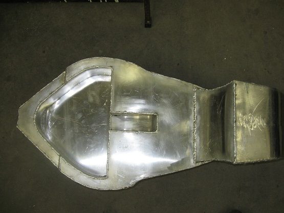

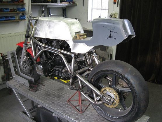

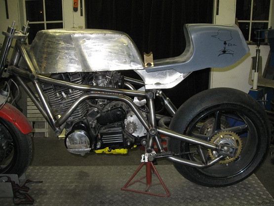

          A vertical plate has been welded in the lower tank to make it a bit sturdier to hold my weight ... :grin:
          Click image for larger version  Name:	aaa14.jpg Views:	2 Size:	92.3 KB ID:	876504
          Bike is a bit high on the end as it has a stand under it because of a flat rear tire..
          Another insert at the back for lifting it of the bike has been added..

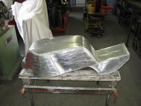

          Click image for larger version  Name:	20120125.jpg Views:	0 Size:	77.7 KB ID:	876653
          And finished the inside. The larger opening is for placing the electrics, the smaller one for the throttle cable and camchain tunnel...
          Click image for larger version  Name:	20120124d.jpg Views:	0 Size:	49.9 KB ID:	876652
          And the outside welds finished ..
          Click image for larger version  Name:	20120124c.jpg Views:	0 Size:	68.2 KB ID:	876656

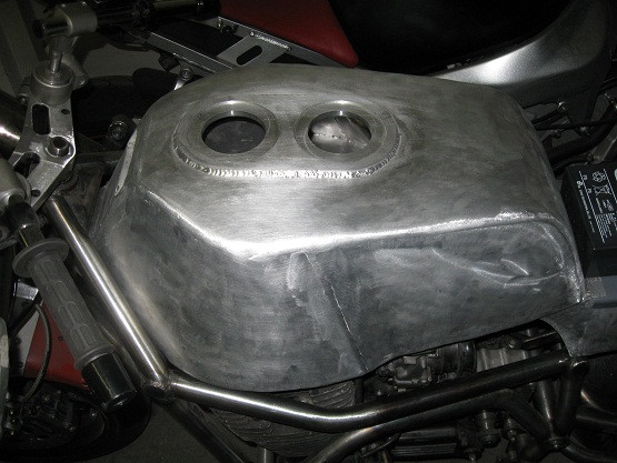

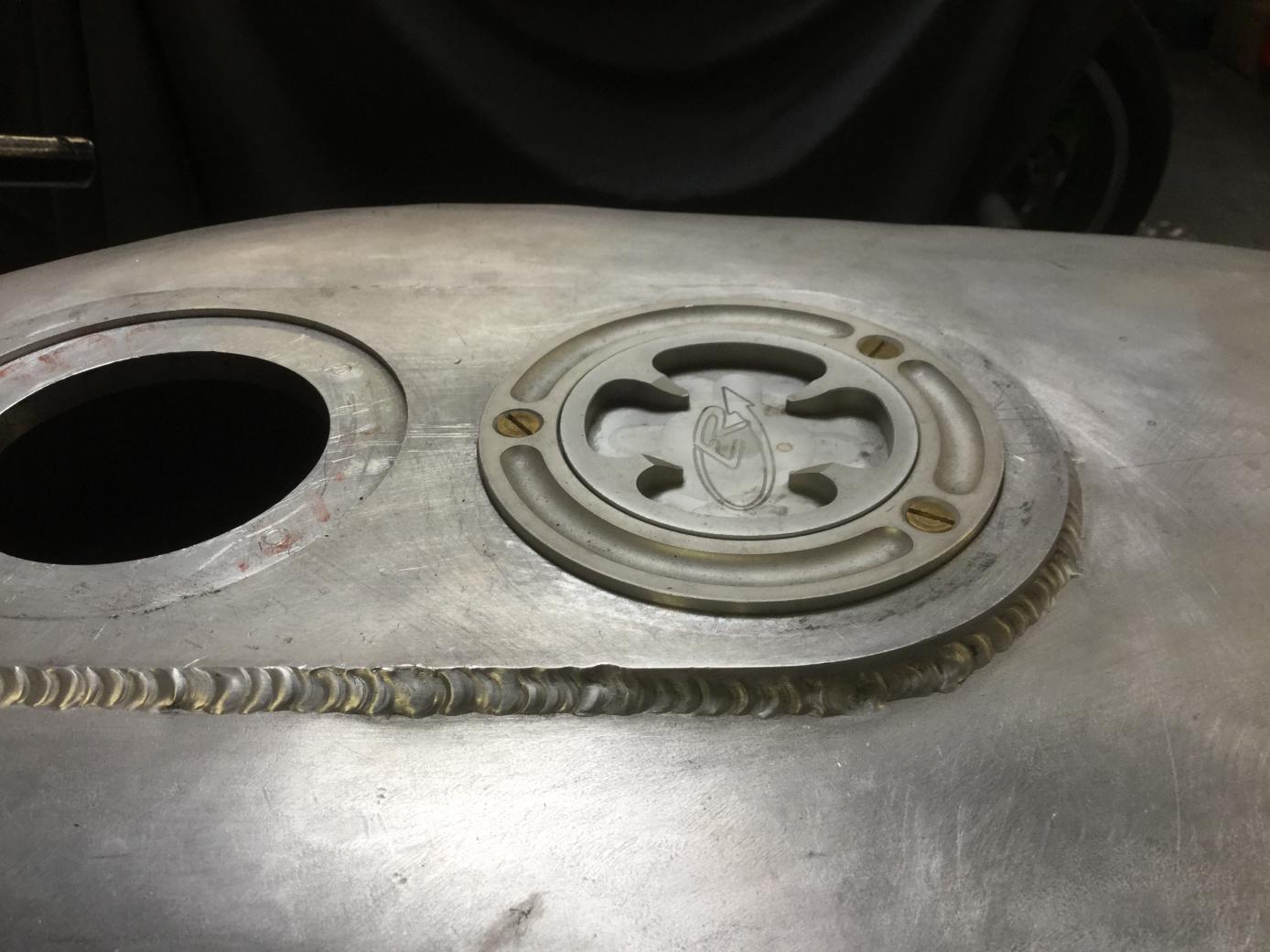

          Finally, the plate with the fuel filler openings is added ...
          Click image for larger version  Name:	20120125b.jpg Views:	0 Size:	74.9 KB ID:	876655

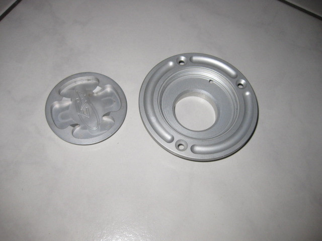

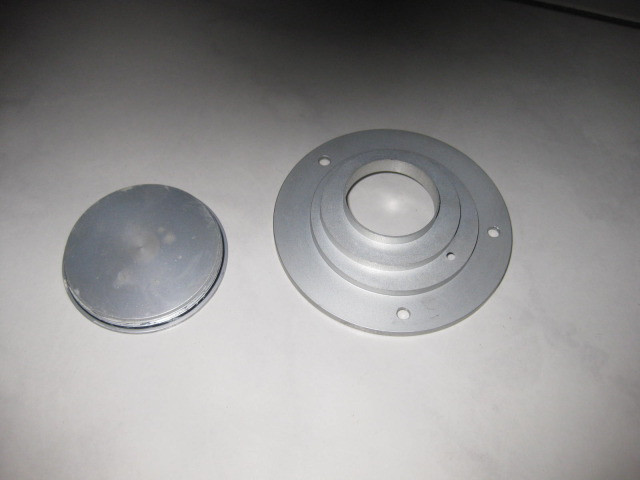

            one of the fuel filler caps:
            Click image for larger version  Name:	20120125c.jpg Views:	15 Size:	49.5 KB ID:	876657
            Click image for larger version  Name:	20120125d.jpg Views:	14 Size:	44.3 KB ID:	876660
            and where it belongs ..
            Click image for larger version  Name:	IMG_3095.JPG Views:	0 Size:	135.6 KB ID:	876223

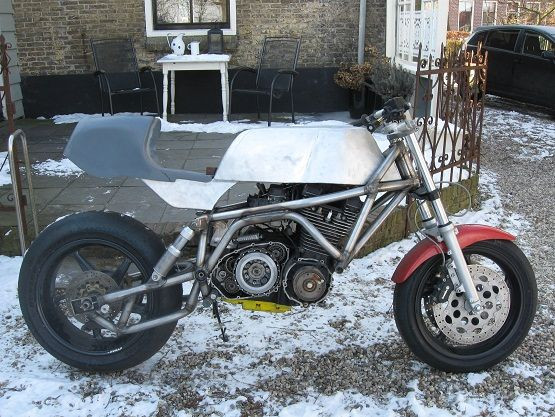

            I got these two outside pictures:
            Click image for larger version  Name:	20120210.jpg Views:	14 Size:	116.4 KB ID:	876658
            Click image for larger version  Name:	20120210a.jpg Views:	14 Size:	108.8 KB ID:	876659
            The bike looks great!

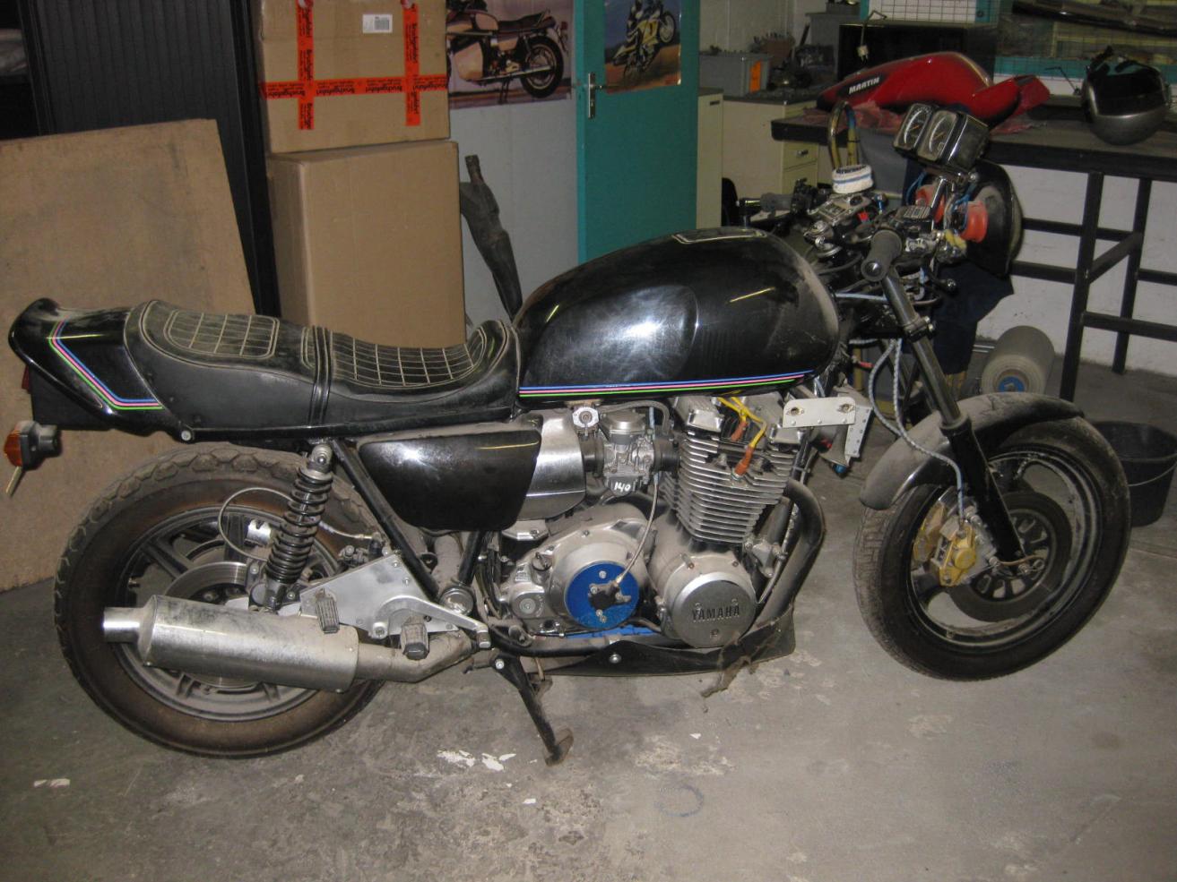

                      At the moment I am still busy rebuilding the engine from a Moto Martin framed Cbx1000 for a client but it's nearing completion, so with any luck I can start again soon with my racer... still standing there.
                      This week I picked up a complete xs and several boxes full of parts, I all got for free. It even contains a NOS 2H9 wiring harness and black box.... The bike had been standing for 20+ years and belongs to a friend of mine I hadn't seen for that same amount of time. We did a lot of riding together then. He now has a midlifecrisis and bought himself a HARLEY ....... so decided to get rid of the XS because of storing issues ..

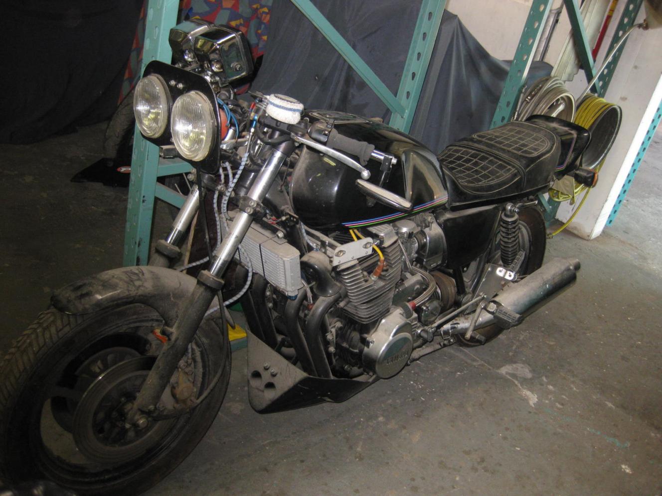

                      The engine has been massaged in the 80's by JSPP in Holland. It has Crane cams, 1mm bigger inlet valves, head saw some flowing work, and it has a big bore kit (don't know how big ...) so it could be a great engine for the racer but it looks a bit tired and I have no clue if the engine turns ( anyway tires were flat, that's for sure...). But who cares
                      Here are some pics of my new treasures...:
                      Click image for larger version  Name:	IMG_2130.jpg Views:	0 Size:	153.4 KB ID:	876270
                      Click image for larger version  Name:	IMG_2129.jpg Views:	0 Size:	156.6 KB ID:	876271
                      Click image for larger version  Name:	IMG_2132.jpg Views:	0 Size:	160.2 KB ID:	876272
                      the bike: 80's styling ... early brembo's ... dyna ... 18"pvm .. big oilcooler ..
                      Click image for larger version  Name:	alles van toestel 893.jpg Views:	0 Size:	159.8 KB ID:	876273
                      Click image for larger version  Name:	alles van toestel 894.jpg Views:	0 Size:	175.1 KB ID:	876274

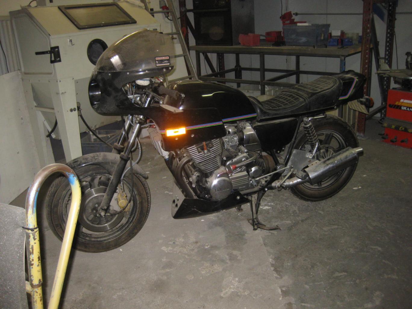

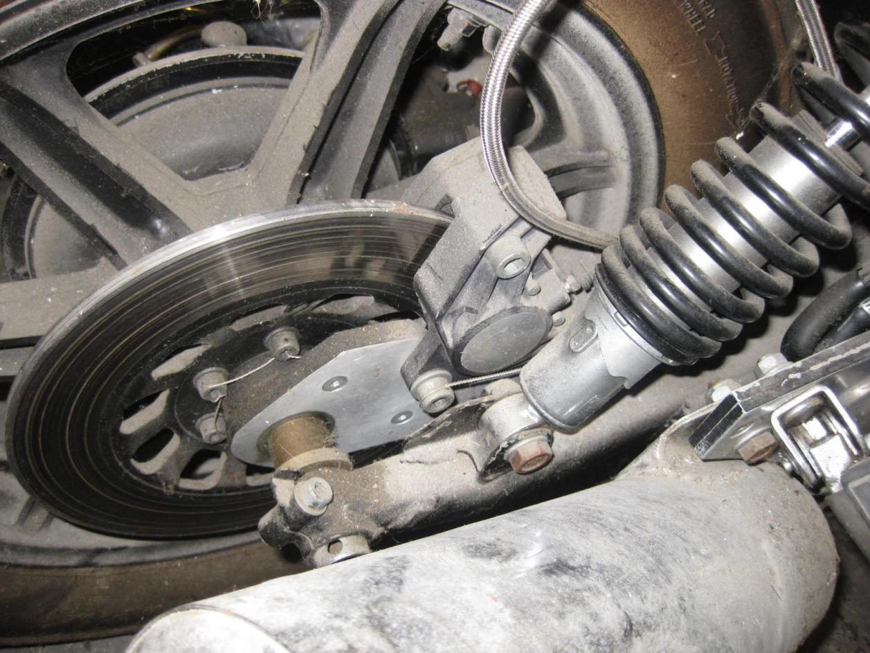

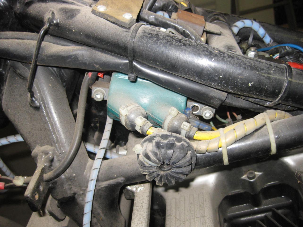

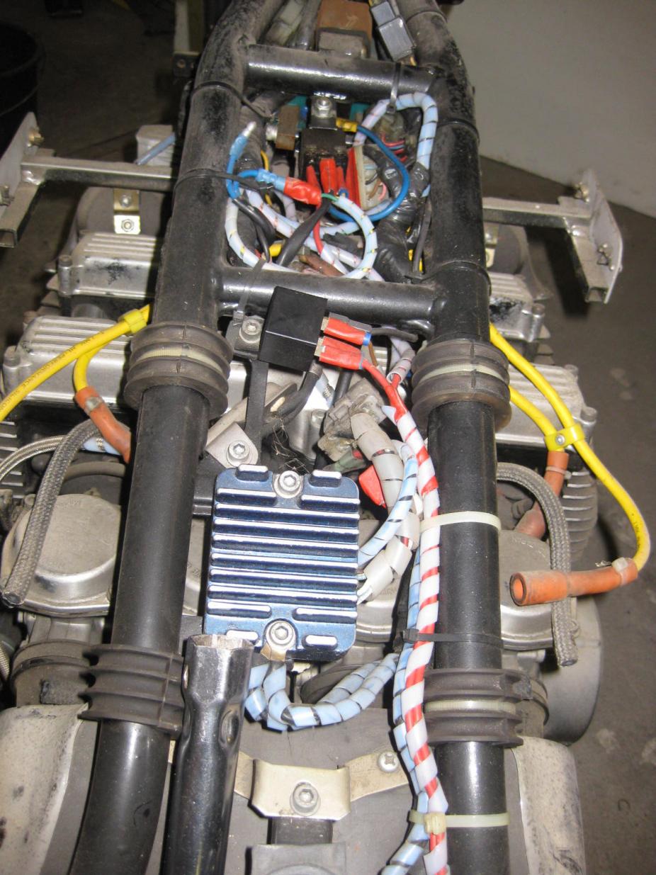

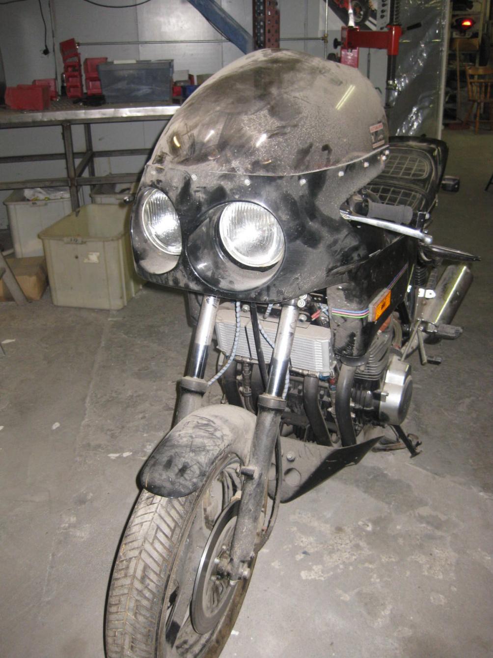

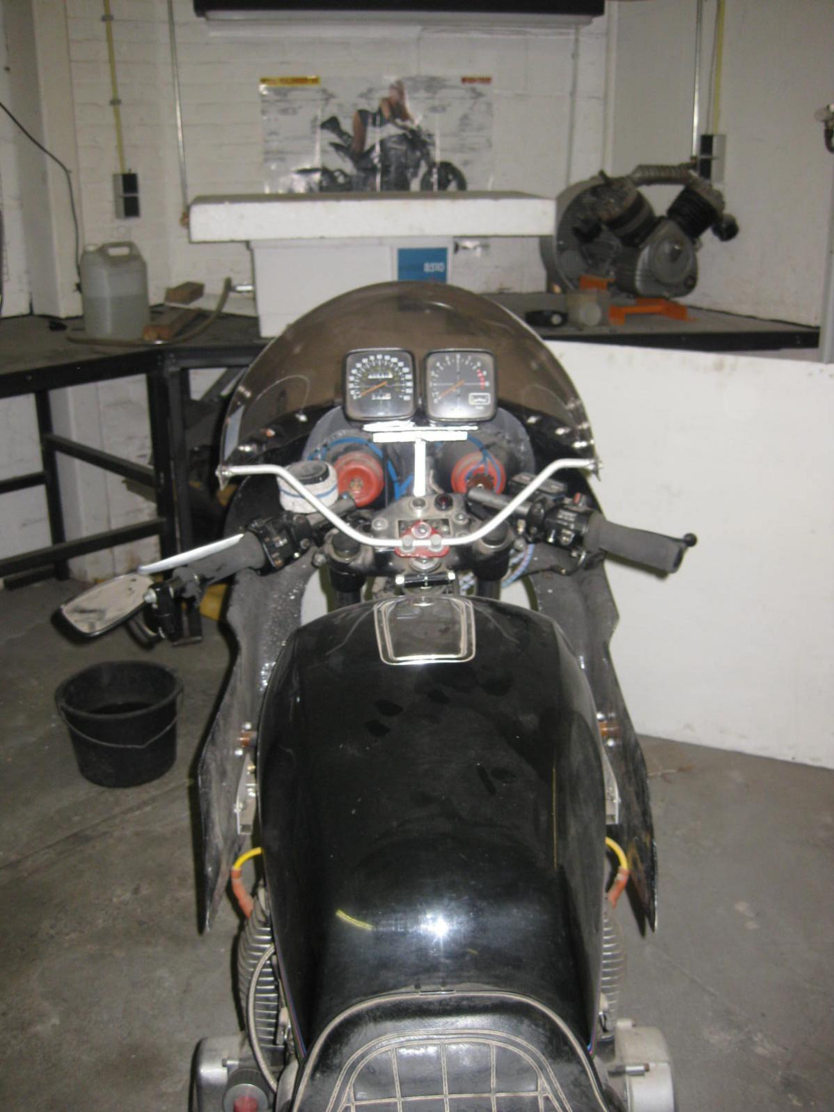

                          Everything looks ok although it needs lots of work ...
                          Click image for larger version  Name:	alles van toestel 886.jpg Views:	0 Size:	160.7 KB ID:	876278
                          Click image for larger version  Name:	IMG_2136.jpg Views:	0 Size:	167.6 KB ID:	876277
                          Click image for larger version  Name:	IMG_2137.jpg Views:	0 Size:	162.9 KB ID:	876275
                          took the covers, tank and seat off, checked if the pickup plate moved freely
                          Click image for larger version  Name:	alles van toestel 933.jpg Views:	0 Size:	172.9 KB ID:	876276
                          Pulled out the plugs, no rust on the cylinder walls ... squirted some oil on the pistons, turned the crank by hand... turns extremely easy, almost no sound. Used a starter aid... turns like a new one .. starts to look really good now. Maybe there's some life left in the electrics, now I know why there was that NOS wiring harness
                          even the fuel tank is still full
