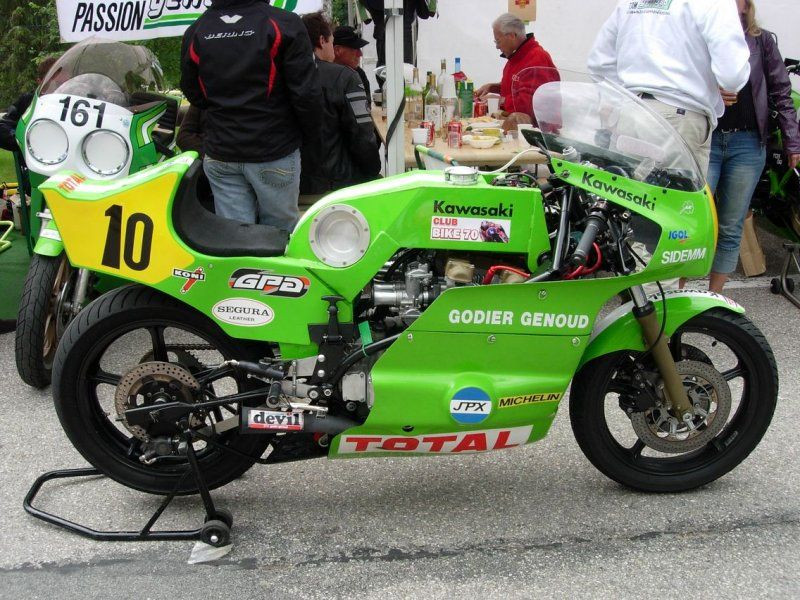

    What will it look like? Well it will be a mix of a 70's Godier Genoud Kawasaki endurance racer and a 80's Motoplast frame (Kwacker, Laverda). I love these racers as I have been visiting these endurance races in those days when it was still possible to walk through the pits. Lots of ingenious technical solutions coupled with gorgeous styling and big horsepower in comfotable frames. As Yamaha was not exactly overly busy in these days it will be a bike that Yamaha should have built (in my humble opinion). Still had that spare ex-turbo engine lying around so that worked out well.
    For the people who don't know the above mentioned bikes: this is a GG kwacker from the 70's:

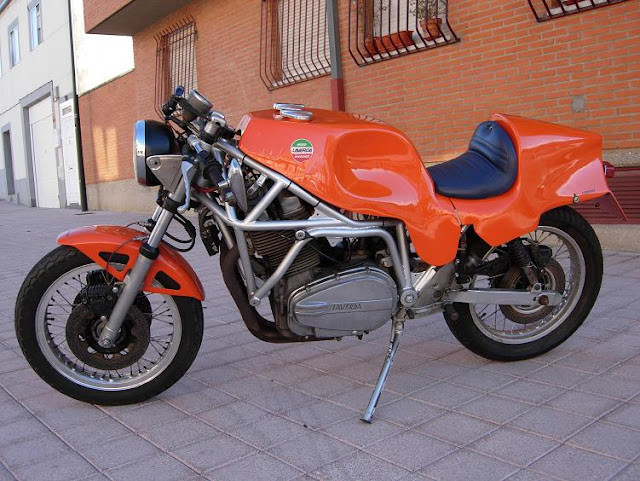

    This is a Motoplast Laverda:
    This is a GG frame (seat and tank are monocoque):
    Click image for larger version  Name:	endurance-75-4p.jpg Views:	2 Size:	37.0 KB ID:	876210
    This is a Motoplast frame:
    Click image for larger version  Name:	DSCN0627.jpg Views:	2 Size:	126.2 KB ID:	876211
    Frametubes will be thicker though as I think they look tiny. They worked well however in those days. No tubing under the engine. I will definitely go for the monocoque construction, keeping the frame low and short. Looks nice and tidy. It will also get a one off swingarm: I am thinking of a GG lookalike but with a side mounted monoshock although it will be difficult to connect it to the back of the frame

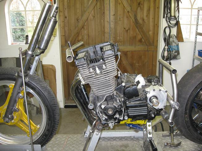

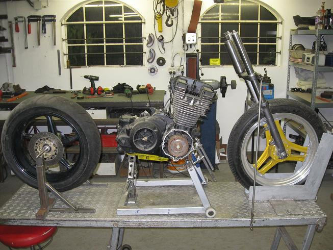

    ready for transport. Scruffy ex-turbo engine with shiny chaindrive:
    first picture of the mockup...

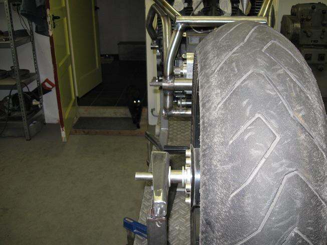

    Frame will be 31cm wide where the swingarm mounts, so a 200mm wide rear tire is a possibility.
    Kickstarter is a must, so still waiting for an answer if the frame is not too wide at the right side..
    november 25th 2009
    Well, frame was too wide. So cut up and made new, it is now 29cm wide. Still possible to use a 200mm tire if necessary in the future.

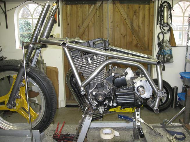

    november 28th 2009
    The project goes on and on. Despite the distance it's all going well and we're still having a laugh

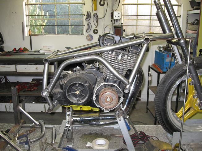

    Now then, these went in fine and look good. I wanted to lower the front tubes to horizontal but he needed the space available for his welds.
    After the last picture I started worrying about the tubes that are going to pass between the downpipes. Our gimmick expert (we call him "Q") made a drawing to explain:
    Click image for larger version  Name:	endu20.jpg Views:	0 Size:	139.4 KB ID:	876212
    The GG frame has them running between the downpipes.
    Turns out that with the RC exhaust these frame tubes need a bend. When I built an exhaust myself the frame tubes can be straight. I think I want them straight but then I need to make an exhaust...
    mmmm... lots of extra work..

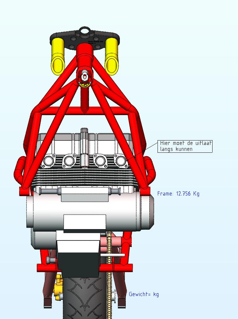

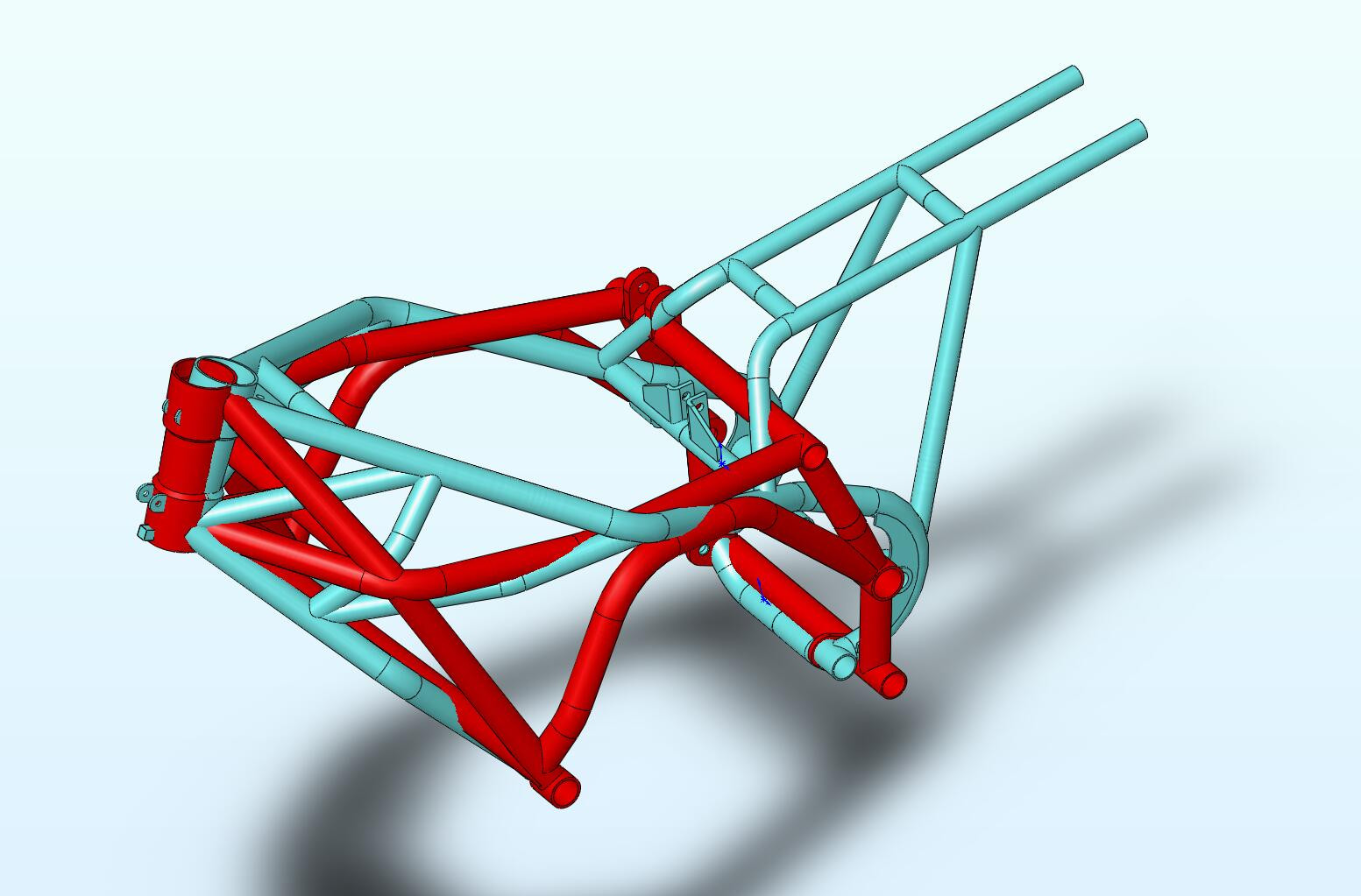

    In the mean time Q came up with a comparison between my effort and his own Moto Martin frame (Q owns a Moto Martin GPZ750). The Martin frame looks not as stiff as our effort, especially behind the cylinder head. Our frame has 2 triangles at that point:
    Click image for larger version  Name:	endu21.jpg Views:	0 Size:	198.5 KB ID:	876213
    I remember the XS1100 Moto Martin has 2 extra frame members below the engine running from front to rear.

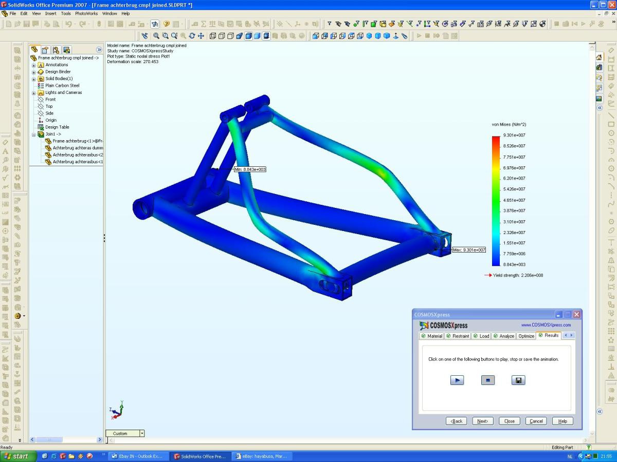

    I asked Q if he could produce a drawing which shows the difference in stress between the two frames. He'll give it a try at work and this is a pic he did for his own swingarm:
    Click image for larger version  Name:	endu22.jpg Views:	0 Size:	195.5 KB ID:	876214
    This is a pic from late this afternoon: one pipe with three bends. Now he's making another one for the other side that has exactly the same bends:
    Click image for larger version  Name:	endu23.jpg Views:	0 Size:	125.3 KB ID:	876215

    matters were urgent as the two front downpipes interfere a little with the 2 outer exhaust pipes. He asked if he could cut up the exhaust to make room for 2 straight tubes: NOOOOO
    So the exhaust will come off to make room for 2 straight tubes. More work for me...

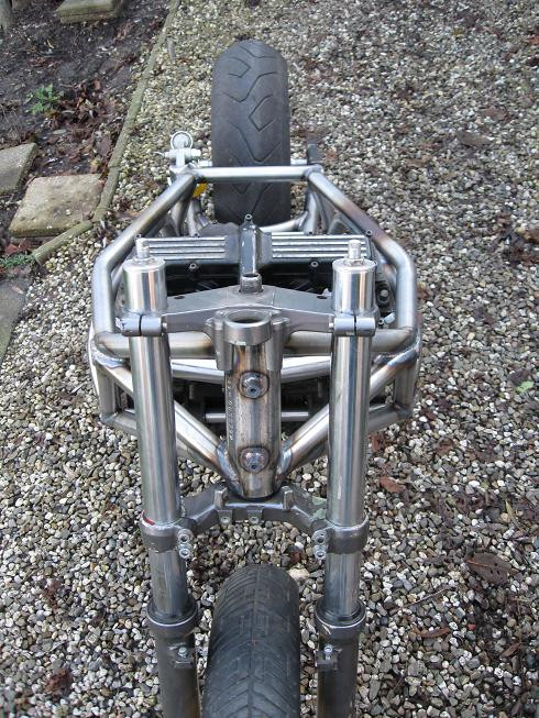

    Added both tubes from the top of the headstock:
    Another pic from the rear:
    Then we had a big duscussion about strengtening the rear of the steering head. He wanted extra gusseting at the bottom and at the top. We already decided about one tube running from the bottom of the steering head to the V-shaped pipe:

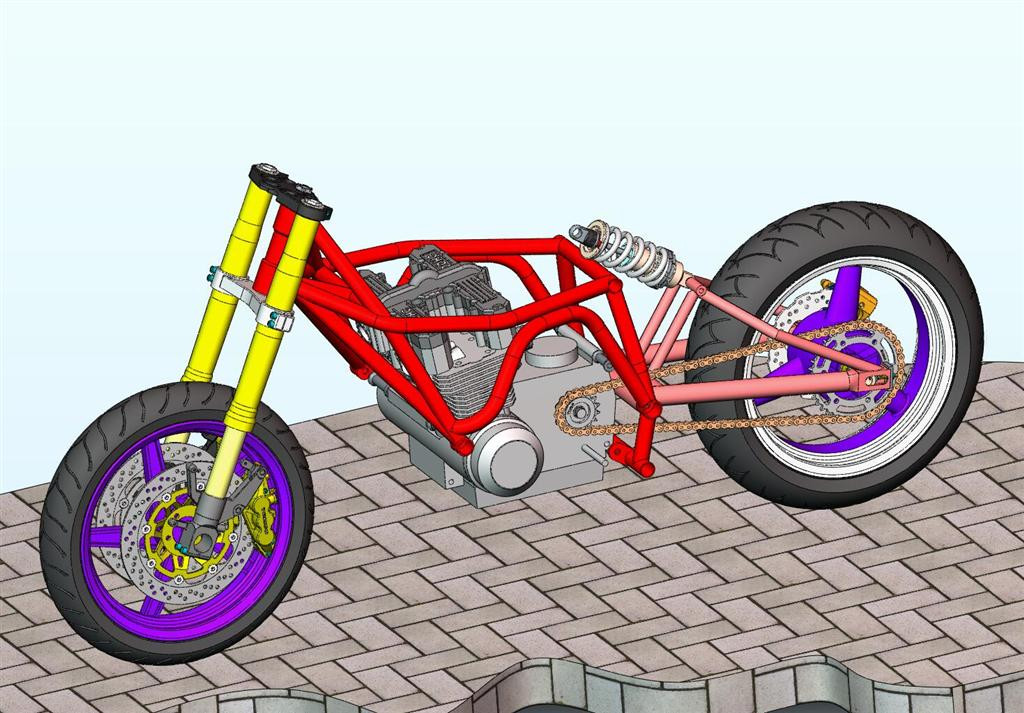

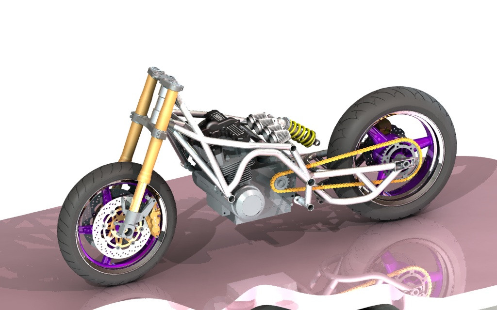

    3D sketch from the end result (in chrome!):
    for extra strenght i suggested this solution he did earlier on a frame fot a V-Twin:

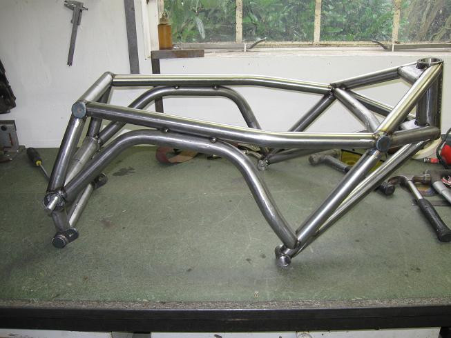

      december 6th 2009

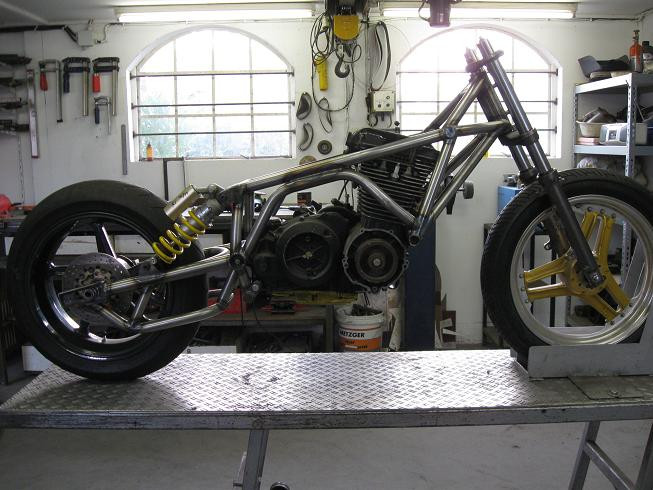

      Here it is, ready for final welding ...
      Click image for larger version  Name:	20091203a.jpg Views:	56 Size:	83.4 KB ID:	876343
      Then it went into the jig:
      Click image for larger version  Name:	endu44.jpg Views:	0 Size:	97.9 KB ID:	876216

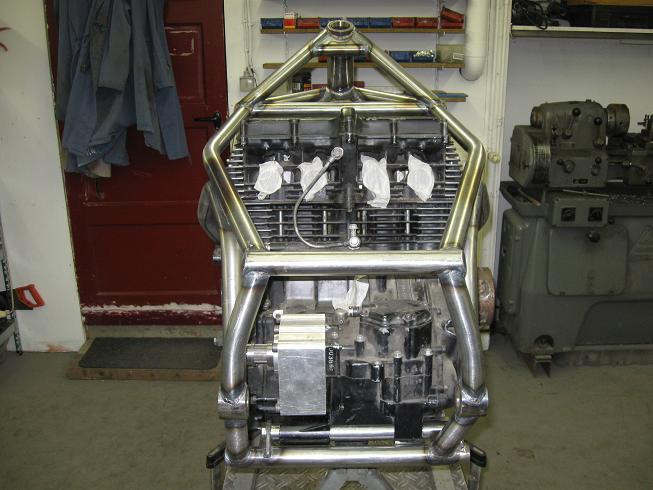

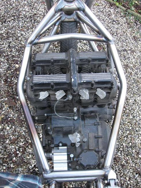

      and after three hours of adding heat and metal, voila:
      Click image for larger version  Name:	endu45.jpg Views:	0 Size:	104.0 KB ID:	876218
      And here after adding the engine. It fits like a glove, no distortion from the welding at all.
      Click image for larger version  Name:	endu47.jpg Views:	0 Size:	109.0 KB ID:	876219
      Click image for larger version  Name:	endu48.jpg Views:	0 Size:	83.7 KB ID:	876220
      In the meantime we've had several discussions about wheelbase, trail, rake and so on. We then set up for a 1520mm wheelbase. That is still 25mm shorter than the standard XS.
      As an example you can find some reference measurements from some more modern bikes.
      As the fork is a 41mm pre Exup one, offset is 35mm and expected trail will be around 95mm.
      Then I changed wheelbase to 1500mm, because i am a bit scared the bike will get a bit too heavy on the front.
      So, at this moment with a wheelbase of 1500mm , swingarm will be 455mm long (420mm standard) and i am awaiting some expert's comments...

                          Very difficult if people don't listen. This is Q's first set up based on his own swingarm:
                          Click image for larger version  Name:	endu12.jpg Views:	9 Size:	213.2 KB ID:	876319
                          First mentioned was this swingarm, mostly made for streetfighters
                          Click image for larger version  Name:	endu72.jpg Views:	9 Size:	71.1 KB ID:	876320
                          Looks way too modern for me.... So we need a different style. Like the GG racer .. tube swingarm with a lower brace.
                          Click image for larger version  Name:	endu54.jpg Views:	0 Size:	143.3 KB ID:	876333
                          Pic below shows that the swingarm has to go inward from back to front, or there will be a large gap between the arm and the tire...
                          Click image for larger version  Name:	20091209a.jpg Views:	0 Size:	81.5 KB ID:	876332
                          Then I decided to use a 38mm tube for the swingarm and a 32mm tube for the lower brace. This is the first result. .
                          Pic shows we moved the rear axle to the middle of the adjuster getting a final wheelbase of 1500mm. In this case I can vary the wheelbase from 1460mm to 1540mm (if necessary). Second pic shows nice gap between swingarm and rear tire, still plenty of room for a 200 tire though:
                          Click image for larger version  Name:	20091209c.jpg Views:	0 Size:	81.6 KB ID:	876334
                          First attempt at the lower brace, way too deep...

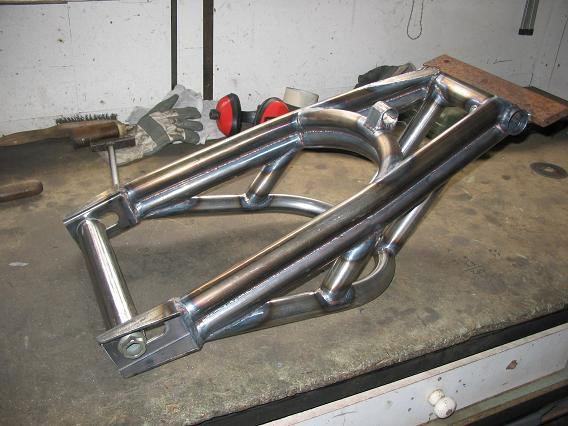

                              Q finally picked up the pace, chromed everything and even managed to polish the front rim :
                              Click image for larger version  Name:	endu71.jpg Views:	52 Size:	136.7 KB ID:	876347
                              According to him the swingarm will weigh 6.0 kilos, the real thing weighs 5.5 kilos (I think Q's swingarm has the bearings installed):
                              And back in its place again:
                              Click image for larger version  Name:	20091211c.jpg Views:	51 Size:	98.2 KB ID:	876349
