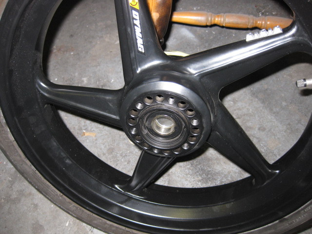

      I just found a matching magnesium Dymag front wheel in France. It is on its way now. It is originally for a Ducati so lots of different front discs will fit. Next week i will visit someone who presumably has the correct cushdrive for the rear wheel, if not I have to make one myself. Tomorrow i will take out the forks and take them to a Bitubo specialist to update it a little..

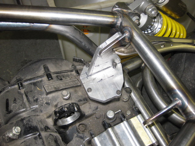

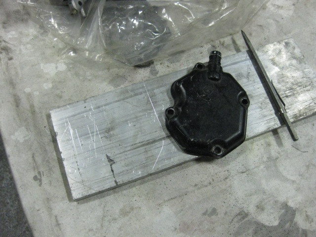

      I started with the right rear motor mount, which comes instead of the stock breather cover:
      Click image for larger version  Name:	alles 341.jpg Views:	17 Size:	97.2 KB ID:	876353
      Click image for larger version  Name:	alles 352.jpg Views:	16 Size:	92.0 KB ID:	876354
      Click image for larger version  Name:	alles 350.jpg Views:	16 Size:	112.0 KB ID:	876355
      Click image for larger version  Name:	alles 351.jpg Views:	16 Size:	101.3 KB ID:	876356
      Still have to weld those and make a hole for the breather tube, but I will do that later..

            SO if you weld that cover to the frame where you had it clamped with the vice grips... if you ever have any engine problems, how will you be able to pull the motor without cutting that? Does it just drop straight down?
            You're asking a lot from those 4 little allen screws. Under that cover is one of the 10mm bolts that connect the two case halves. One more hole in the center of that and a longer bolt would give you a little more strength there?? You could also drill it and tap it for a larger bolt to give it even more strength.
            Just a suggestion.

              Tod, I'm pretty sure he means he needs to weld the aluminum tab to the new cover, not weld the tab to the frame.
                Yeah, Aluminum don't weld up to steel that well.
                But Tods right about those teeny bolts being used for a motor mount.

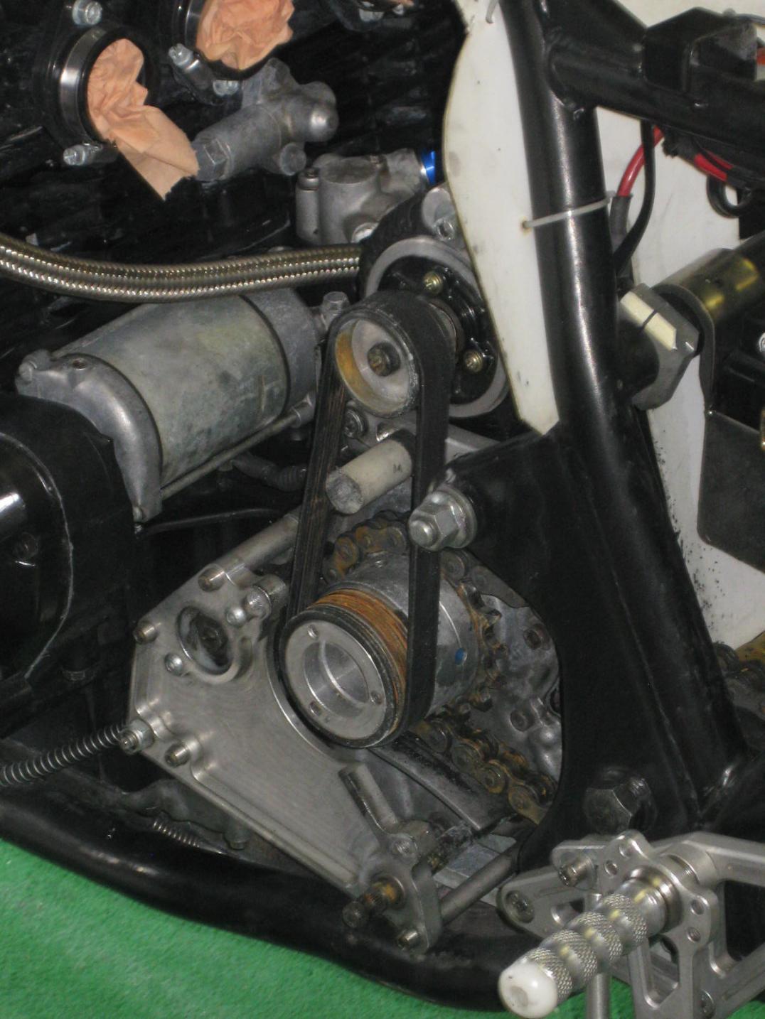

                  Also.. the alternator/generator in the pics. What's your plans on that? How do you intend to run a pulley?
                  Assuming an endurance racer will be wanting all kinds of light that the struggling stock alternator can't handle.

                      yes, with the welding I referred to the aluminum plate..
                      Tod
                      I am not afraid of those 4 little screws. Honda for instance bolts their stock Fireblade rotors with 6 of those tiny M6 screws. The forces on those poor discs while braking are way bigger.
                      But your remark about the bigger 10mm is excellent, great, I did not see that possibility!
                      The alternator/ generator will be driven from the front sprocket just like in these pics:

                      Still thinking about pulley sizes and which alternator to use though. The bike in the pics has a 1:1 pully drive and starts charging at a speed of around 30 mph. That's great for a track bike, but I want to run mine on the street as well. Maybe one from a race car like this one, but I am waiting for a reply on max revs...

                        So you'll only be generating when the back wheel is spinning?
                        Also.. the original cap over this vent is cup shaped. It allowed gasses from the crankcase on one side and the middle drive vent to have one hose. By capping that flat like you have, you'll block off the crancase/ blowby pressure, and you'll need to either drill out a hole in the divider there under that cap, or make two different vent holes.
                        And one other thing.. those screws on a rotor are stopping lateral movement and using their tensil strength. That application is going to test the aluminum threads in an up and down pressure. Just another of my 2 cents.. lol.
                        Tod
                          Tod,
                          Look at the picture with the cap off. Do you see at the back of the breather there is a drain from one side to the other? That will take care of the liquid, and a quick bit of work with a dremmel will take some material off the bar between the two chambers for the vapor.
                          If Mathh drills the holes a little deeper, he could put in 5mm longer screws. That will hold a LOT of weight. Don't forget, he has a tab on the other side of the engine for that mount, as well as the front and bottom mounts.
                          Great built! I was thinking about pulling the right side crank cover, and putting a pully on the crank instead of the alt that Yamaha used. If you did something like that, you would charge all the time.
                            That is correct of course PLUS I can bumpstart or use the kickstart when the battery is empty if I use a normal alternator with pully drive. That is not possible with a piggy back alternator because they are designed differently. But I already used a crankdrive system on the turbocharged bike. I want this bike completely different. Also i want to shorten the crank for more ground clearance, and maybe convert the stump for use with a portable starting system. That may however come later, top priority is getting the bike running around june - july for our next international meeting in Germany...
                            Another plus with the separate alternator is the built in regulator and rectifier. That simplifies wiring a bit.
                            @Trbig: I was referring to the lateral movement and using tensil strength. As Diverray says, there are six solid engine mounts in total.
