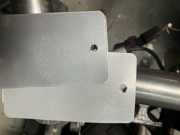

                    Here is a picture I took from a test session with different spray paints . I did almost 35 of those, luckily I got a hefty discount. They were all sprayed on square pieces of aluminum, painted white on one side, no paint on the other side. it made no difference as none of them were to my taste.
                    Click image for larger version  Name:	IMG_5117a.jpg Views:	0 Size:	118.4 KB ID:	880051
                    I also asked for the indoor ones but I got a warning to not use them outdoors and / or add clear paint over them.
                    My visit to the powder coating company also turned out to be a disappointment. I got 4 samples for chrome and nickel colors to try. Once in the workshop I saw they were not close to them but more to metallic silver / gray .. So another no go.
                    Click image for larger version  Name:	IMG_5103a.jpg Views:	0 Size:	81.0 KB ID:	880052
                    Click image for larger version  Name:	IMG_5104a.jpg Views:	0 Size:	102.3 KB ID:	880053
                    I am now still investigating the last mentioned options (sharkhide, everbrite and polishing the frame)) although I have not yet found something comparable overhere for the first 2 options.

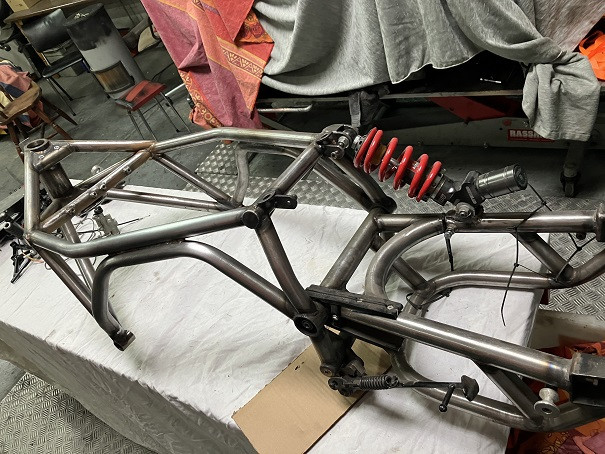

                    Now this is the last status of my racer.. (this afternoon)
                    Click image for larger version  Name:	IMG_5126[1].jpg Views:	0 Size:	127.8 KB ID:	880054
                    I am going to clean up the frame from scratches and heat colouring and will then have a try to see if I can experiment with some polishing.

                        In the mean time I brushed the frame with 800 grit so all heat colouring from the welding is gone. It looks way better now. Tomorrow a friend of mine will visit my workshop. His specialism is polishing so we'll see what is possible. I also sent a mail to my paint supplier to check if there is a clear coat that fits my project...

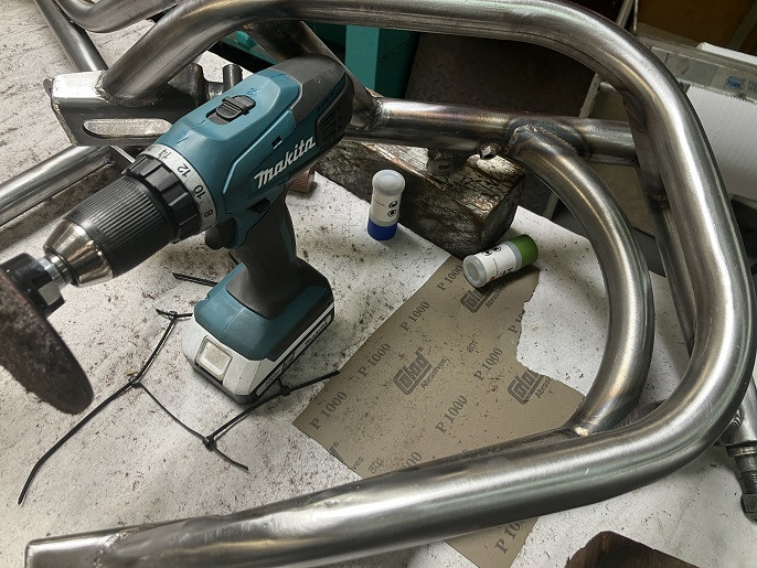

                          Here are some pictures of the frame done with 800 grit. I now started working on the swingarm as well. The polisher told me to go further than 800 grit, so I'll soon give it another go with 1500 grit. I must say that I am well pleased with the result so far.

                              As for the racer I have been busy with 1000 grit pads and with a Dremel with a tiny wire brush to clean up the welds. I also have chosen some designs for the bodywork that I think I can use for the final choice. I'll post some pics after my next visit to my workshop.
