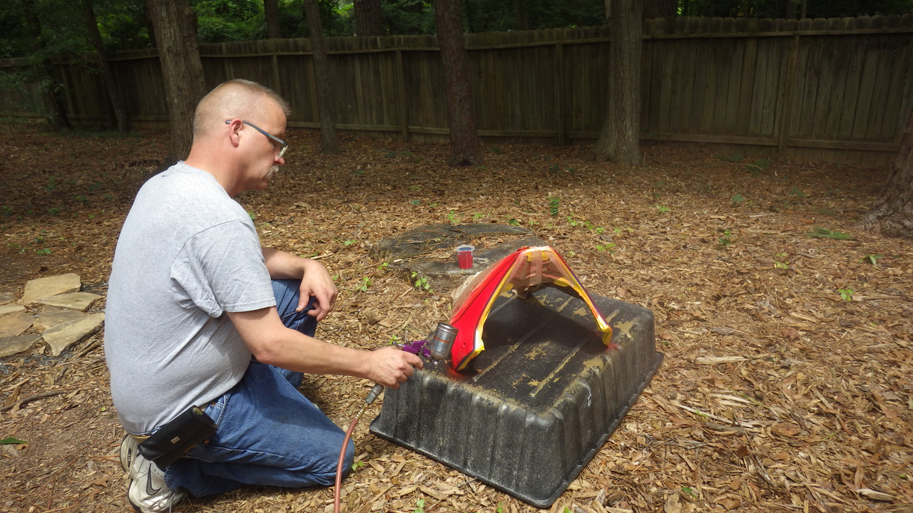

          Since I couldn't find and affordable set of decals that is correct for this machine I decided to just paint them on the lower fairing where they are missing.
          Those that have been following along know I purchased a set from Hungary but they turned out to be correct for the '85. I can use some of that set when I EVENTUALLY repaint the entire bike (probably next year) but the decals for the lower fairing were wrong.
          Actually, I'm pretty pleased. I haven't been too successful with this type of painting in the past..... Used the baby gun from Harbor Crap Freight at .04 nozzle and sprayed about 6 coats on it....
          Part is baking in the Georgia Sun.... I'm a bit too anxious to mount it (as usual). I'll get it on tonight.

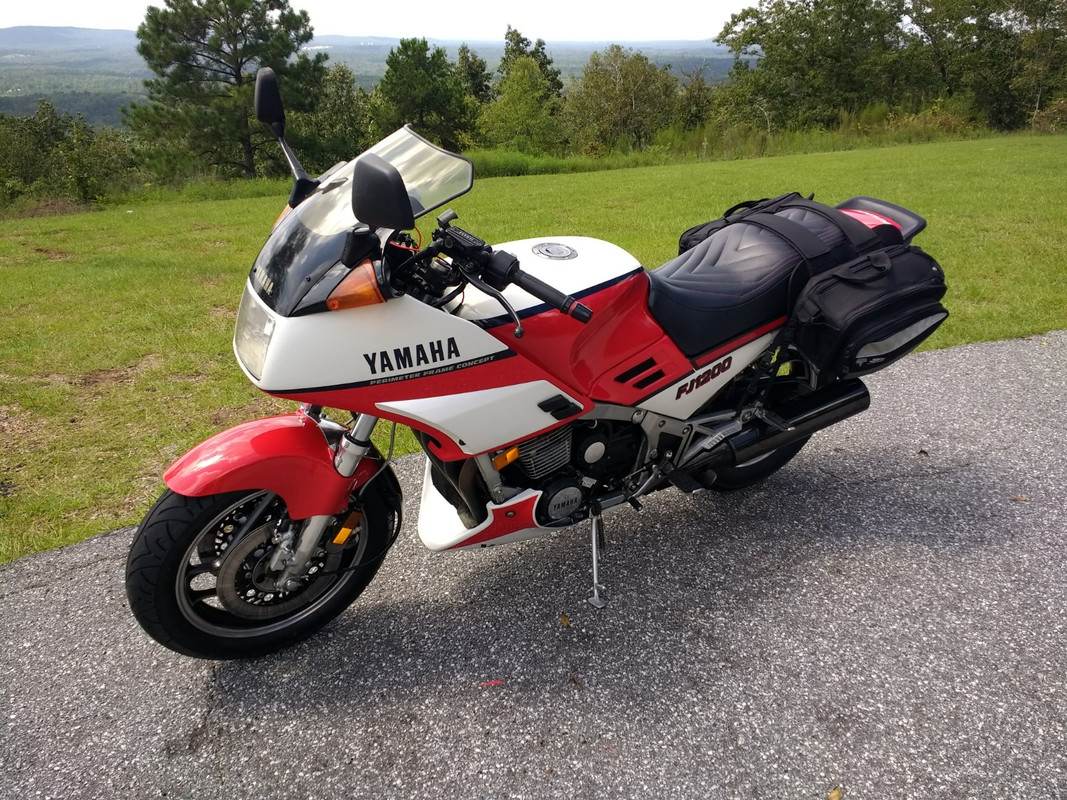

                  I believe I'm getting pretty close to done with this machine (for now). The bike has been getting a LOT of riding time and I'm pretty pleased with it. I THINK I have the anti-dive dialed in as much as possible and it appears to work well under light to moderate braking. The Anti-Dive appears worthless under heavy braking conditions. Yamaha only offered this anti-dive on the FJ1200 for a couple of years and I assume the complexity and lack of performance was likely the reason.
                  I'm TINKERING around with the monoshock and trying to get that dialed in. Planning on using this machine and my Ugly Duckling for 2-Up at the VYR with Nancy. She's still not comfortable even getting on this machine without a back rest/back constraint. My seat guy is completely overwhelmed with work so the new seat will be done just a few days before the VYR.... not much time for testing.

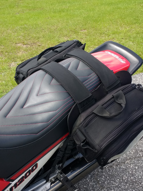

                  I've also played around a little with soft bags as shown in the photo. I like them and they work well but must be a bit higher up than where I use them on the XS11's. Without a pair of traditional shocks to keep them out of the rear wheel area I'm mounting them rather high up.

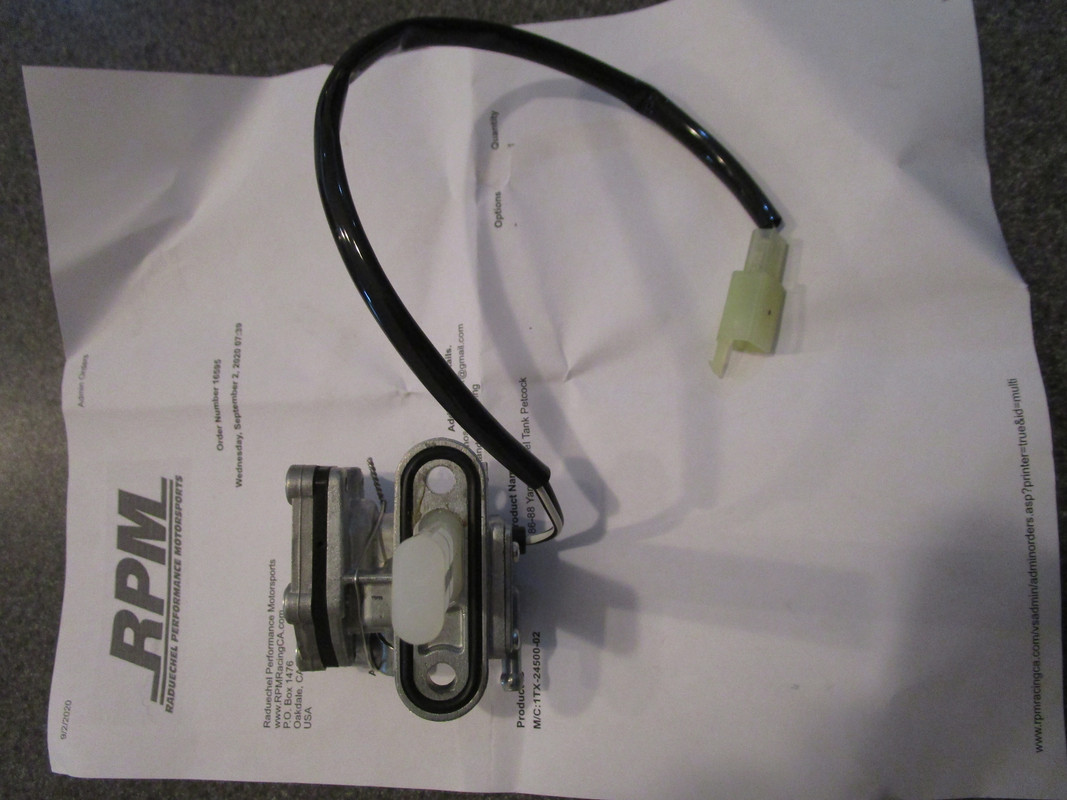

                  The other day, we awoke to the smell of gas.... REALLY BAD. I had filled the bike on my return home trip and parked her in the garage. I must have had TWO simultaneous failures. The vacuum petcock did not stop the fuel flow and a minimum of one float must have stuck as well. Gas all over the back of the garage. I ordered a new petcock from RPM Motorsports (the go-to-guys for FJ parts) and I believe I have the issued resolved. This model FJ is known for the supply nipple dislodging from the petcock as it is only a press & glue fit. The replacement is safety wired in to help avoid this catastrophic failure frequently resulting in fire.

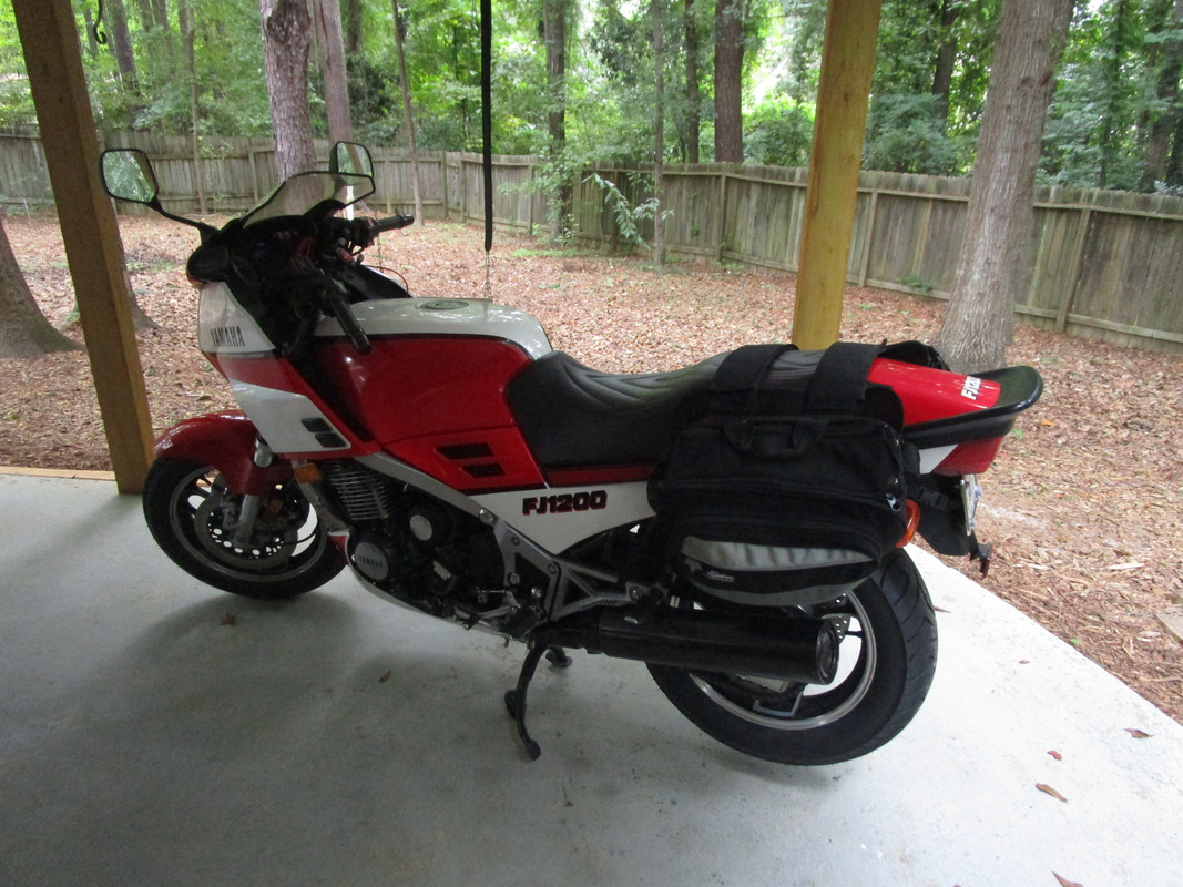

                  The FJ has been designated to the back porch until I am absolutely sure the leak is no longer an issue.
