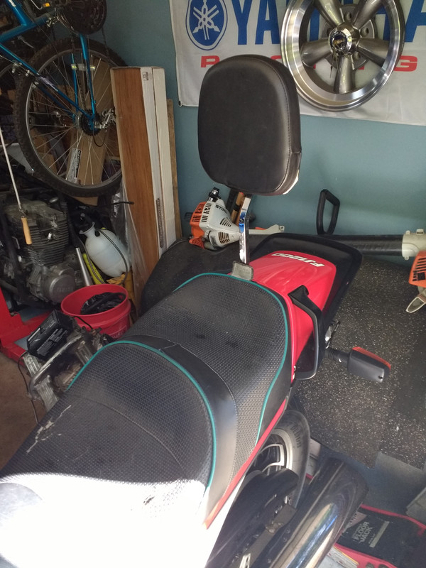

                        OTHER PROGRESS:
                        I had planned a custom passenger backrest but realized it would certainly cost HUNDREDS to get that done. There is VERY LITTLE accessory market for these bikes especially backrests and luggage type stuff. These bikes don't lend themselves too well to most accessories either.
                        However, CORBIN offered a seat called "Gunfighter & The Lady". The seat has a velcro covered slot in the back where a backrest post could be inserted and secured with a couple bolts underneath. I couldn't find a Corbin backrest assy. but I got this beat up old CORBIN seat from FRED G. for a reasonable price and fabricated my own backrest and post from an old HD back rest (same dimension square post).
                        This was a real SOB, heating the metal, beating the $hit out of it to re-bend it to a proper shape, drilling and tapping new holes, etc. Test fit, take off, heat & beat some more,Test fit, take off, heat & beat some more, test fit, take off, heat & beat some more, A real PITA!!
                        My seat guy is out of town right now but will recover the entire seat and backrest before the VYR Rally. It will be similar to the other custom seat and color keyed (red) to this machine. The accent striping on this one is for the 92/93 models.
                        Nancy is uncomfortable riding any of my bikes that don't have a back rest. When I accelerate, she's afraid of falling off the back...
