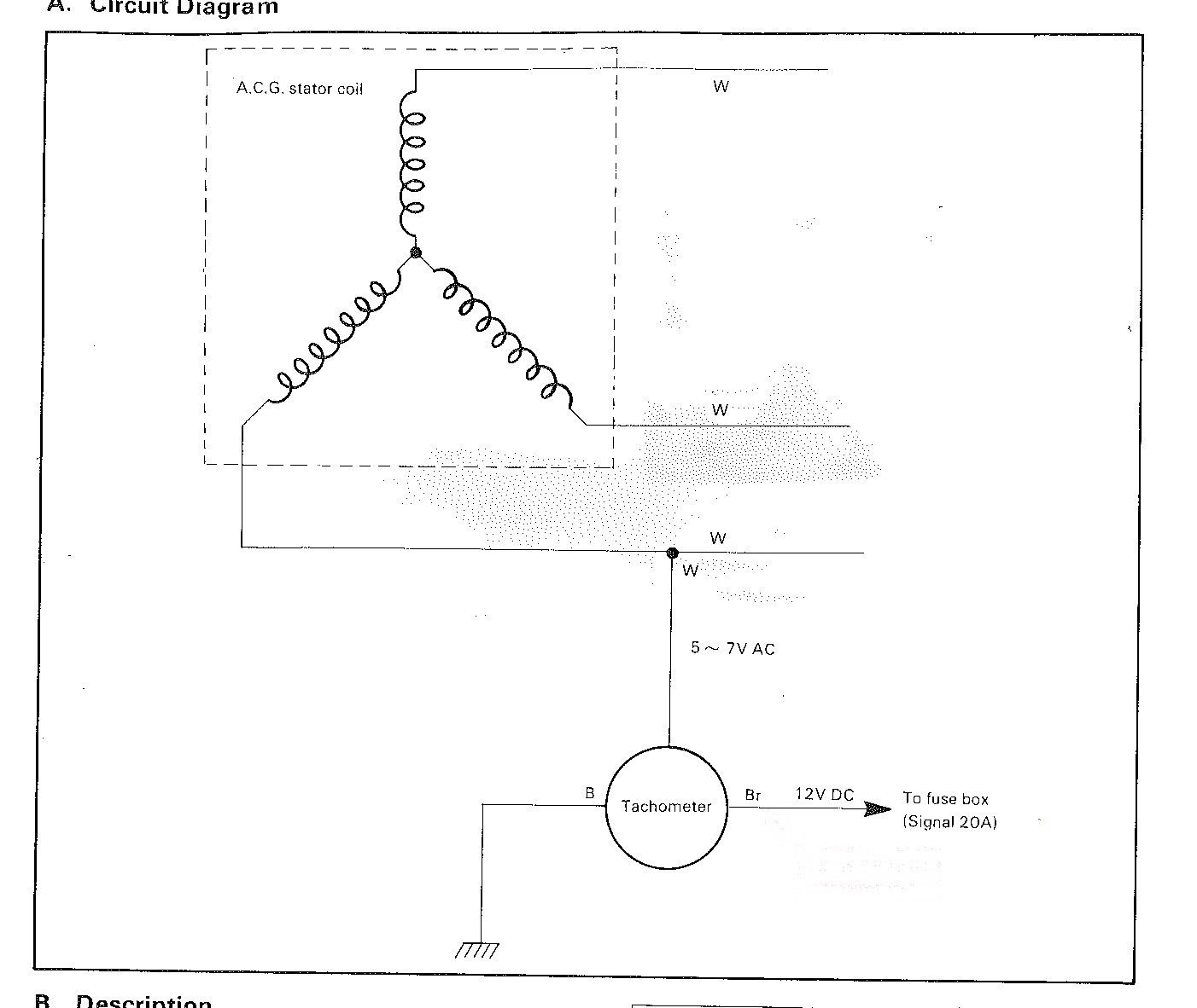

                      • 1814
                      • JonnyO
                        • Oct 2020
                        • 229
                        • Sun City West, AZ
                        Hmm? I see a hieroglyphic drawing. From inside the tomb of Keops?
                        But seriously I've no practical knowledge of this " stuff ". I'm supposing that the W, B, BR are representative of White Black and Brown wires. 3 Ws. Does that represent the plug under the fuse box? I'm going to Lowes to get some circuit cleaner to try and clean out as the one post said cleaning the two plugs with those W and Br and G color wires under the fuse box solved his tach issue.
                        Just a shot in the dark.

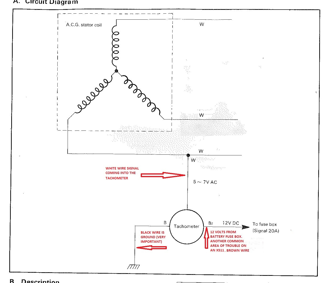

                              • 1814
                              Here is a better explanation of the diagram.
                                • 1814
