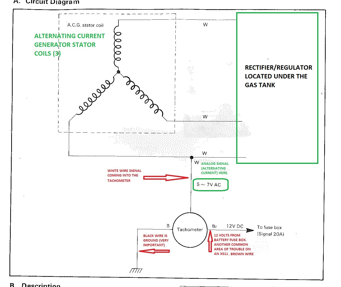

    Ok. With the key on the B/Br give me a reading of 11.22.
    With the bike running I get 12.7 with the white wire. No reading at all not running.
    What say you guys?

        When you check the white wire to ground with the engine running your meter should be on AC and not DC. It's an analog signal not a direct current signal. It only works when the engine is running and generating AC voltage (before it is rectified in the regulator). I am going to guess that this signal is OK. My point was more pointed in the direction of checking to make sure the connections were clean. Especially the two ground connections on one of the screws holding down the regulator under the gas tank.

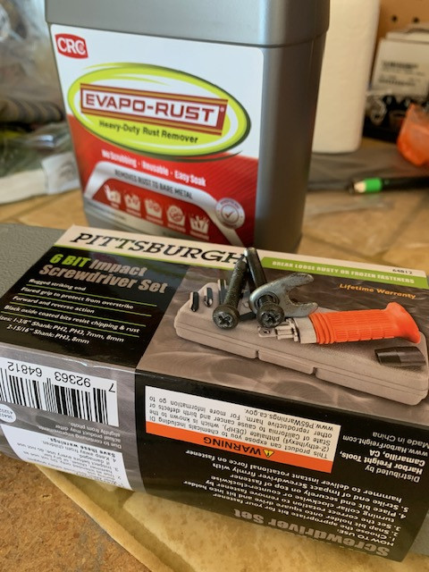

ID:	882671 So I was in the checkout line at HF and thought, " Hey, maybe they have an impact driver!". lol $10 bucks. Did the job. :-) Click image for larger version
Name:	aimpact tool1.JPG
                                As you can see, the heads on the screws weren't really too badly "stretched" from me trying to get 'em loose before using the impact wrench so I'll just use a little blue Loctite on 'em when I put 'em back. I presume dunking the whole unit in the Evapo without unscrewing it all apart was ok? I just left it attached ( though unplugged, as I sprayed the separated plugs with contact spray last night ) and put a glass on my compressor and dropped the whole switch in the glass and filled it up with Evapo. Moto said leave it for a couple hours...Is 3 good enough/too long?
