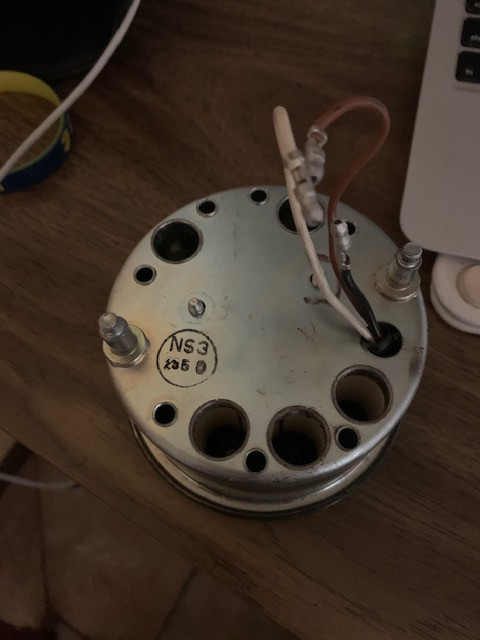

          So how do you get it further apart than this? I'm afraid to pry or pull any harder to separate the housing to access the board.
          Thanks!
            • 8938
            Jonny, you basically have to cut metal to get into the tach, so before doing so I would make sure the electrical connections running to it are in 100% good shape. If your tach reads zero and then comes on and off, it is most likely an electrical signal problem outside of the tach.
