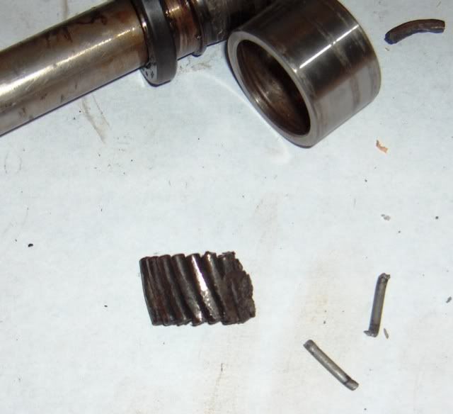

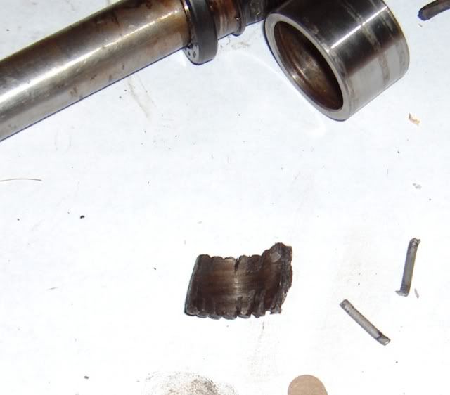

                              #1904
                              I have only heard of folks replacing during resto...not of failure though I am sure there are also instances of that.
                              John
                              Ya think? lol..
                              Needle bearings...
                              Needle bearings welded together.
                              My ol' buddy Bob Falter managed to do this fine bit of welding on his rear bearing.
