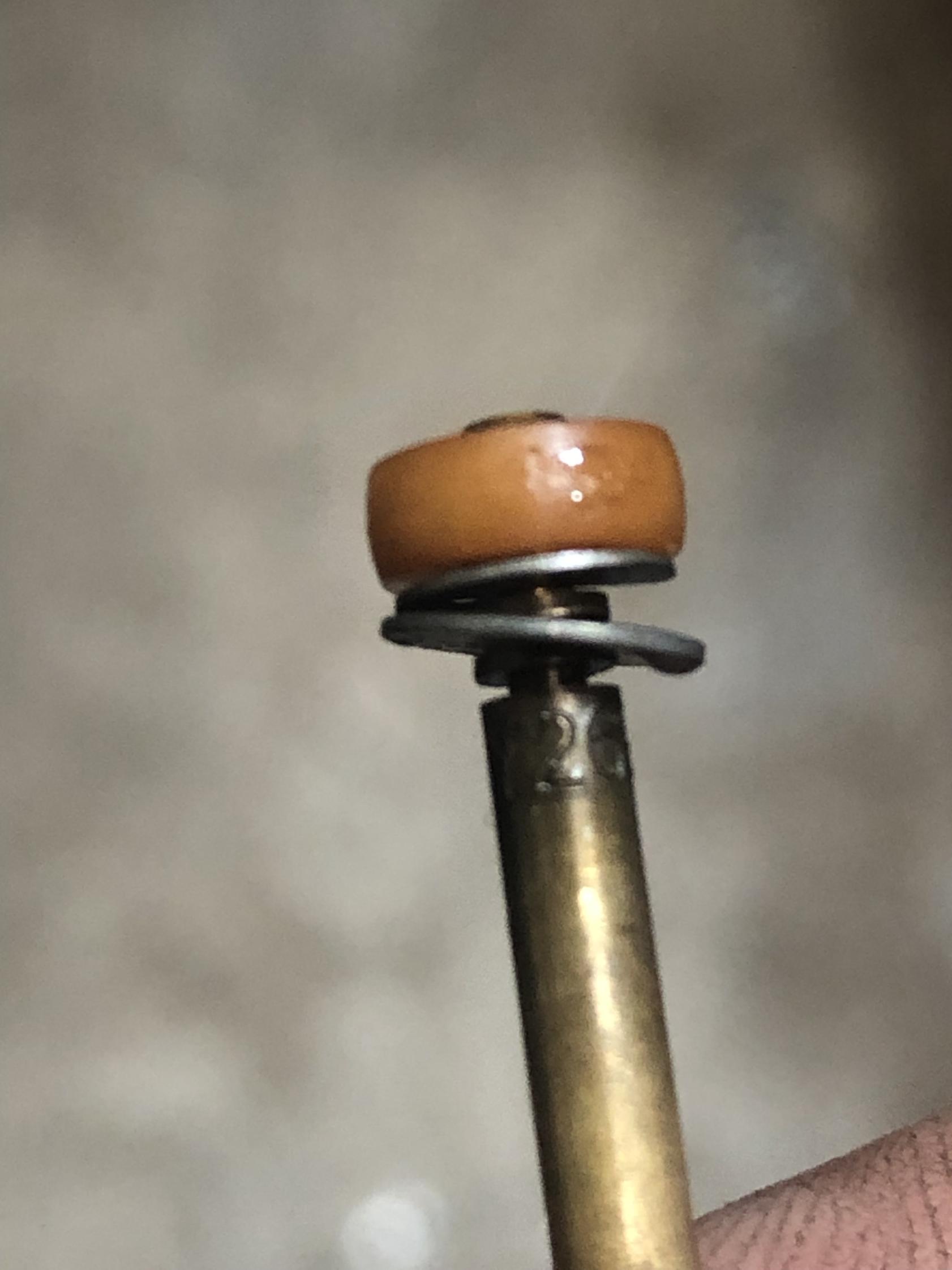

    In getting into the carbs, I noticed it had stock main jet and pilot jet sizes, 137.5 and 42.5. I also noticed the needle had the numbers "Y265" (it was also shimmed). I got to poking around on the internet and discovered that this is NOT the Mikuni number but the number that is commonly used in the K & L kits or even the cheaper Chinese kits. I even saw a comparison photo of the stock Mikuni and the K & L. The Mikuni is obviously much larger dimensionally and a totally different needle in general. I know that with all things Mikuni every thing is flow rated and often dimensions themselves may have no significance. I was also able to measure the orifice to the main jet and it was 0.055"....measured with two instruments to insure continuity.
    So......my best guess is that someone MAY have put an aftermarket jet/rebuild kit in there. In rebuilding other carbs, I have never noticed aftermarket kits like K & L being THAT far off. The larger Mikuni needle and smaller K & L needle style could possibly account for it running rich in the 1/3 throttle position range but once you go with full throttle it should therefore clean up and rev to the moon. (Right?) This bike does not. Full throttle just burbles along for a few seconds or longer until it fouls a plug.

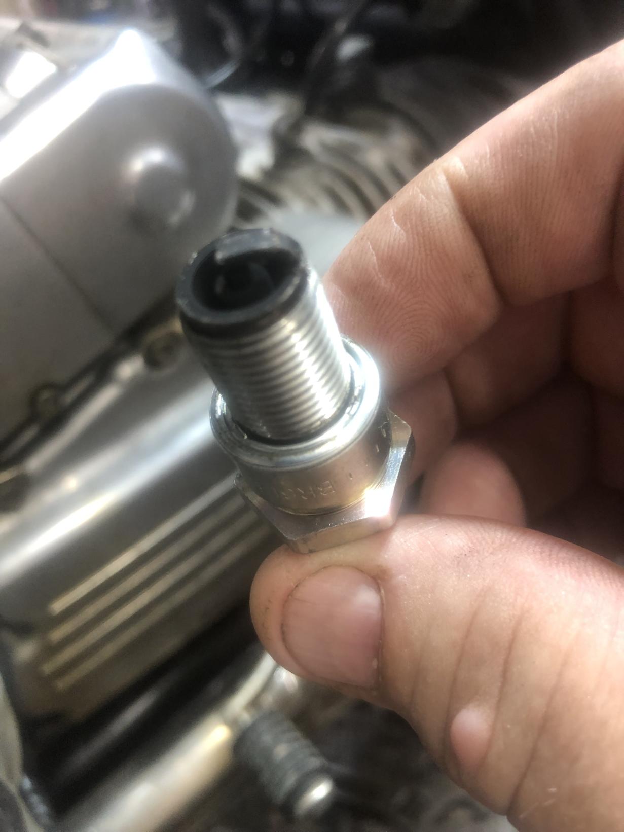

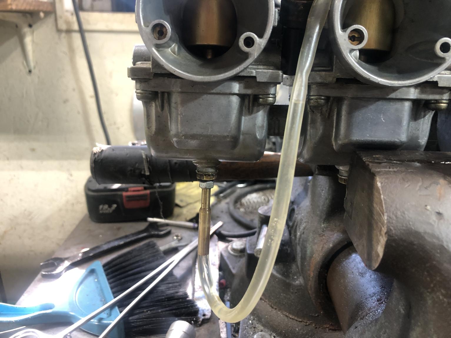

    I will include a few photos.

    Best way to start is buy Mikuni jets and install them. From what you have found, I would change ALL the jets, including the air jet in the bell(third picture, left side of intake) You may be able to find a set of carbs that have not been altered, but that is a crap shoot at this point. All Mikuni jets have the Mikuni mark on them, the rest do not.

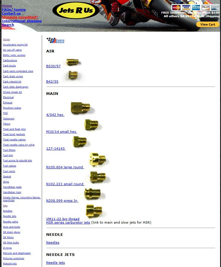

          Do not buy jets from eBay. Most are Chinese junk. You can get genuine Mikuni jet from here:

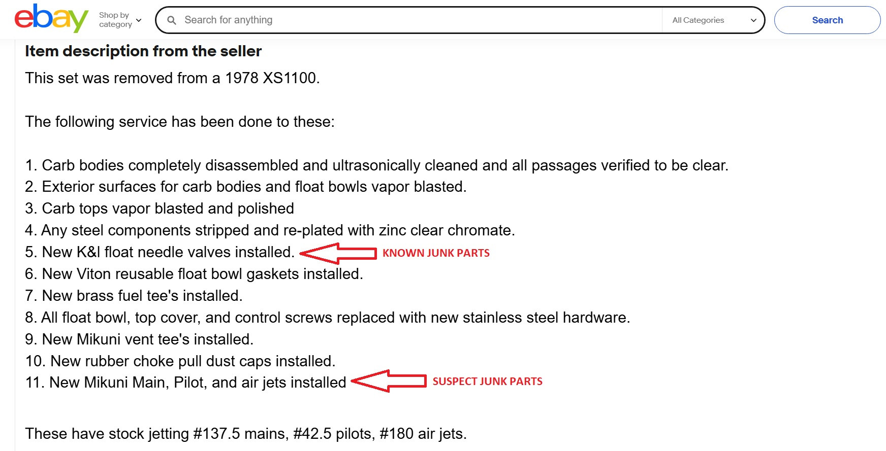

              Here is a typical eBay carb rebuilders list of service. It sounds great but is very suspect. He does not use Genuine Mikuni float pins & seats which is bad. K&L will work for a while but will fail over time because they are not that great as far as OEM quality. I have a lot of experience with this. He lists "New" jets but no mention of where these parts were sourced. Sounds very "Chinese junk" to me. However, I suppose you could contact him and ask the question and perhaps he will tell you anything you want to hear in order to sell a product.
              The only real truth is when you do something yourself the correct way so you can make sure there is no bullsh*t.

                  I already visited this site. The 5GZ6 needles are "out of stock."
