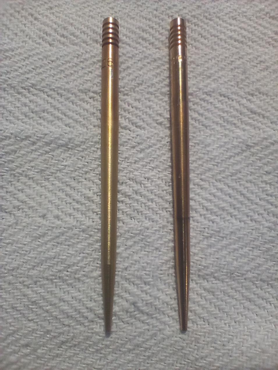

            Here is the genuine 5GZ6 on the left and the aftermarket Y265 on the right. There is a subtle difference and like I said, my bike ran poorly with the latter...
            It is amazing how little a difference has such a big effect.
