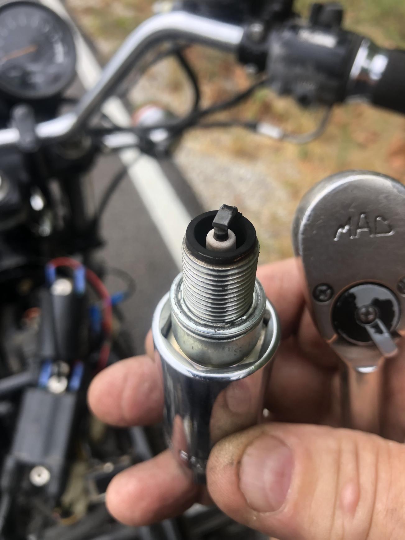

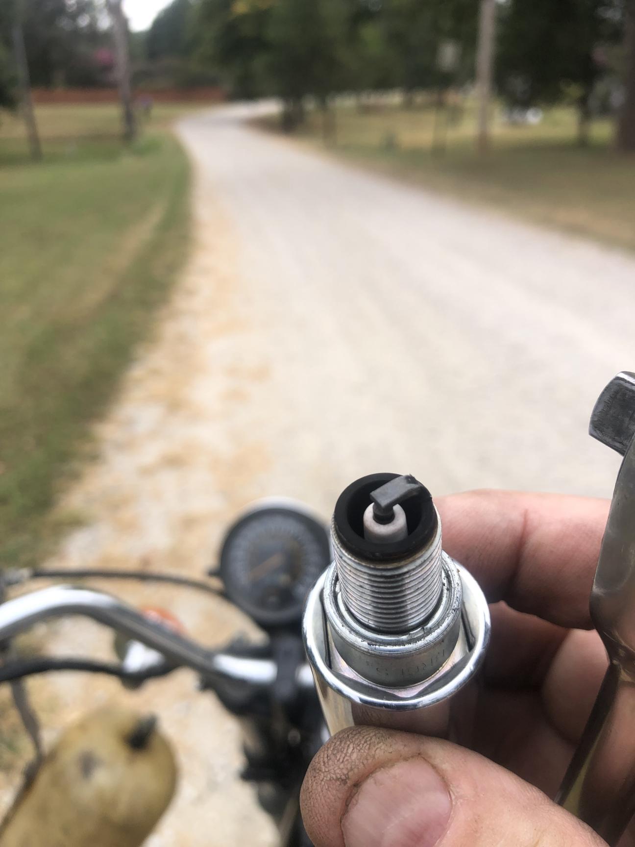

        So....the second high speed run that I made was a little better still. It still has what I would categorize as the "same" sort of problem....rough running that mimics an overly rich main jet. But that effect is now very transient and almost appears to be associated with a narrow rpm range (5500 or so?) as opposed to throttle position. Plus, once it passes that point and does it's little "shudder"...it almost acts like it wants to clean up and keep revving. I also did a plug chop, one after a mile at 50mph in 4 gear relying only on the pilot circuitry and the second, a full throttle plug chop from high gear at about 90 mph.

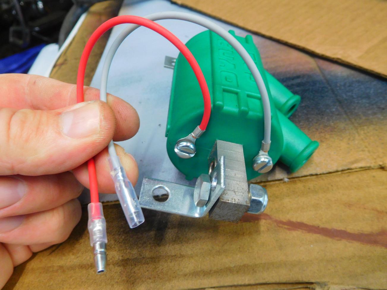

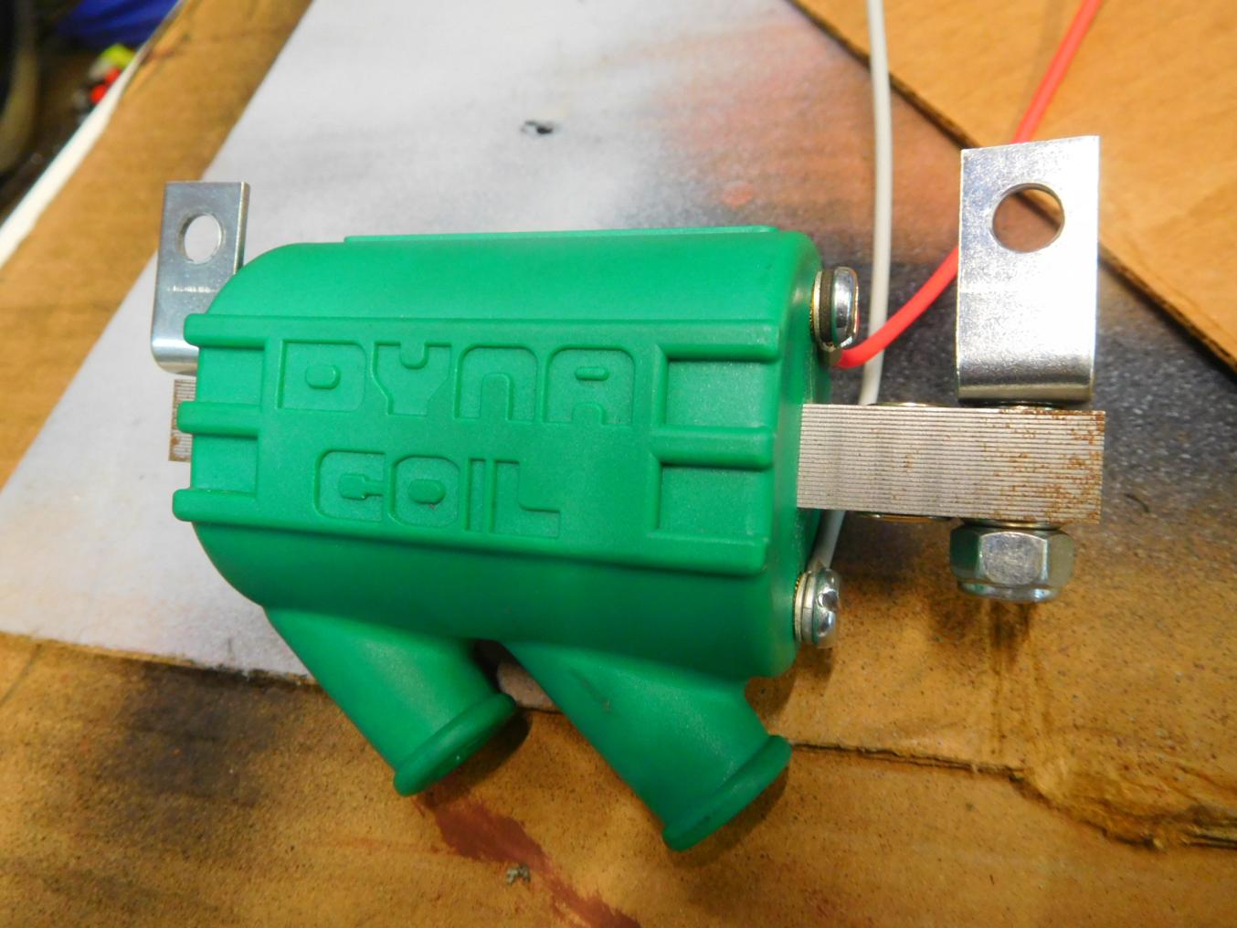

              Yep, they're good ones, super hot spark, super reliable, beware of cheap imitations. You'll need some small L-brackets and short bolts to mount them to the stock location though.

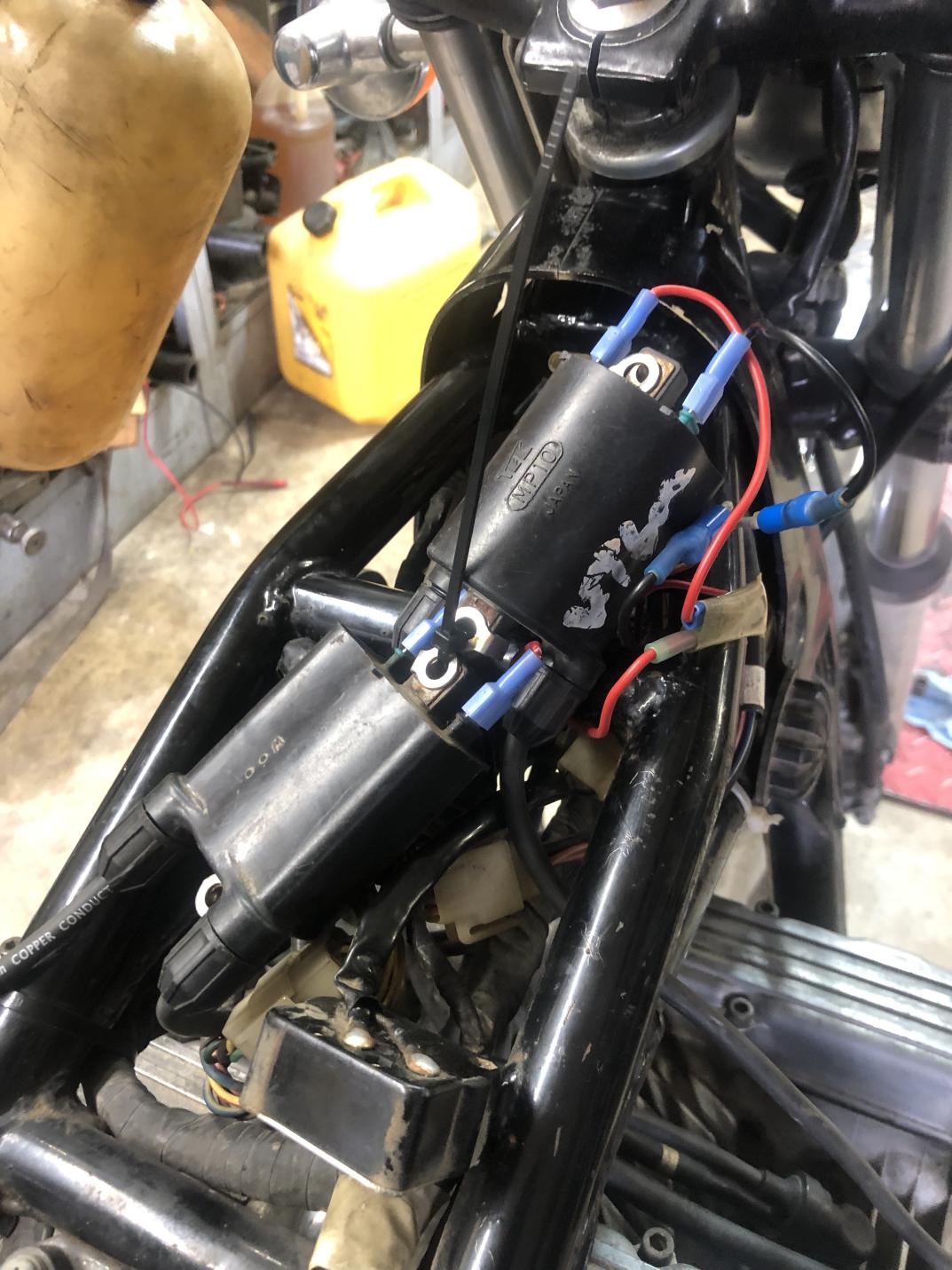

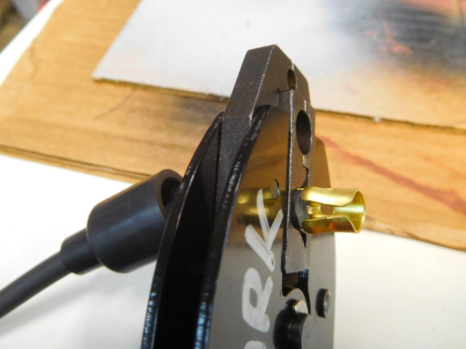

                I put Dyna coils on my XS11. Big difference in performance.

                  #38

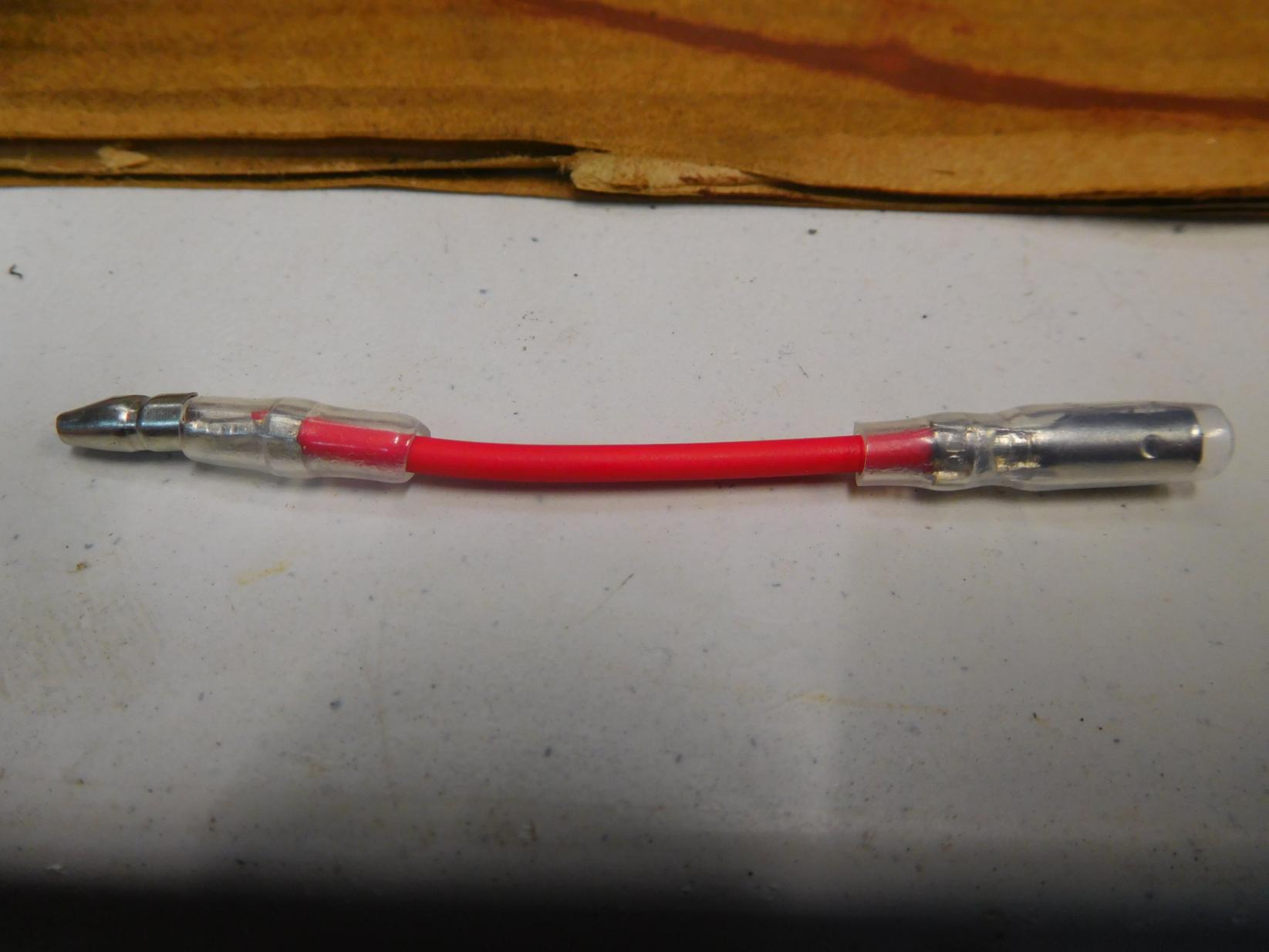

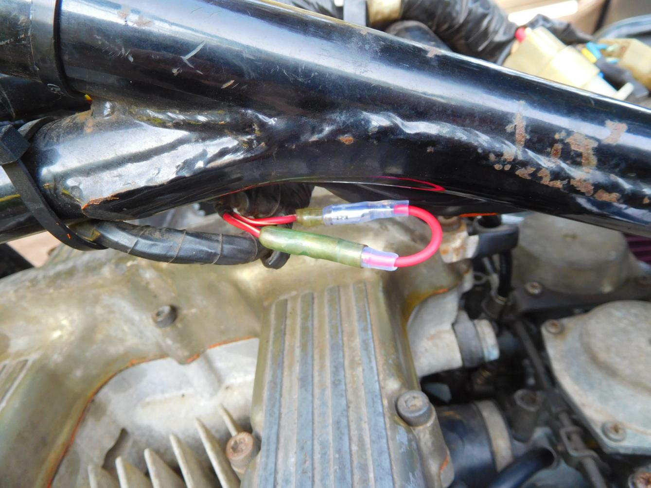

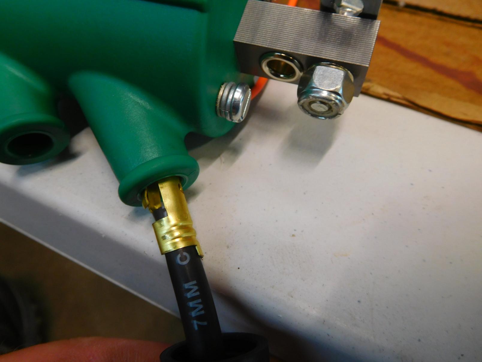

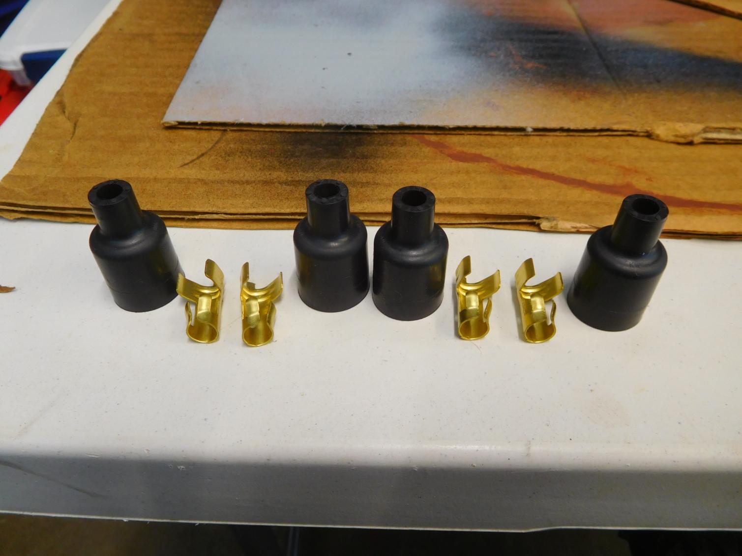

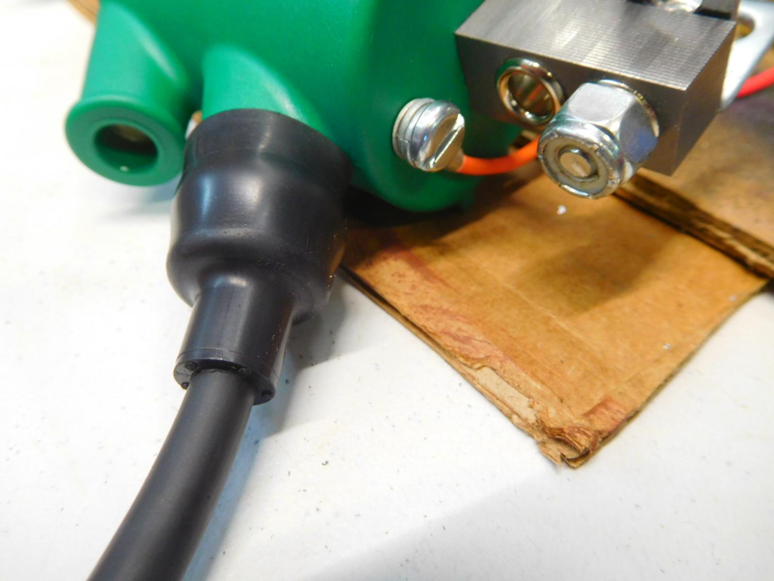

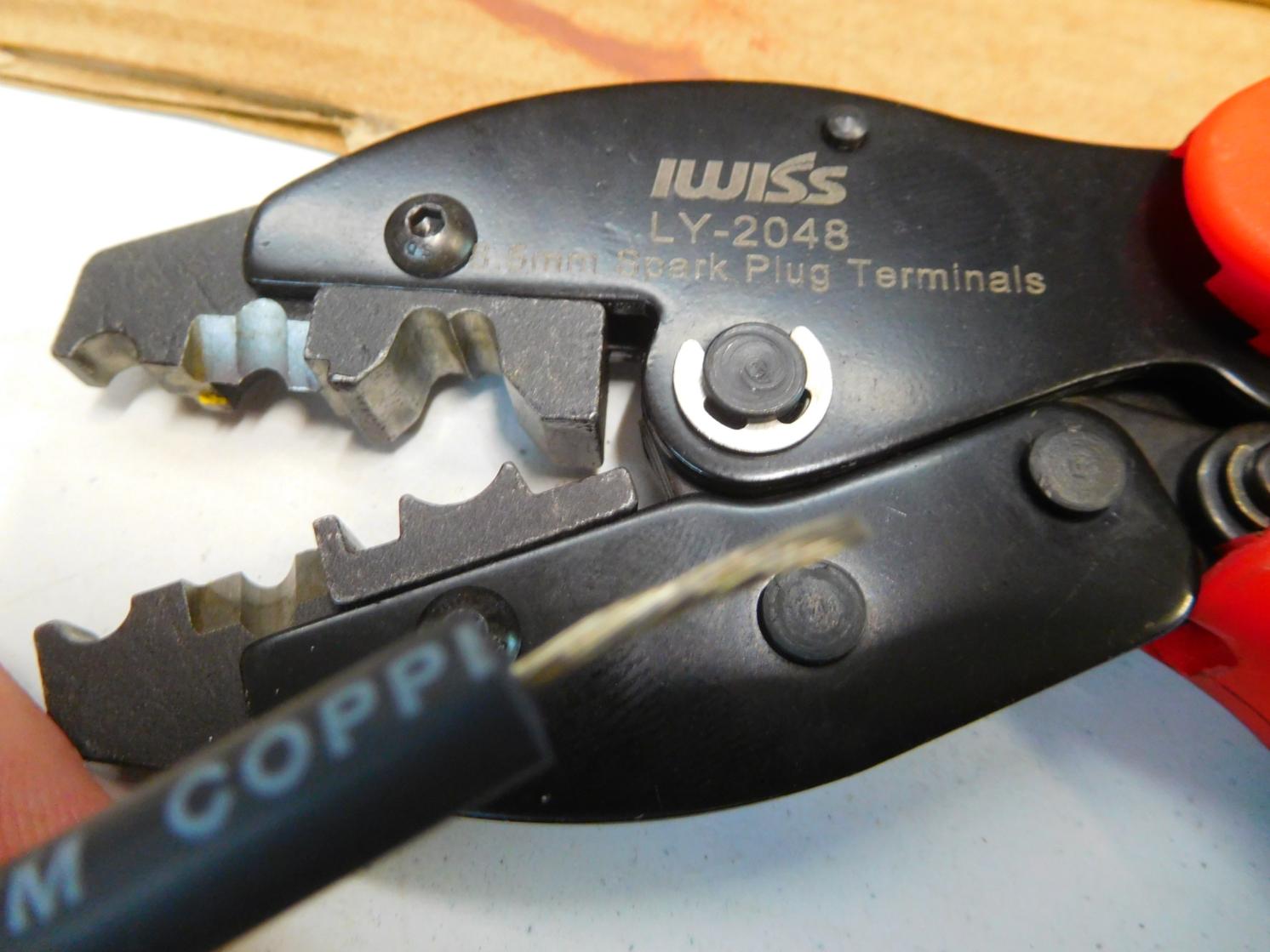

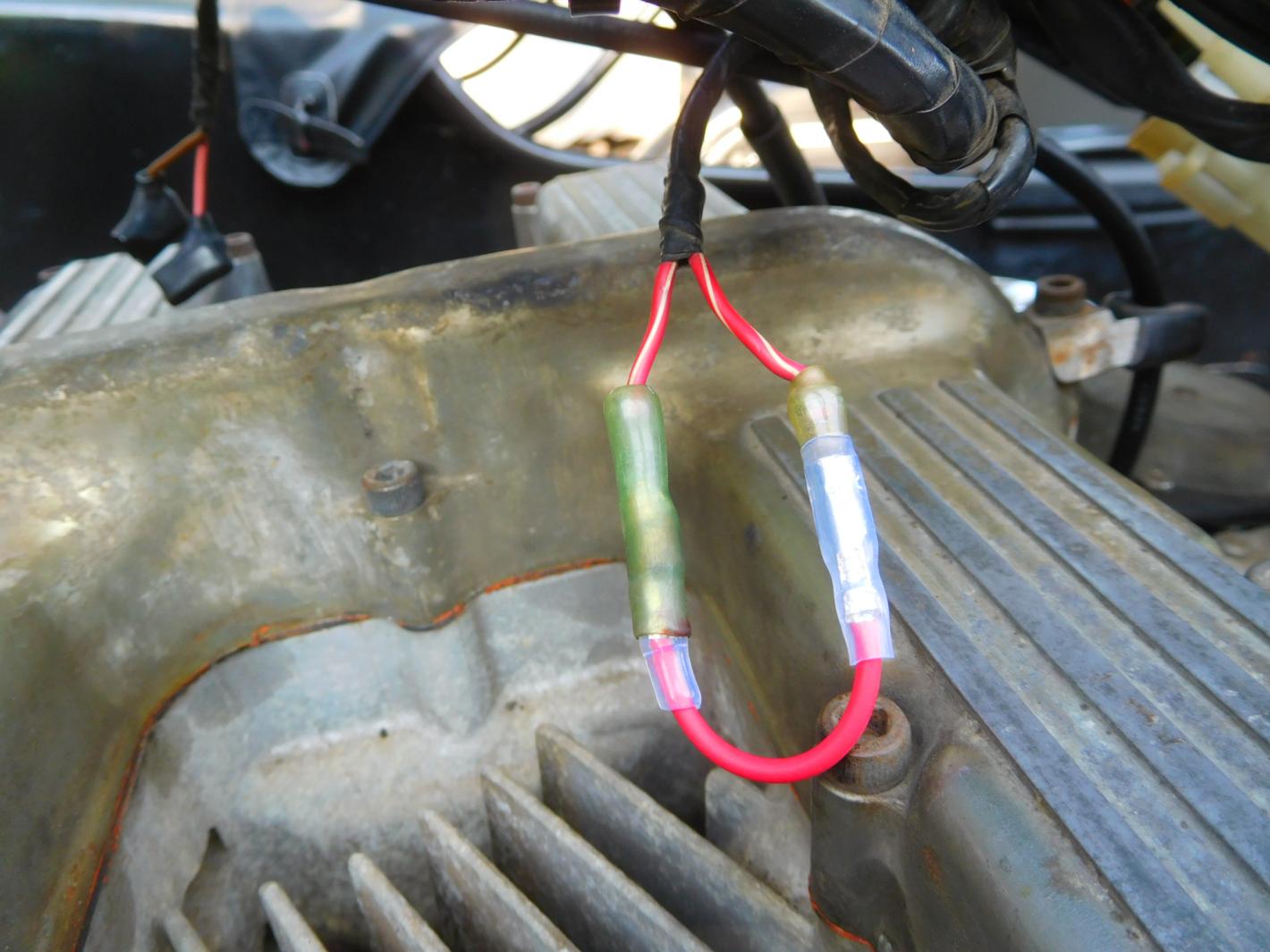

                    And make this jumper to eliminate the resistor. BTW, the only reason the resistor is there is so the ignition circuit outputs to coils that equal 3 ohms (impedance). The stock coils are less than 3 ohms so they have the resistor there to add up to 3 ohms. If you use 3 ohm Dyna coils, you can just jump out the resistor and the circuit will equal 3 ohms. If you eliminate this resistor with stock coils, the circuit will run very hot and eventually burn out which I'm sure has happened to many bikes that don't run/run right.

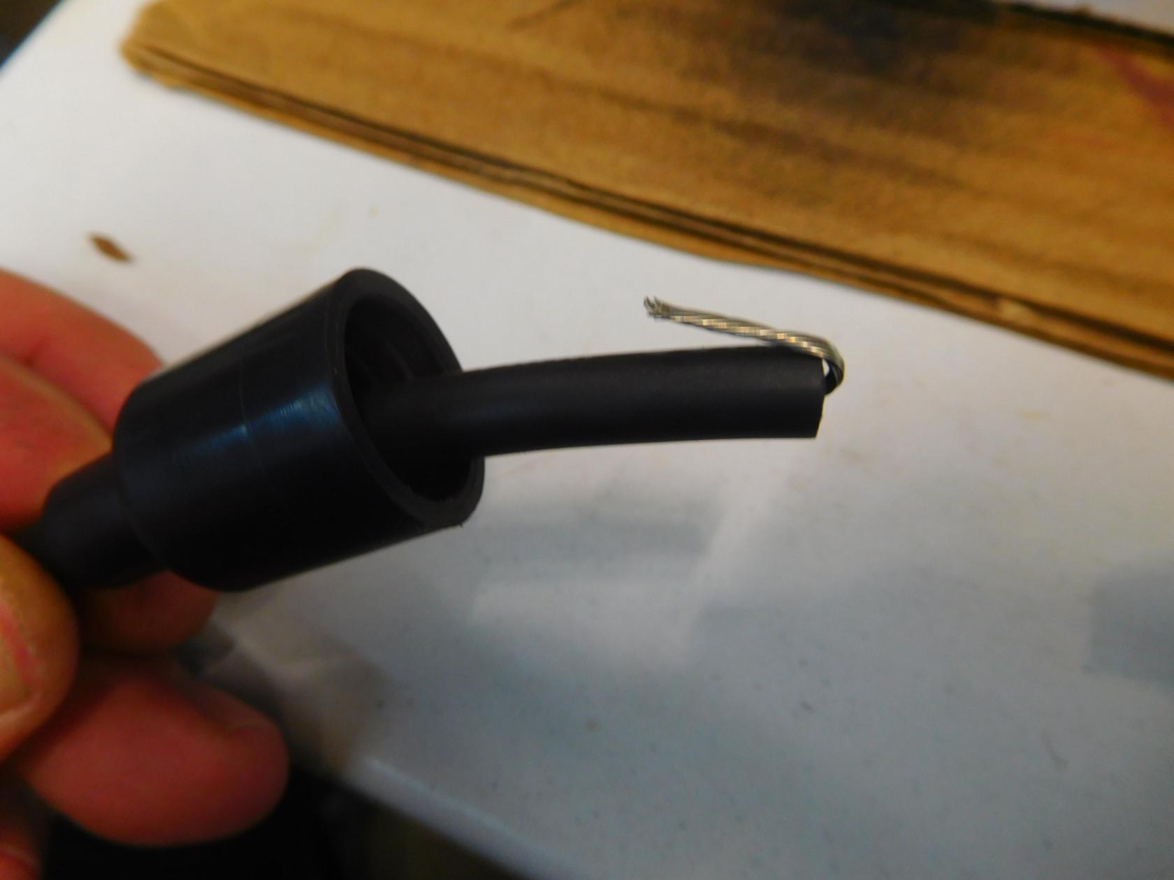

                      And also, your old coils were fine, the wires were old and cracked. It's the classic high rpm fail that bad wires act like (not to say you don't have some carb issues as well). Coils either work or they don't work. Everybody misses the wires because they "look fine". When the bike is at idle spray some water from a garden hose on the spark plug wires. If the wires are good it will still run perfectly. If it sputters or shuts off, you have bad wires.

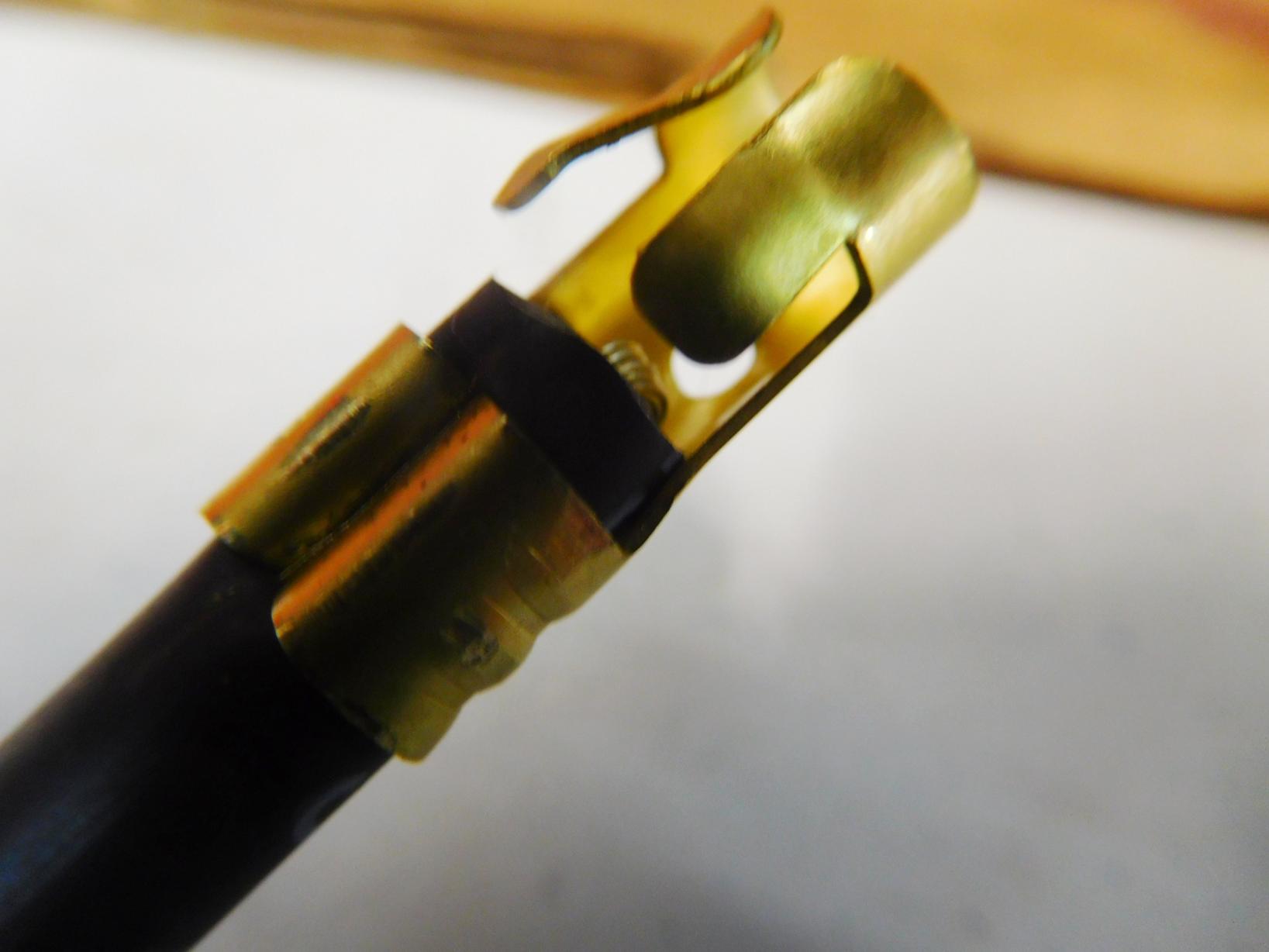

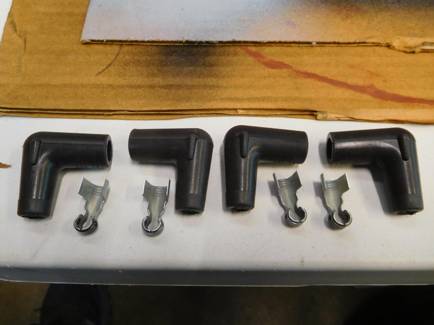

                        Several years ago, I bought a kit from XJ4Ever.com. It came with Dyna coils, clamps, wires and everything to complete the job including detailed instructions. I upgraded my coils in the driveway in 20 minutes. Whatever I paid for that kit it was money well spent.

                          I was able to do another test run today. This time I attached the air filter and the bottom half of the air box. Due to the way things are sort of cobbled together right now on the bike, it's not perfectly sealed up so I imagine some air is able to come in around the seams. Subsequently, at full throttle in top gear from about 4000 rpm it "shuddered" about the same if not very marginally worse.
                          However, I'm going to walk away from it for a few days. The bottom line is that it IS running MUCH better than it was. The problem now is that I may be reading things wrong. Taken in total, it just seems that I may be missing something. After today's run and also yesterday's, the spark plugs are showing lean. The insulator is bright white and the side electrode is clean. The only thing that is puzzling is that the shell or rim past the threads that is exposed to the combustion chamber is sooty. Also there is a noticeably lean spot in the throttle position. From 2000 to 3500 rpm with light throttle settings it is sort of lethargic. Once past 4000 with more aggressive throttle, it comes on strong (almost too strong). When it "hits" it comes on strong until about 5000-5500 rpm, it then does it's little "shudder" thing....and then sort of smooths out. With an aftermarket less restrictive exhaust and the plug tips showing nice and white, I'm a little scared to lean out the main jets any more than stock 137.5.
