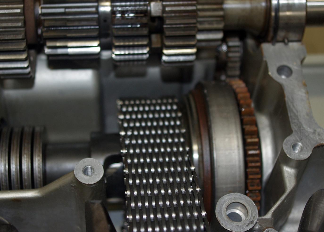

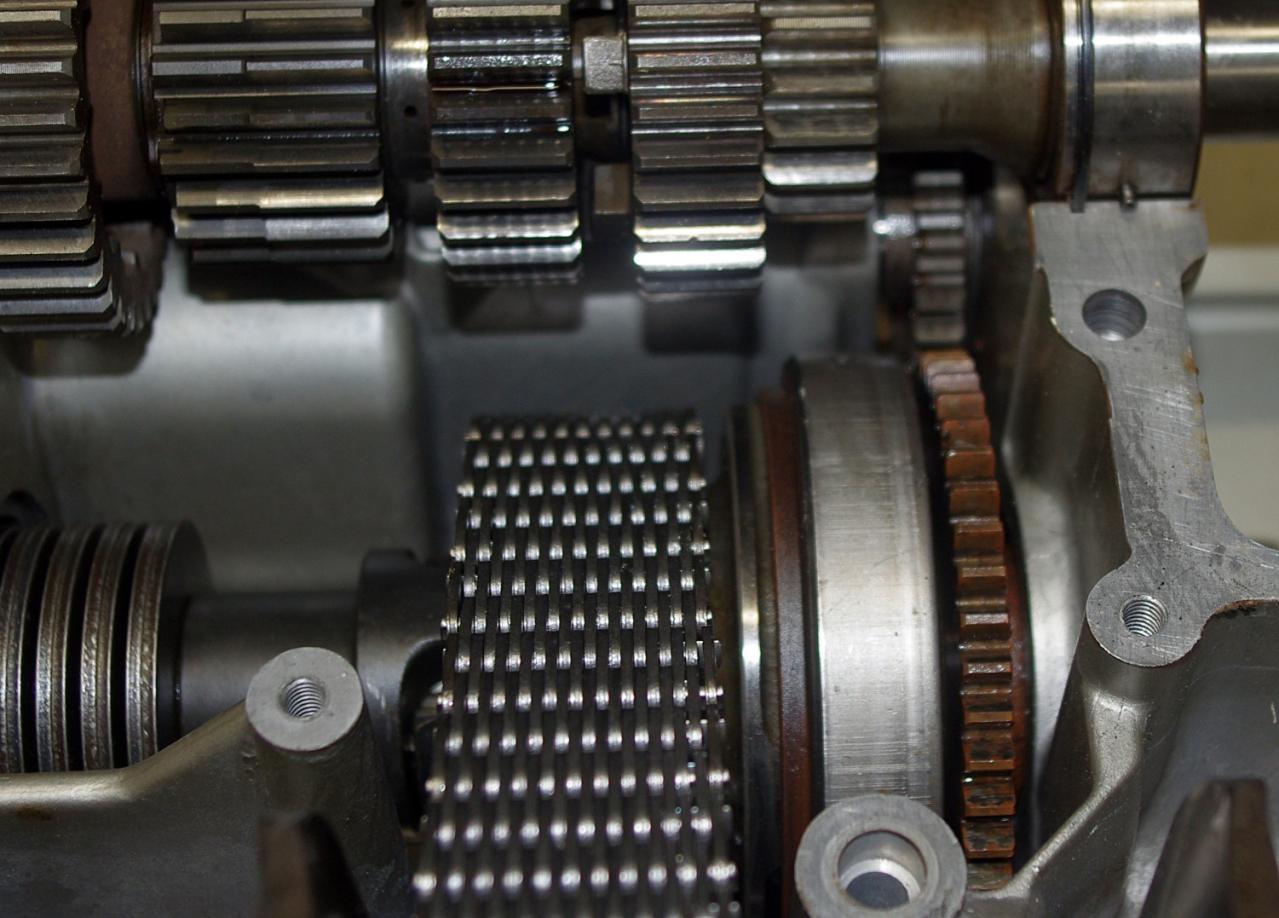

                        So in and out with the primary shaft! I'm trying to get the gear endplay close. The spacer that was in there is too tight, so I'm trying to make some shims I had from rebuilding kingpins on my '57 Chevy truck work. Photo's show the gear one side then the other. I known not much BUT I want it to last a long time! First photo the gear is close to the starter clutch. Second photo it's farther away. Movement is about 1mm.Click image for larger version

                          Another step back today! I got the spacing correct, but cut an "O" ring doing it... So a few more days until I try once more. Getting older and not being able to see like I used to sucks!
                            • 7817
                            #58

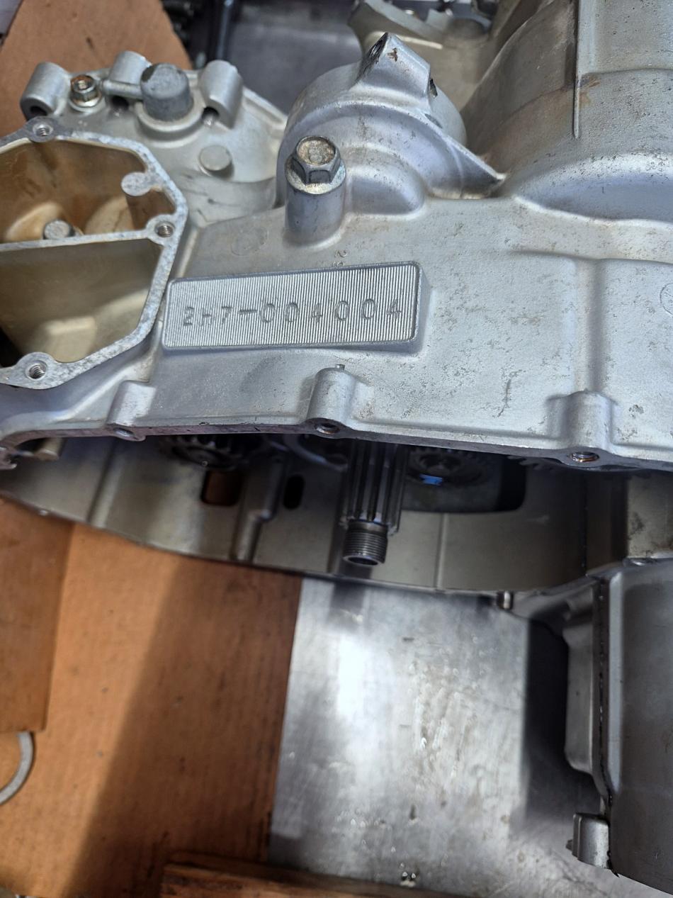

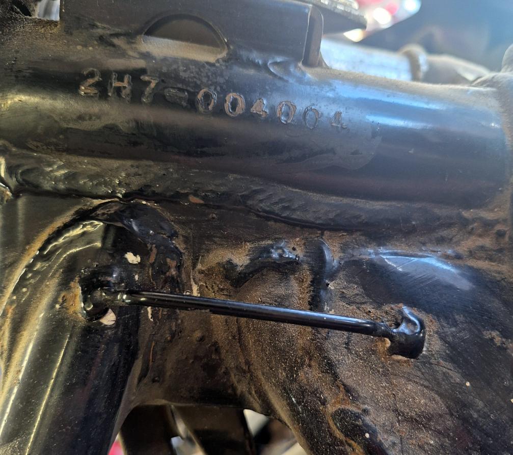

                            Spacer was not needed! End play is from the starter clutch, and nothing rubs so good to go. Got the "O" ring replaced and the top case is ready to go.
                            Went through bottom once again, and it to is ready, so time to mate them.
                            What I found is you will need to turn the transmission gears a bit to get everything to mesh. Once I did that, the two halves went together and I started to inset bolts.
                            Did the crank bolts lightly, 8mm, about 2 pound feet by feel. I then did the 6mm bolts about the same until I had ALL the bottom bolts installed and snug.
                            Then, following the manual and marks on the case, I torqued the 8mm to spec, and then did the 6mm.
                            Photo of the engine now, with the number and the frame number. This is NOT the engine I pulled out of the frame, as the PO had replaced it after it "locked up" on him. He was a big guy, and rode it like he stole it all the time. He had broken a tooth of the transmission gear ant it lock the tranny up.
