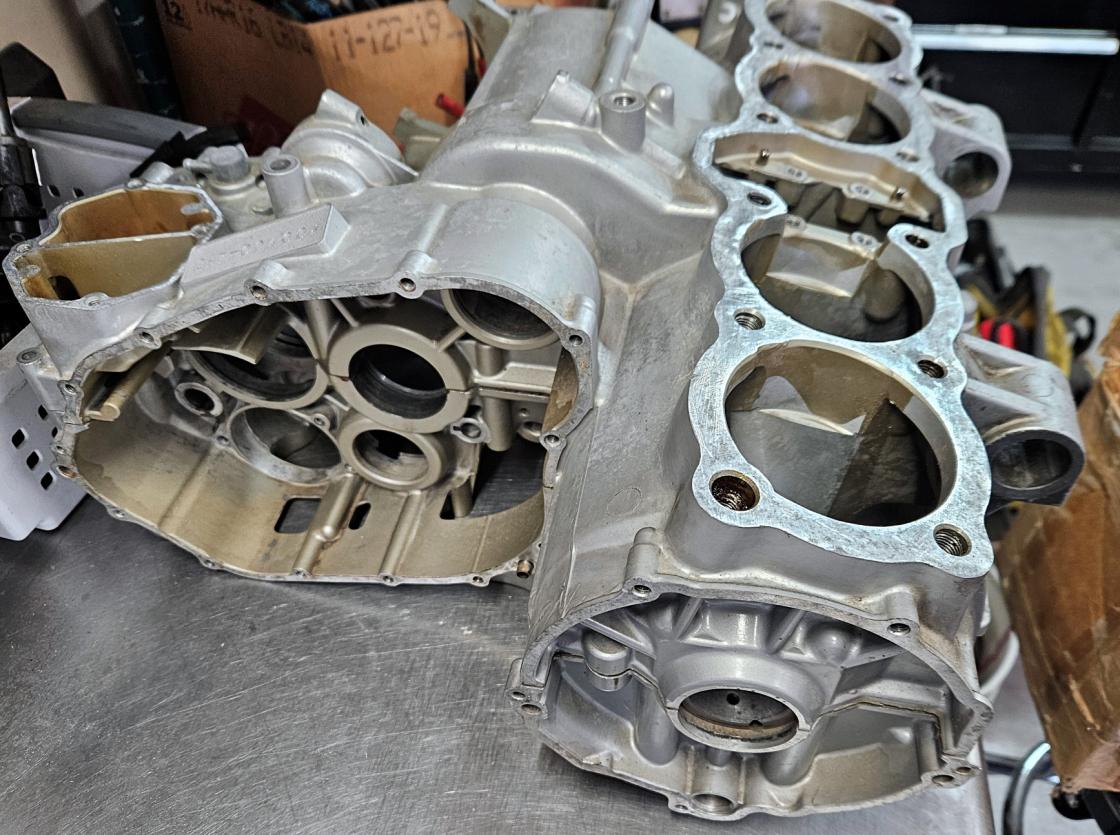

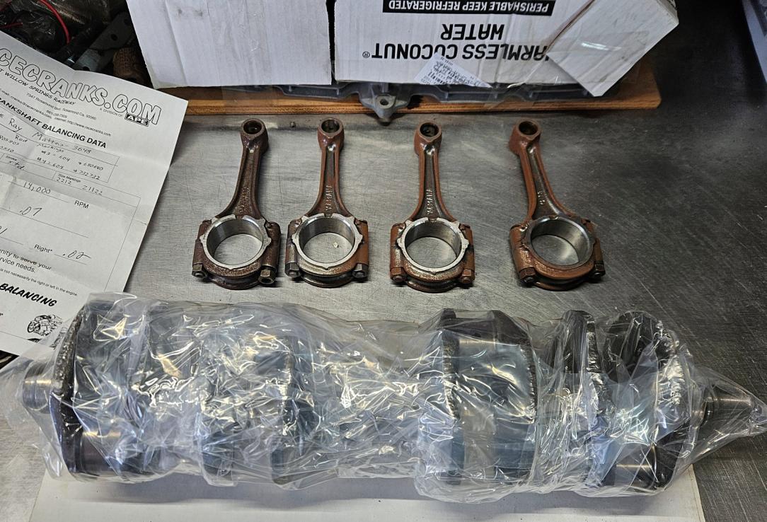

    It's been 15 years since I had the crank sent off to get balanced. I am just now starting to clean and assemble the 1978 engine! Yeah, life gets in the way, but at least I'm starting this project.
    I have the cases almost cleaned, so I can fit the crank and plastigauge the bearings. I do have an almost complete box of new crank and rod bearings, so everything should be within spec.
    Click image for larger version  Name:	Crank_r.jpg Views:	257 Size:	156.0 KB ID:	881993 Click image for larger version  Name:	HowOld_r.jpg Views:	264 Size:	152.8 KB ID:	881994 Click image for larger version  Name:	Cases_r.jpg Views:	256 Size:	152.2 KB ID:	881995
    Yes, I got the crank back from APE in 2009!!

        It will NOT be a stock E. The engine has an 1197 kit going in, and possibly a newer big valve head. I don't know if you can read the paper, but the crank is balanced for 14,000RPM sustained operation. My plan is 10K redline, but I can bump it up if need be. Intake and exhaust depends on what I can find at a good price.

              Well, when they balanced the crank, they destroyed the markings for the bearings!! I've started to S-L-O-W-L-Y check all the bearings with plasti-gauge so I can have the correct clearance on the mains. I also need to do the same on the rod bearings. Sounds bad, but I need to wait for parts, so I have the time.
                • 7842
                Well, I'm going to have a little loose clearance issue with the mains and rods. Stock Yamaha bearings are NOT able to make up for any machining. So far, the mains should work, just. They will be about 0.001mm big. I'll be checking the rod bearings in the morning, after I vote.

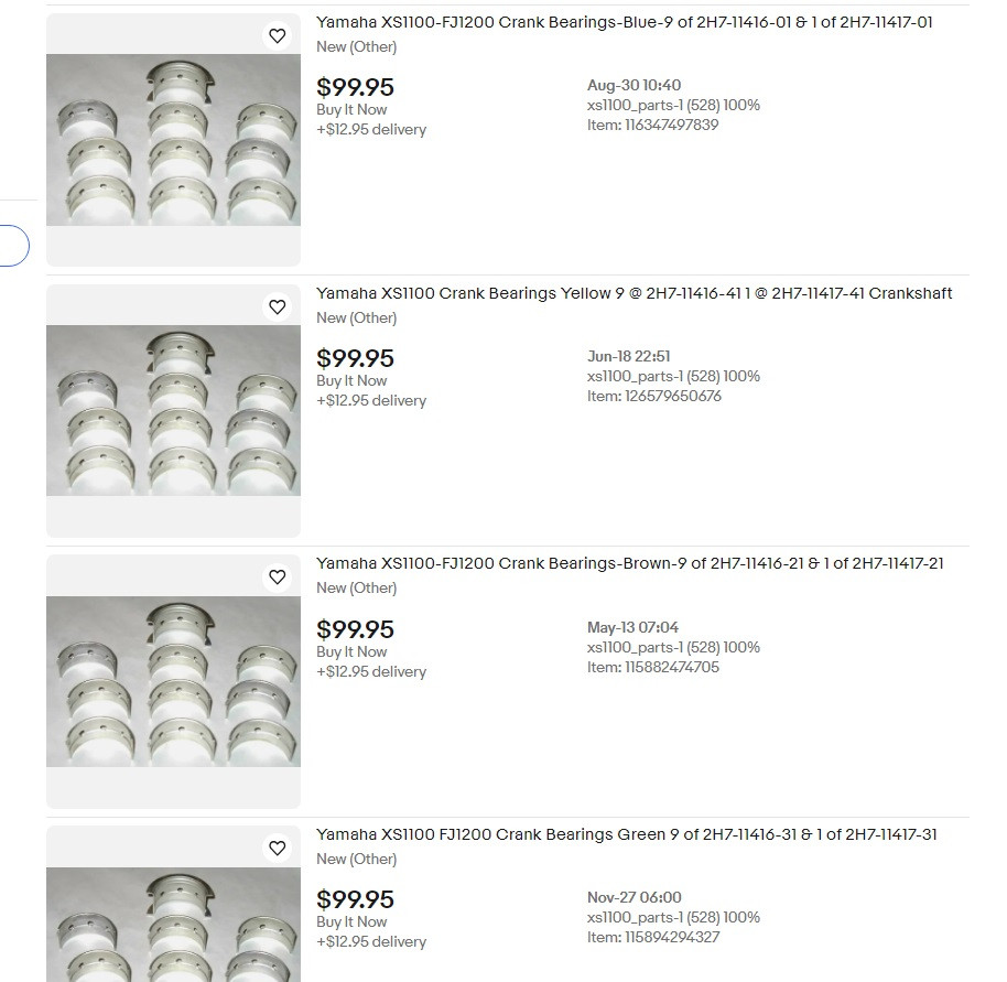

                  Ray, perhaps oversize bearings are in order?
Name:	oversize bearings.jpg

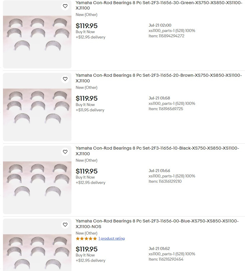

                    Rod bearings if needed.
Name:	rod bearings oversize.jpg

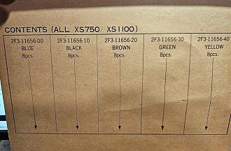

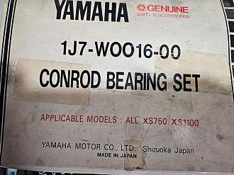

                      I have the complete set of these bearings! Two boxes, one crank, one rods. They cover all the sizes, though I only have a few of two.Five sizes per, but clearance is a little big. I may try and see if there is a hot rod shop here in the Boise area that can "build" the bearings for me.

                        That is a shame as these bearings are expensive enough now. I also bought one of these boxes many moons ago and they were cheap then compared by now. I remember you writing about that crank long ago. I can't remember if I told you the story of my French friend Baloo who owned and prepared the yellow XS1100 endurance racer with #94. In 2008 I visited the classic endurance race at Spa Francorchamps and did not find the bike in the pit box.When I finally found him he told me the primary chain had broken and had punched a hole in the upper case. Although they swapped it every year for a new one it could not stand continuous riding over 10k rpm. I think however he rode with higher rpm (if possible). That's how he is I don't know your riding plans but I think you should remember that in the back of your head.

                            Well, just back from a local machine shop. I was NOT able to measure the bearing inserts, as my micrometer does not have a ball anvil on it. The gentleman checked my crank main and rod measurements, and then was able to check all the bearings. Yamaha bearings are Blue, Black, Brown, Green, and Yellow for both mains and rods. Blue is the thickest bearing, and they get thinner as you go right to Yellow. The difference is 0.00025". Yes you are reading that correctly! I also got my parts from MikesXS today, so I can start to put some of the parts back into the cases. I still need seals and a few other small bits, but should be able to get it all in about two weeks.
