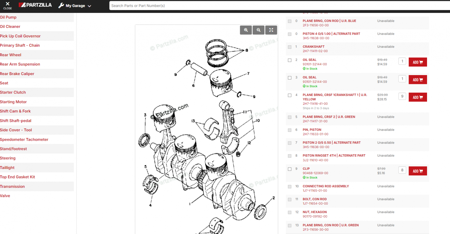

              I'll be ordering from partzilla once I have all the seal numbers I need. I'm also going to try and get a main drive chain, as I don't know how bad/worn the one I have is.
                • 7842
                Well, no chain from Partzilla. I did spend about $200 on bits and seals, though. If someone has a line on the main drive chain, please let me know.

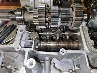

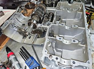

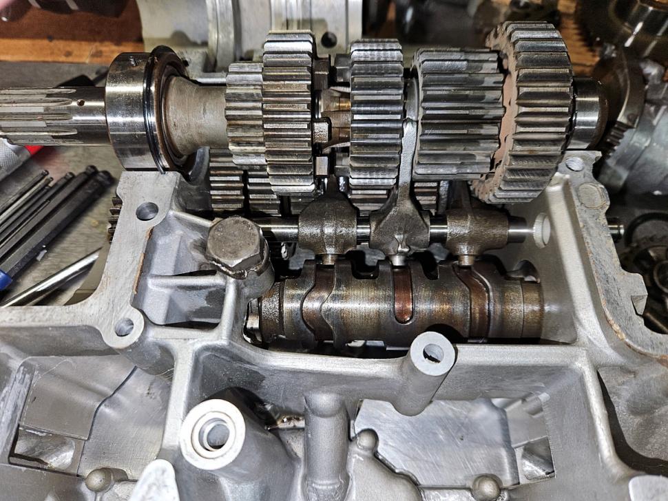

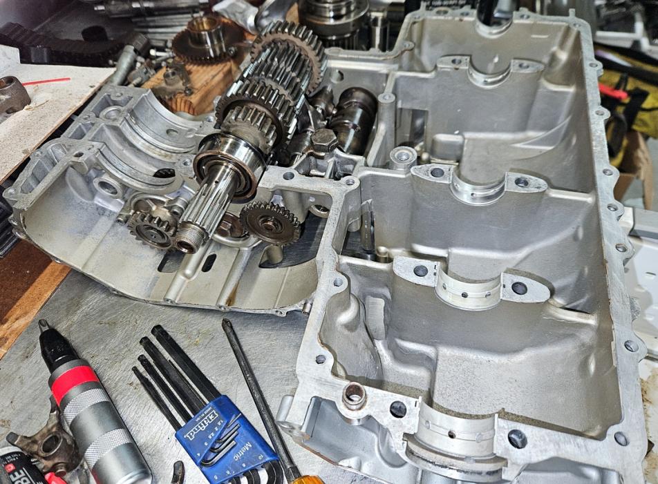

                        Waiting on parts to move forward.

                          • 300
                          Now THAT IS A CLEAN ENGINE!! If it runs as powerful as Special Ed's monster engine was it will be a beast,,,,good work Ray,,,,,,,,,,,,,,Mike in San DIego and Pa.
                            • 7842
                            Mike, My current "ride" has an engine like Ed's did. This engine should be about 20HP more, if I can get what I would like for the build. Without, it will still be very fast. 1197 kit is going in '78 cams, FI, and a turbo if I can find the one I would like to put on. I will be building the exhaust system, so quick no matter if it's just "stock" carbs or all out.
