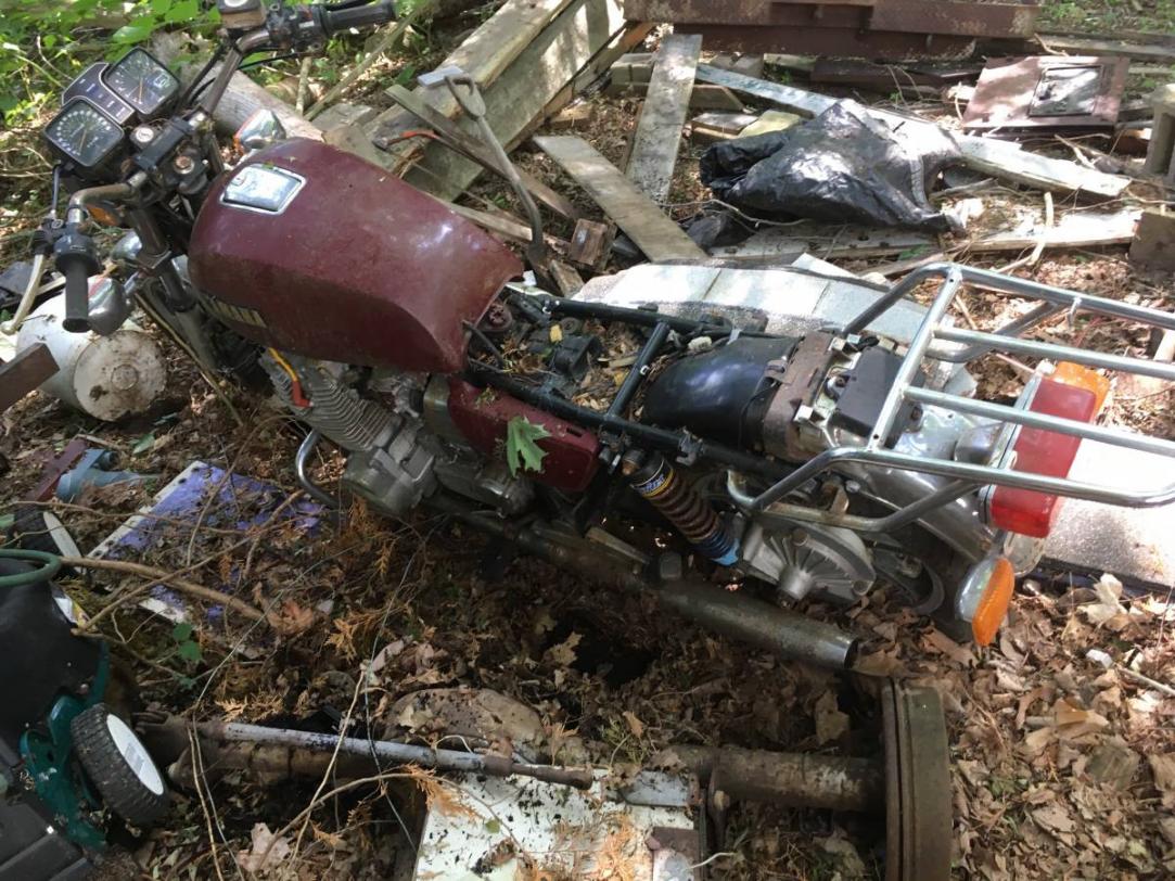

Back in the fold: '79 XS1100F
    • 2011
    Into the 1978 frame of this bike.

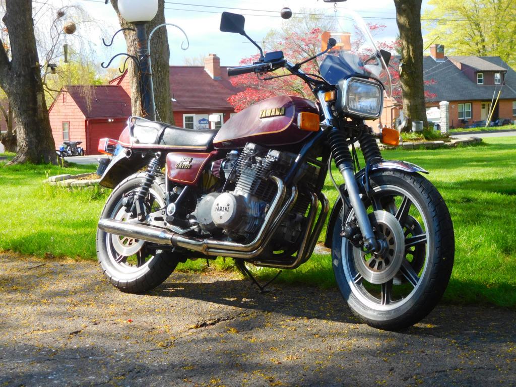

      • 2011
      The bike today.

      • gtem
        • May 2023
        • 235
        • Indianapolis
        that's awesome! What exhaust and what windshield is that if you don't mind me asking?

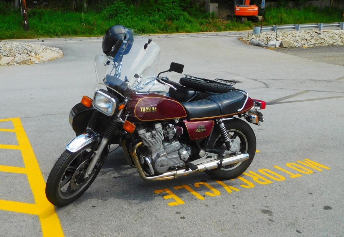

          I run a stock 1980 motor out of this bike.
          Click image for larger version  Name:	DSCN3890.JPG Views:	3 Size:	198.9 KB ID:	881960
          I'd try to find a couple of polished metal cannisters of some sort such as fire extinguishers and rig those up to hold gas, or perhaps an old six gallon gas tank used for outboard motors.
            The exhaust is a MAC 2 into 1 + 2 into 1. Great access to the oil filter and the cam chain tensioner. Relatively quiet but throaty. The windshield is a National that I picked up used for $10.00 at a swap meet.
              LAB3, this bike did, in fact, have two fire extinguishers for gas tanks. They were so horribly constructed with RTV glued-in fittings that I tossed them before the photo shoot. This guy was a Hack Master with very limited talent. But I can't complain because I got the bike for free. With a title. Great motor and tranny. Also used the carbs after rebuilding. I now travel the earth with equipment that was once dead.

                  An aside, what is the official name of the '79 F brown/cinammon? I saw an old thread where the two "F" paint colors were Indigo Blue and "Magenta Red"... how could you ever call that metallic brown a "magenta red?"
                  '98 GSF1200S '81 GS850G
                    • 813
                    Dirt build up and oxidation. My bike is supposedly magenta red and ruby red although most people (including myself) see it as brown.
