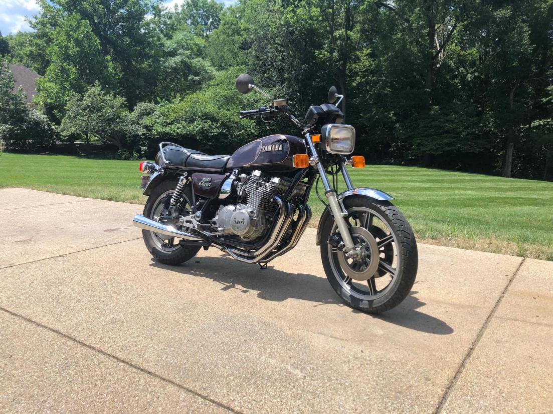

    Nice bike. Still has the old style seat which is great. Airbox, Mac pipe & center stand still attached. If your rear rim has mag locks you have a set of tube rims.
    • gtem
      • May 2023
      • 235
      • Indianapolis
      Thankfully it's a Kerker, I haven't had the best luck with Mac brand exhausts.

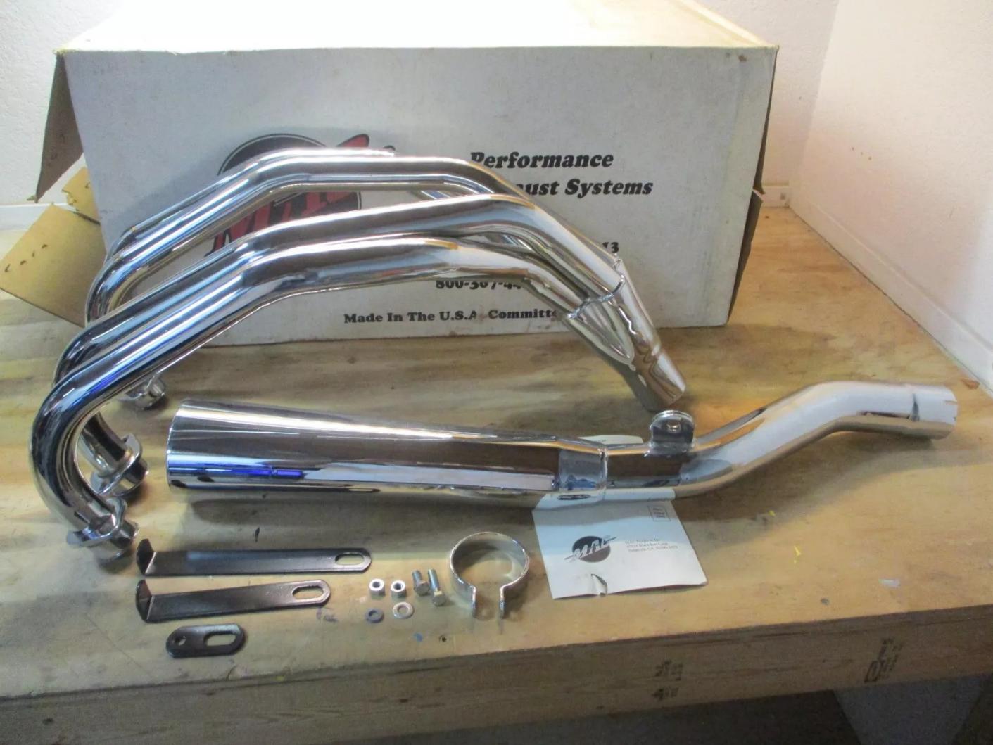

          Jeff if you have a stock exhaust in good shape, would you be interested in selling it perhaps?
          '98 GSF1200S '81 GS850G

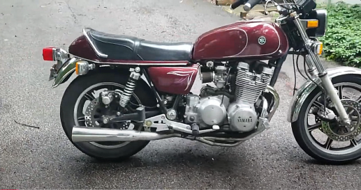

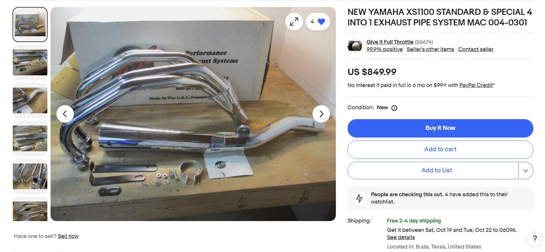

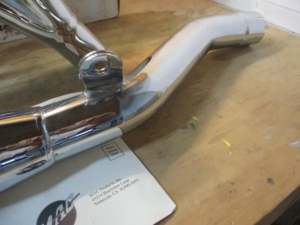

            Are you sure about that? This is a Mac and it looks very similar to your pipe.
            https://www.ebay.com/itm/305799566075

              EDIT: right you are Deebs, in my memory I was absolutely certain I saw a Kerker sticker on the back of the pipe when I had it in my possession for a few weeks two years ago, but looking through the few photos I took I can find no evidence of such. It indeed seems to be a Mac! My apologies.

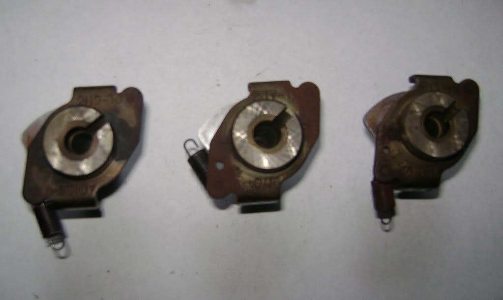

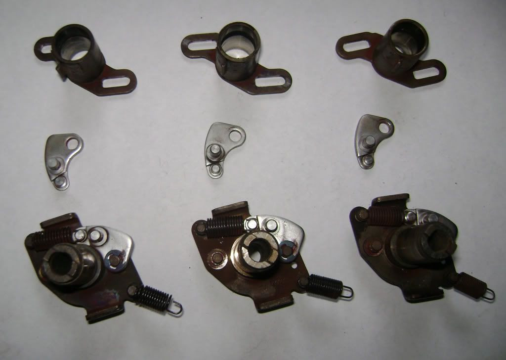

                I was looking at the excellent writeup in the interchange guide in regard to differences in ignition advance between the model years. Would switching back to the more aggressive '78 E base timing and curve be as simple as sourcing the springs and slotted bits and swapping them over to the '79? TCI, cams, identical? This is all purely hypothetical, the priority is to first get the bike 100% sorted and in good riding condition and putting some miles down before any of this sort of thing.
                  One way to see if parts are identical between model years would be to go to the parts fische and compare them, the Partzilla site makes this easy since they list all the models and years a particularly part is fitted on.
                    I know the TCI is the same for '78/'79, but I think the '78 had a little different cams. I'm not positive on the advance durve, but I don't think that changed much until '80.
                    • gtem
                      • May 2023
                      • 235
                      • Indianapolis
                      This was the page I referenced for the mechanical advance changes put together by crazy steve back in 2011:
                      "The 78 unit offers 26 degrees of advance, starting at 2150 rpm and it's all in at 4750 rpm, for a 'range' of 2600 rpm. The slots in the reluctor are .515"/.530" long; this is what determines total advance. The springs have 13 coils, and a wire diameter of .033". Remember that the 78 uses 10 degrees of initial timing for a total of 36 degrees @ 4750 rpm.
                      The 79 unit has 31 degrees, starting at 1800 rpm and it's all in at 5400 rpm, for a range of 3600 rpm. The slots in the reluctor are .565"/.585", and the springs have 15 coils with the same wire diameter as the 78 bits. Initial timing is retarded to 5 degrees, but you have the same total of 36 degrees, although at a higher rpm (5400).
                      The 80 unit also has 31 degrees (OK, the manual says 30), also starting at 1800 rpm but this is all in by 3900 rpm, for a 2100 rpm range. The slots on the reluctor are the same as the 79 unit, but the springs are lighter; 14 coils with a wire diameter of .028". Again, the same initial 5 degrees and total timing of 36 degrees, but all in at only 3900 rpm."
                      So the '78 had 10 degrees initial timing advance vs 5 degrees on the '79 and '80 components.
                      Does all of this even matter that much, especially compared to just making sure that the fueling is sorted out on a 45+ year old bike? I suppose not. But I guess I have a bit of a mental hangup knowing my previous bike was the "fast" one and that this incoming '79 had been "detuned."

                          I prefer the stump pulling low and midrange power of the 1980 timing parts coupled with the 1980 cams. A peaky, high rpm motor is not fun to drive unless you are constantly ripping on it. I guess it's fun if you like doing that. Poor motor.
                          • gtem
                            • May 2023
                            • 235
                            • Indianapolis
                            I'd be inclined to agree on prioritizing the "usable" part of the rev range over bragging rights. Do you run the '80 cams in an 80-81 motor with the bigger valves or a hybrid combo of high compression smaller valve 78/79 motor with '80 cams?
                              I run a stock 1980 motor out of this bike.
