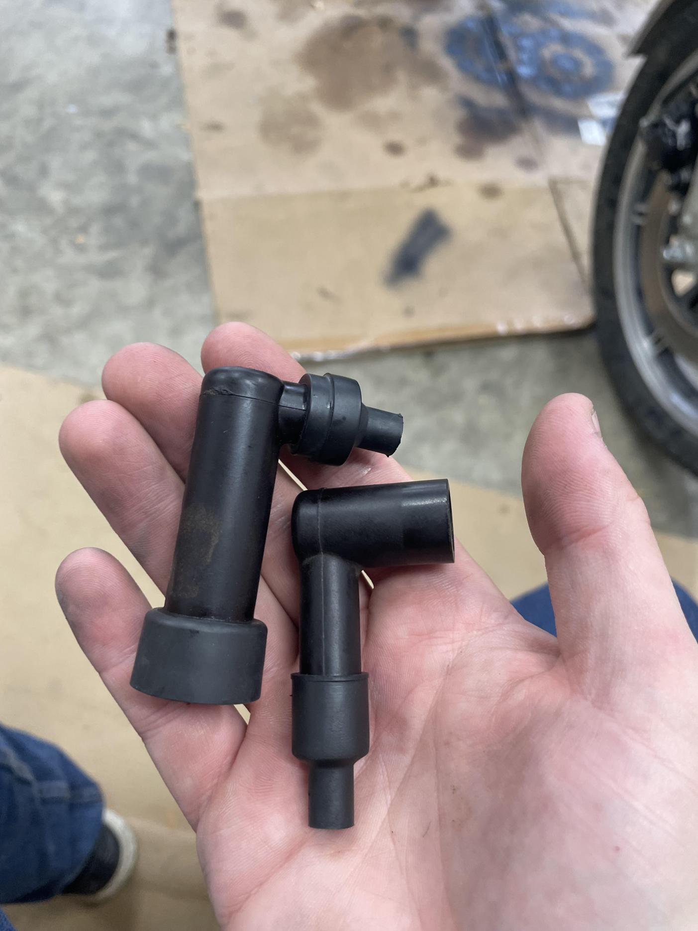

      My first interesting find: mismatched 10k resistor caps on the outside two cylinders, 5k resistors on the inner two cylinders, coupled to BPR7ES plugs. I am planning on getting a matched set of non-resistor caps and BPR6ES plugs (finding the BP6ES has gotten to be a real pain, I assume no longer produced).

        Finding good quality non resistor caps of that long reach style to retain the stock plug wires turned out to be trickier than suspected. The "path of least resistance" ended up being finding some BP6ES non resistor plugs via partzilla (Kawasaki and Honda still have them listed as factory part numbers, the Honda ones are $2.96 a piece), as well as two NGK 5k resistor long reach (OEM style) caps, also a Kawasaki factory park number assigned to an NGK part on partzilla ($4 a piece or so). So for future reference, at least for now, that looks to be a good source of these obsolete parts (NGK discontinued production of non-resistor plugs, and all of their phenolic plug caps).
        '98 GSF1200S '81 GS850G
          As mentioned, you can easily convert your resistor caps to non resistor, a Google search should turn that up easy enough.

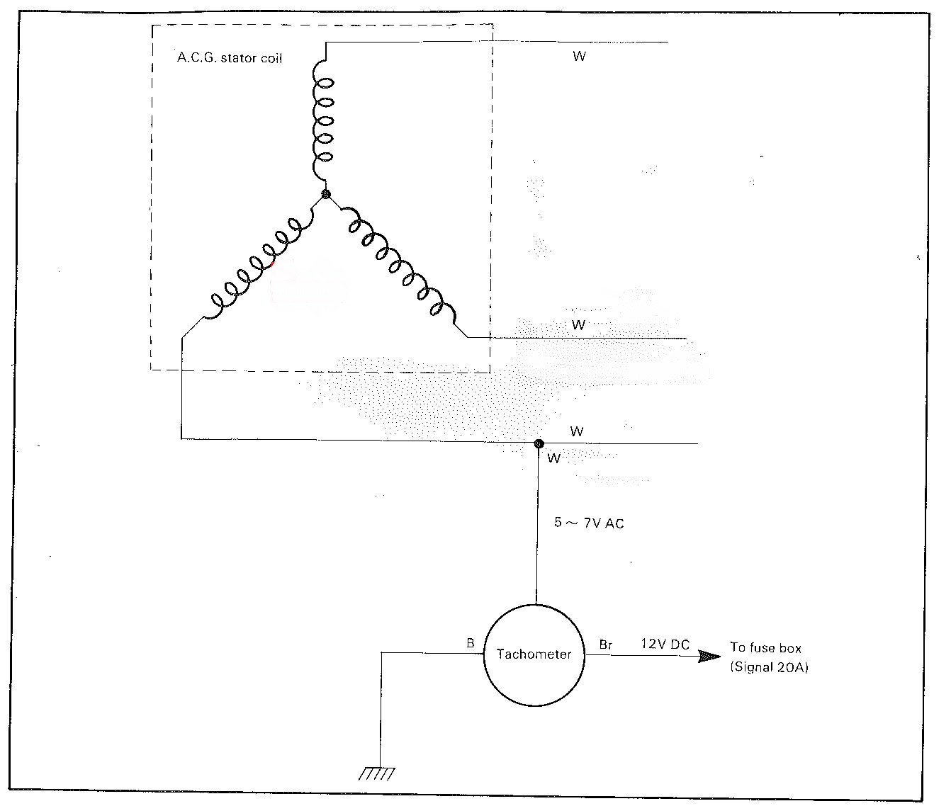

                        So the one issue that remains is the tach reading low. I confirmed with the original owner that it doesn't have the XS750 FD swap or anything like that. My '78E showed around 3600ish at 60mph in 5th. This one is only clocking 3000? Speedo seems to be reading accurately. Tach sees fine otherwise, runs up and down the rev range. Really weird!
                          #42
                          gtem, here is the schematic. Signal off of the stator either works or is dead but you could check you connections anyway. Check your ground (black wire). All your grounds actually around battery and near the regulator. The 0V reference for the system. This is the likely cause. It's what is giving an incorrect reading.
