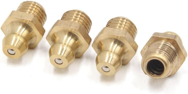

                Time to build the "Carb Pagoda" and really see wut's goin' on as far as the fuel levels in each carb bowl. (゚ ペ)
                Yur gonna need these to screw into the bottom of the bowls- (¯―¯ ٥)
                Click image for larger version  Name:	51zP1A73k4L._AC_SL1100_.jpg Views:	0 Size:	45.7 KB ID:	881177
                https://www.amazon.com/dp/B07468TJVH...roduct_details
                Simple to twist up the bailing wire to hold the see thru/clear fuel line. d(>_< )
                Note- Obviously the Zirk/Grease fittings aren't flow thru when you get'em. (O_o)
                Use a jeweler's screwdriver and/or pointy tweezers to pry the spring out from the threaded side. Then the check ball just falls out. (゜-゜)
                Bonus? The springs and the check balls are the right size fOaR the detent balls/springs in the choke rod one has to remove iffin' yur ever gonna break the carb bank apart. (^_^)

                    I love that fitting Larry. Cool tool!
