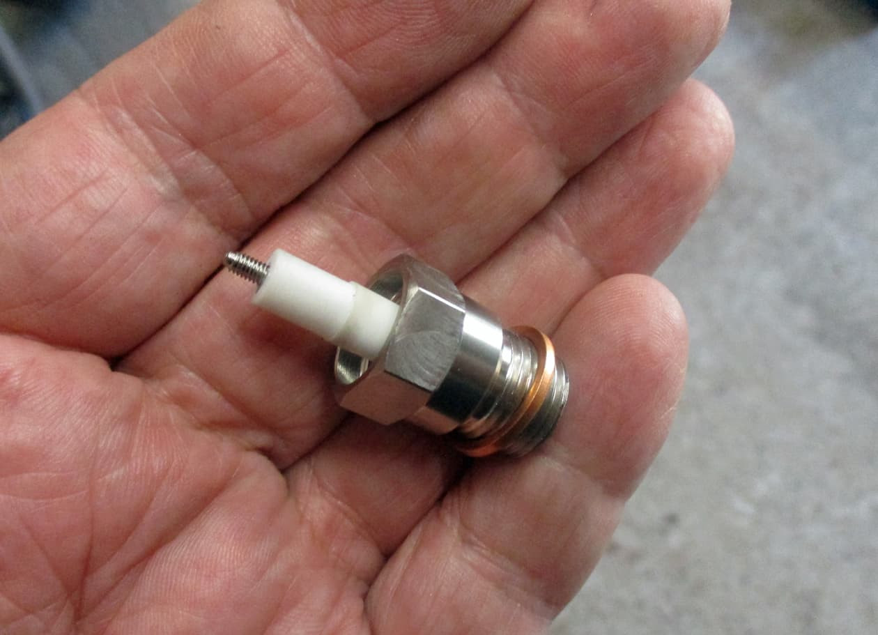

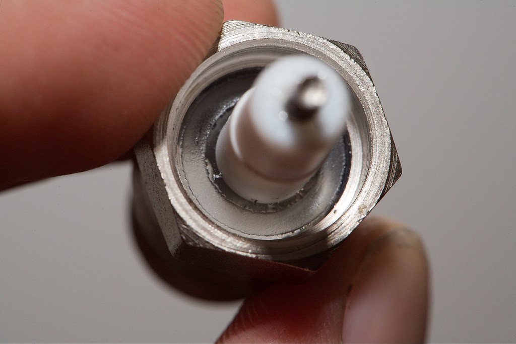

          I don't know which gauges you purchased. If they are that erratic, you may need to utilize restrictors in each line to stabilize the fluctuations. I have the Morgan carbtunes that don't have any liquid in them. Some folks don't like them but I have used them now for 20 plus years and they get the job done for me. Morgan Carbtune - carburetor synchronizer for balancing motorcycle carbs. Another tool I have and use is the Gunson Colortune (gunsonshop.com). I use it to dial in the idle mixture screws. I was never good at listening to the engine while I adjusted. This tool is visual and I can get them dialed in. The color I shoot for is just the slightest hint of orange which is towards just to the rich side. My bikes run great at this adjustment. What you don't want is lean which relates to heat and major problems. A good starting point on the idle mixture screws is 1.5 to 2 turns out from lightly seated. On the carbs you have you will have to be very careful when seating the screws. The tips of those idle mixture screws can break off and plug the idle mixture port causing other problems.

            Great stuff, I ordered the Colortune because Im deaf in one ear so this will help.

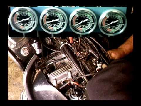

                  If you're an "old fart" like me, you still have a tach/dwell meter. You can hook that up to one coil and use it to show you what the RPMs are doing as you adjust the carbs. I usually start on the left and work my way right. As you adjust, you will probably need to turn down the idle a bit. I usually try and keep it about 800RPM for this. The good part, it's ALL visual, so you don't need perfect hearing.
                    An Analog Tach/Dwell meter will only read 1/2 the Rpms but it's still good enuf to do the idle mixture screw adjustment. (^_^)
                    Latter half of this video.....
                      Larrym, set correctly, the tach/dwell WILL read the engine RPMS. You have to set the cyl. number at 2, if your machine has that.
                        Only settings were 4, 6, or 8. (。•́︿•̀。)
                        The old school analog tach we used (and I still have...) is the most accurate at "full scale deflection" meaning when the needle is moved farthest away from the normal "at rest/zero" position. At the minor deflection and scale the needle was during the "tuning" it could only barely register the 50 rpm drop at the required point of adjustment fOaR the idle mixture screws. (´-`). 。oO
                        Fairly sure that Scott used his ears to detect that rpm drop and the tach we used was just eye candy fOaR video porposes. (•‿•)
                          Here's another vote for the Colortune. I use it quite a bit. Very accurate tuning.

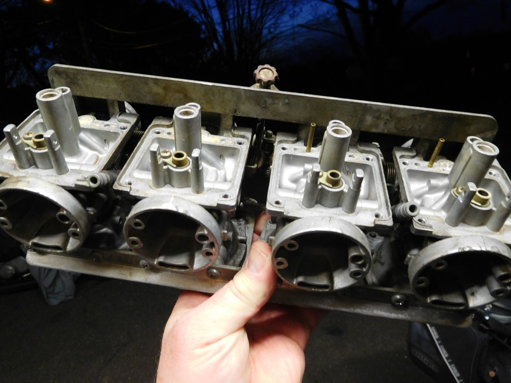

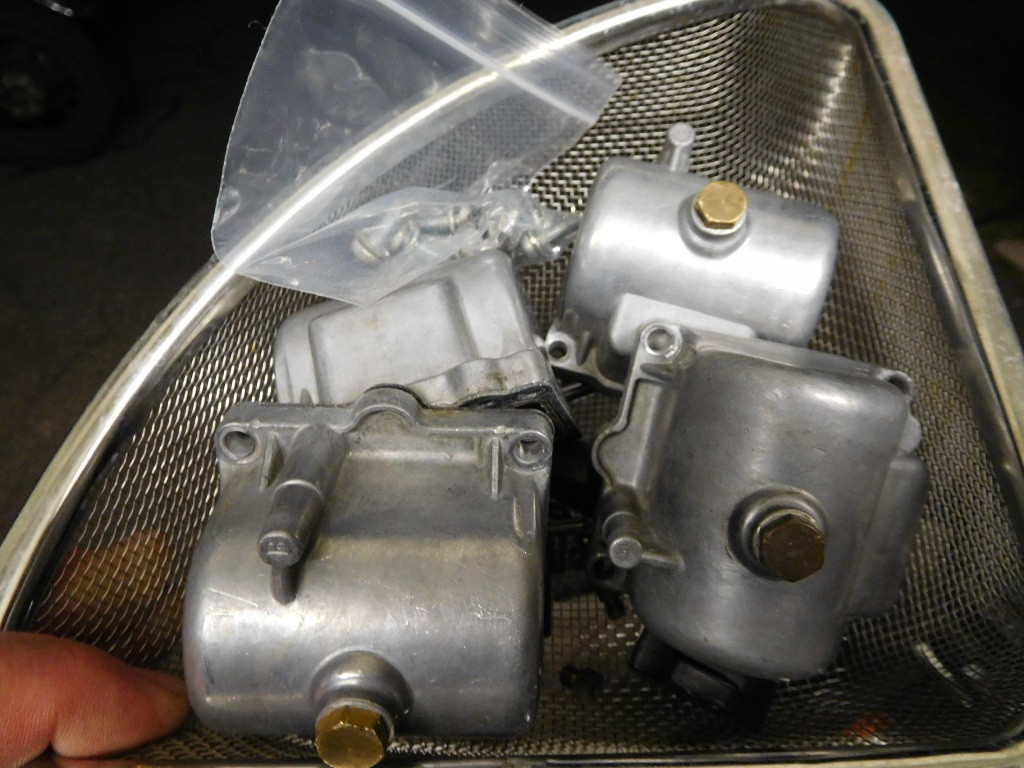

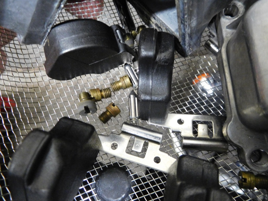

                              The safest way to proceed is to use all your old brass after the parts soak in a carb dip. I always re-wash the jets in Simple Green to get all the chemical off the parts. The only other parts you would need are gaskets and O-rings. The seat brass can be cleaned in the same way I mentioned but I always use Q-tips to polish out the clean seat with Mother's Mag Polish. I have done this to a lot of bikes with perfect results.
