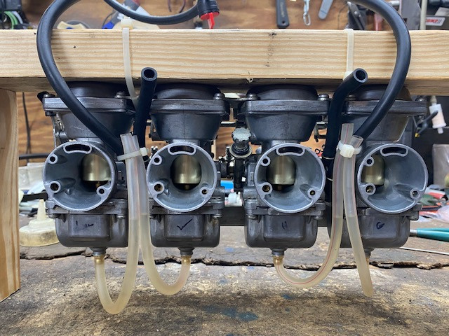

      No need to take them off the bike. Just a picture from the side with them mounted would be enough. Specifically the tops will identify them. Take a look at this thread. Carb Identifier Guide, take 2 - XS11.club Forums
ID:	881454 Early carbs with exposed mixture screws

          Hey guys so now I shift over and have to ask, since the plug is wet and sooty how can I tell if it is fuel making it black and sooty OR the awful question is it OIL ?
            #65
            1. Run it for a few minutes so it's at normal operating temp. Swap in a new plug, restart and run for 30 seconds. pull the plug and try to smell gas on it.
            2. Repeat above, but wipe plug with clean paper towel and see if an oily residue is part of it.

              Def fuel, carbs coming off yet again !

                      Got it ! thanks to all it seems to have been a combination of fuel bowl level as well as previous hands touching what they should not touch. Idle is great, fuel mileage doubled.
                      Lots of help from you fellas
                        #71
                        Glad it's running good now, these really are great fast reliable bikes when everything is dialed in. Every different one that I've ridden (20+) over the last 30 years has had her own "personality".
