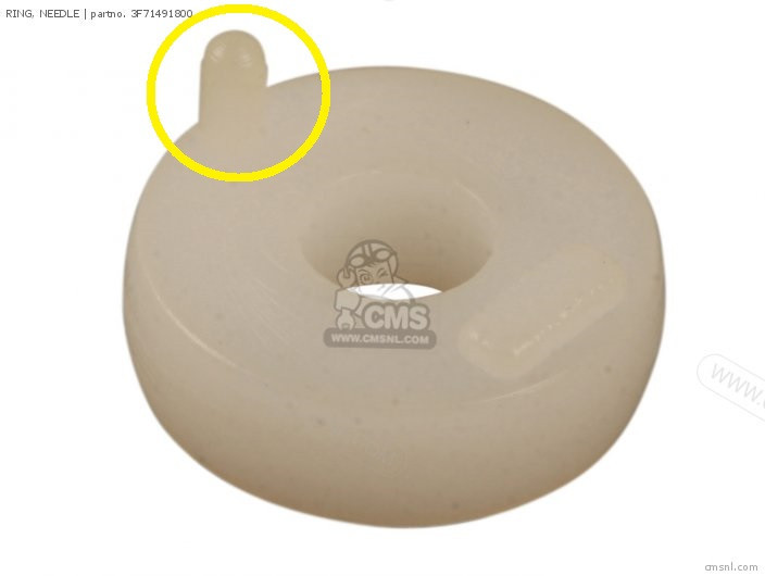

              All good advice. Especially the sync. Also, check to see that the slide needles fit all the way down in their hole. There is sometimes a white plastic washer that has a tit that fits into a tiny hole at the bottom of the slide. It can fool you and cause a terrible off idle rich condition. It happened to me.

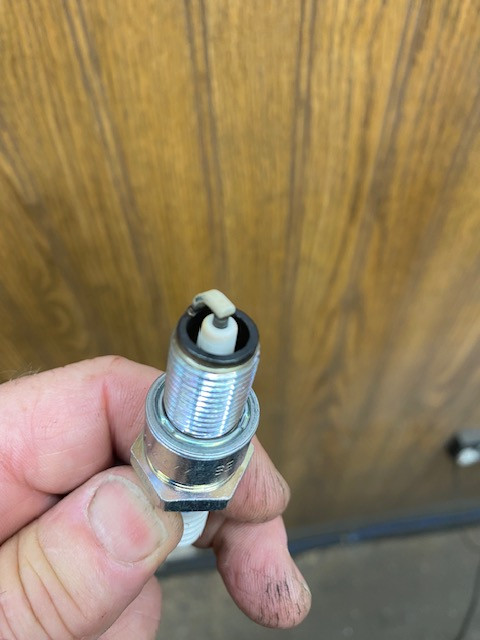

ID:	881002 Bench Sync done, I went ahead and ordered up a 4x gauge set. I sort of understand how the idle mixture will give me the rough low end but why is #1 soooo rich compared to the other 3. Can the idle mix cause this? If a coil wire were shorting I would expect a miss under load but it is happiest beyond 1/8 throttle.
                2,3,4 look like this
