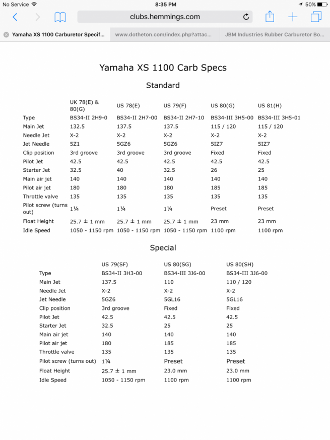

    Carburetor Facts
    by Phil Stewart
    Here is the list of carburetors and associated jetting for the various years. NOTE- many bikes have been equipped with high velocity exhausts and accordingly will have larger pilot and/or main jets installed.
    Models and Jetting
    Year Model Main Jet Pilot Jet Start Jet Main Air Pilot Air Throttle Valve Carburetor
    1978 E 137.5 45.0 40 140 180 135 Mikuni BS34-II
    1979 F/SF 137.5 42.5 32.5 140 180 135 Mikuni BS34-II
    1980 G 1981 H 115(1&4) 120(2&3) 42.5 25 140 185 135 Mikuni BS34-II
    1980 SG/LG 1981 SH/LH 110(1&4) 120(2&3) 42.5 25 140 185 135 Mikuni BS34-II
    1982XJ 112.5 47.5 25 140 170 ? Mikuni-BS34-II

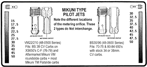

    Click image for larger version  Name:	Mikuni_Jets.gif Views:	424 Size:	17.6 KB ID:	860761
