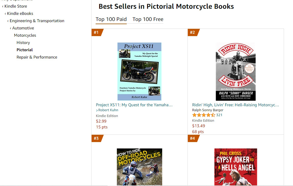

              Cool. Thanks. Hope you enjoy it... Just hit #1 best seller in its category.
