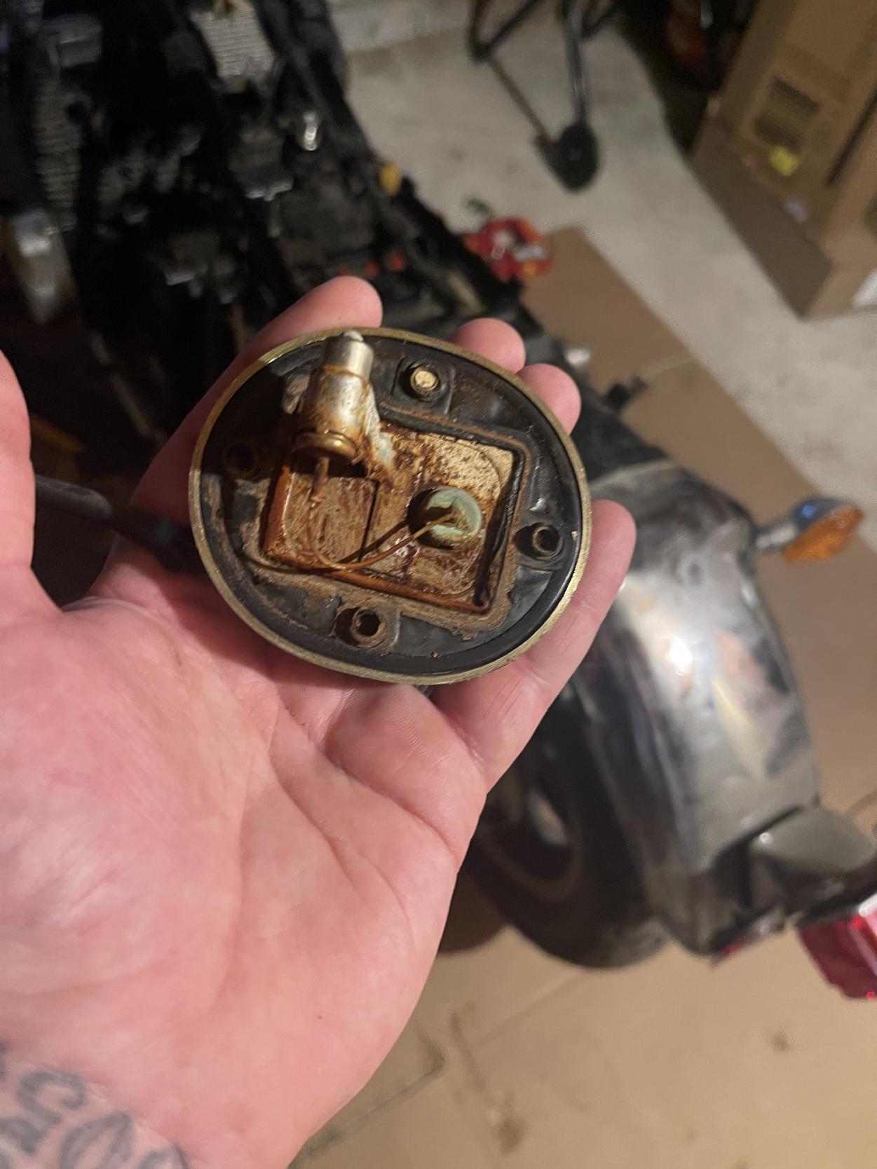

                  Yes Cajun ive done the research and have ordered 6 gallons of apple cider vinegar online. I've taken off petcock and the tank lid. I'm going to get some good duct tape and make sure it sealed up well. As for this fuel level sensor I removed it as fell. should i but a new one or just kind of clean this with the vinegar w/ Toothbrush???
                    Good deal. You will be pleased with the result. as for that sensor it looks like it is in good condition. I would just hit that with some carb cleaner and a small wire brush. Should clean right up. Hopefully it is in proper working order. That black gasket on it looks a bit dried and might be brittle. You should lightly work it off to inspect. Hit is with some WD40 and get it off. It might need to be replaced. If so it can still be purchased. Here it is on Partzilla.
                    GASKET, SENDER UNIT
                    2H7-85753-00-00
                    Yamaha Motorcycle 1980 OEM Parts Diagram for Electrical - 2 | Partzilla.com

                            I have an ultrasonic cleaner at work that we don't use. Think I can throw it in that thing?
                                I use my ultrasonic cleaner to clean carb parts if they are not too dirty. I would be careful with that particular part. Just a light cleaning is all it takes.
