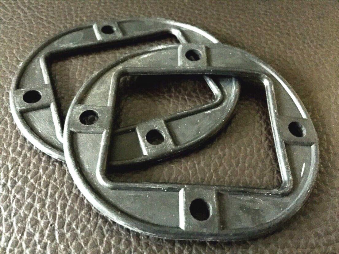

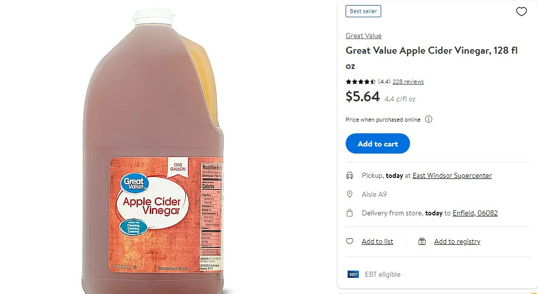

      Walmart sells gallon jugs of apple cider vinegar for about $6.00 per gallon. I get the sender gaskets from eBay:
ID:	873552 Click image for larger version
