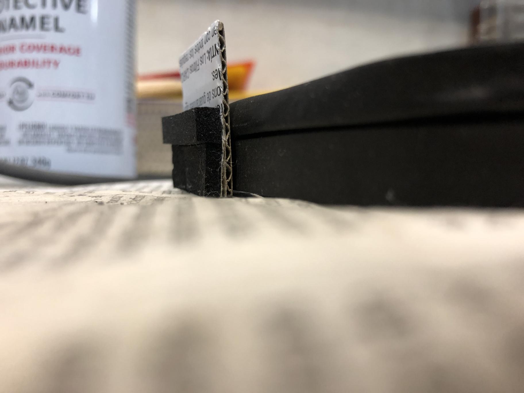

              I like your approach for the gauge gaskets. I tried using two strips of EPDM:
Name:	Replacement for Gauge Gaskets.jpg
              I am really enjoying watching the fantastic job you are doing. Your attention to detail is uncommon.
              That bike is going to be ready for more than 100,000 miles of fun, and it's going to look perfect.

                Thanks, I appreciate it. Glad people are enjoying this; I build a lot of bikes, but have never done a thread like this. I dont have much of an online presence.
                The rubbers I used are actually motorcycle muffler hanger insulators like the photo I attached, except I used grey just because.
