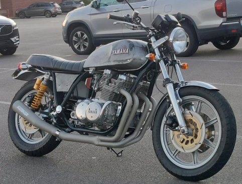

                            Still a couple tweaks to make, but it's got about 500 miles on it now, should be pretty much broken in.
                            Bike pulls very hard and handles pretty good for a big pig. Brakes feel perfect.
                            It was a lot of figuring out and work, but Im happy with how it turned out. This forum helped a TON along with a few of the members here.

                                #60
                                Nice work! Congratulations on its completion. I envy your skill at this.
                                Are you running stock ignition? I am curious about the effort in using the GPZ carburetors. Stock spigots?
                                Your front springs are straight rate? Did RaceTech help you with the tune?
                                You did a fine job of making this big bike look compact and sporty. I like it. If I may be critical, the one feature I don't appreciate is the stock clock assembly. It's too big and catches my eye. I think a small instrument would enhance the bike. Maybe lower the headlight as well. Once again, nice job. I think your execution of this project was outstanding.
