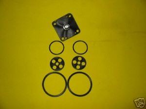

                          Man what a bummer, ordered the wrong part yet again!!!! I am looking for the rubber washer that has the five holes in it that goes in the petcock. Ordered the wrong one from boats.net. They don't have it listed individually on the schematic so I picked the wrong one. Can someone please help me order the correct one. I ordered from the 1980 sg so that was the correct petcock.

                            #58
                            These are correct for your 79 Special.....

                              #59
                              I'm looking for the part number for the individual seal.

                                #60
                                Yamaha P/N 3H3-24523-00-00
