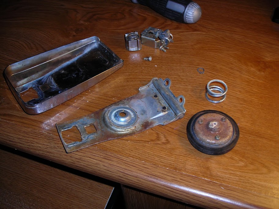

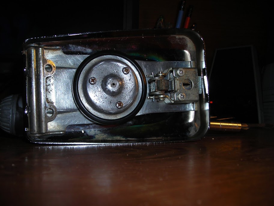

                  #38
                  Alright, I feel like a new man!
                  Before:
                  In between:
                  After:
                  Tools:
                  That screw driver you see poking out in the last picture
                  A little flat screw driver to help with the clip
                  Emory cloth multi-pak from harbor frieght
                  My hands
                  SWMBO's hands to hold the spring down while I put the clip back on
                  Time:
                  1:20
                  I couldn't get all the rust out as I have no power sander or dremmel tool, but I'm not sure even that would have worked completely. However, there is a whole lot less!
                  Now to put it on and see if the gas tank will stop singing after a quick ride around town!
