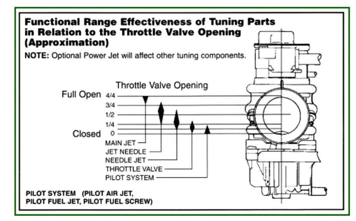

        Found another inconsistency with the carburetors today. Number four is from an early XJ650, needle was also from the XJ650, wasn't paid attention to by the dealer who rebuilt the carbs for my uncle. XJ650 needles are much richer than the XJ750 needles. Changed it out for the proper needle today from a spare carb. Slowly sneaking up on getting this thing dialed in from all angles lol.
