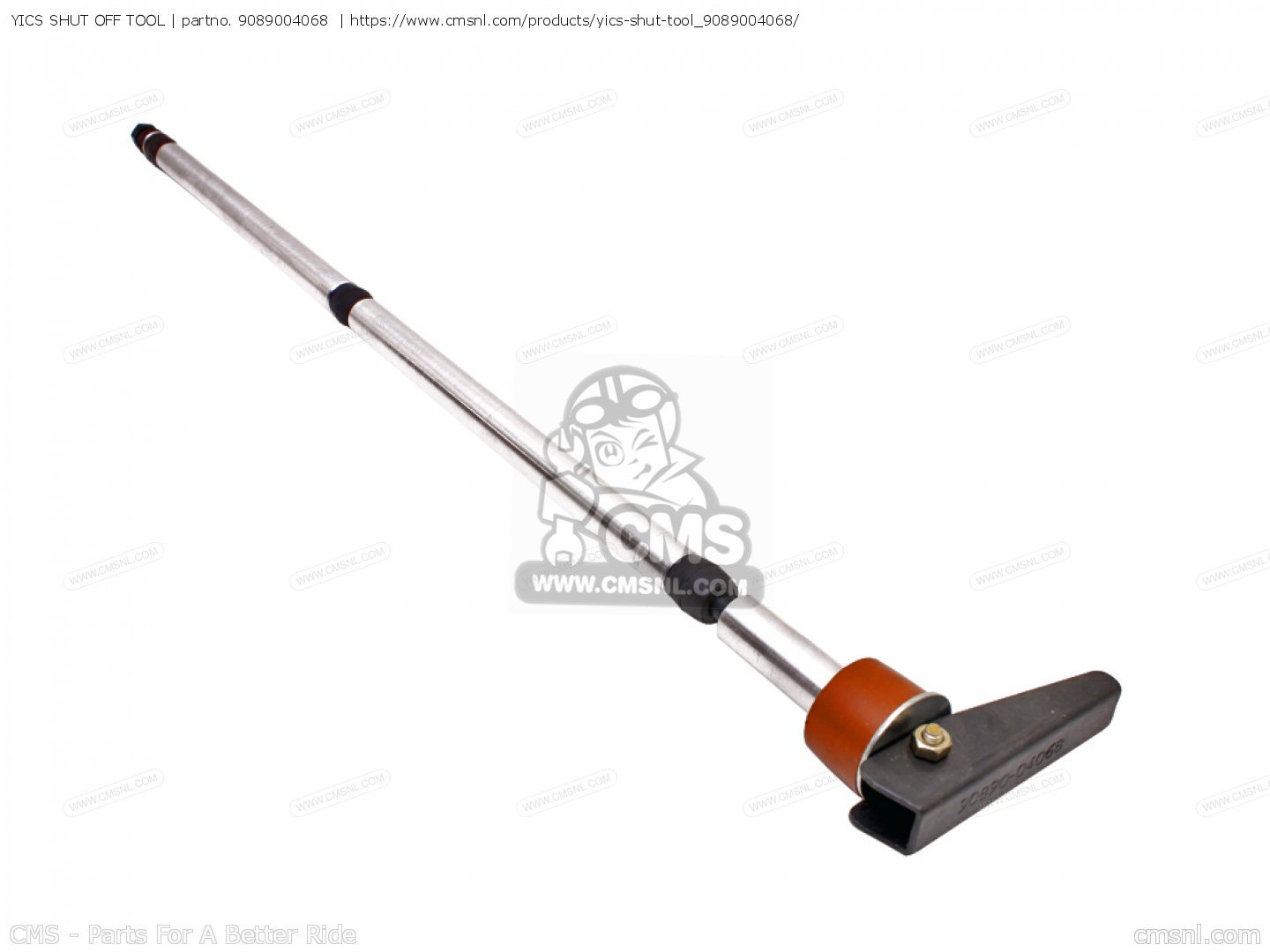

      What say the collective on sync-ing without a YICS tool? My thought is it would still be better than a bench sync/no sync. What are thoughts as I don't have a YICS tool and have heard it works ok without and others say the tool is necessary.

        Howard, I have no real world experience with YICS. Never owned a bike with it. I read an old thread that stated XJbikes.com sales a YICS blocking tool. What is a YICS tool? | XJBikes - Yamaha XJ Motorcycle Forum. There is a response from Chacal that states they sold their tool for $37.00. Been a while since the thread was done so the price might be a bit more. If it were my bike I would invest in a YICS tool. Would be worth it in the long run if you plan to keep the bike. As good as it looks I am assuming that is the case. There are also several YICS tools out on Ebay. Most are from Japan and cost in the neighborhood of $90.00 plus shipping. The reason I did more research and found the XJbikes option.

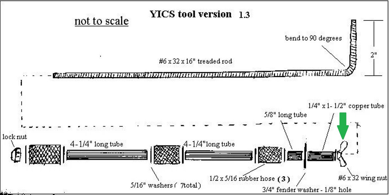

              • 7784
              There WAS a post about making one a few years ago. It may have made it over if you search. As I recall, it's fairly easy to build with parts from any good hardware store.

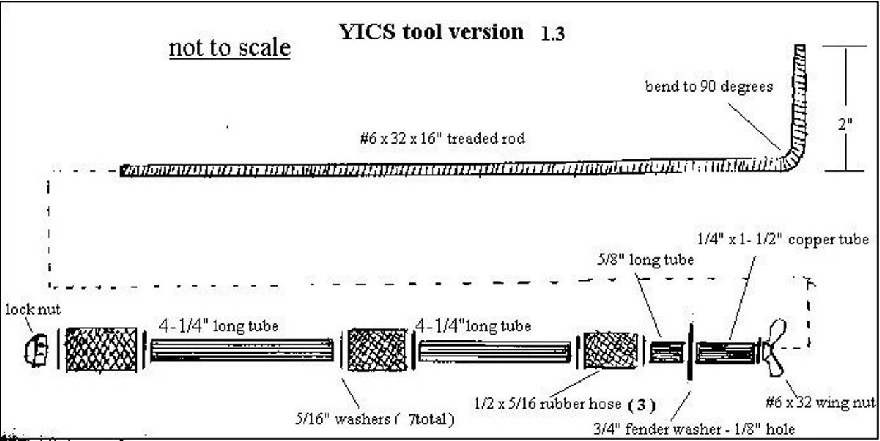

                Thanks DiverRay, I've read up on making the homebrew version and a lot of times pulling them out has become an issue with some of the rubber parts that are specified hanging up on the way out, even after guys have cleaned the ports from side to side with a gun cleaning brush and solvent.
                One of the more simple ones I've read about is soaking a thin, long rag/cloth in ATF or oil, pulling it all the way through and then stuffing it back in from each side to effectively plug the ports. Doesn't get hung up on deposits and I've old thin t-shirts that could become a donor.

                        • 7784
                        A little silicon grease on the rubber and it should slip in and out easily. The grease will not cause any problems with the sync, as it's neutral,

                            Thanks DEEBS, anyone have experience with the homemade version and how well or not well the tool comes back out? That's the main thing I've read about, the rubber hose catching.
                            Bonz, the tool installs and removes quite easily. There is a device to make the seals expand tight.

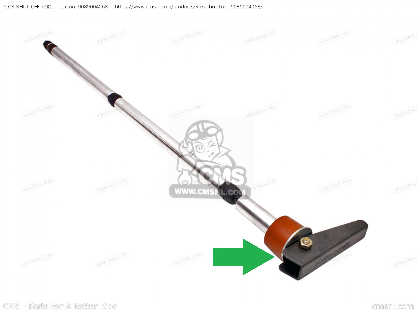

                                • 275
                                Howdy Bonz,,,,I have made the YICS tool and also have the real deal. After using both the Yamaha Yics tool is superior,,,the homemade version is a sloppy fit, I always felt like rubber pieces break off,,,the Yamaha tool is larger rubber and slides much easier in the channel,,,,after slapping hi temp grease on the rubber it works great.....also there is a YICS eliminator tool which is a very good alternatiive if you can find it. Someone made it on the site years ago. It balances the carbs nicely, but leaving it in does affect the gas mileage a couple mpg's in my use. SSSoooo if you can get ahold of the factory YICS tool,,,around 50 bucks on ebay it is the best overall. The eliminator is second as it can be used to tune,balance and leave it in, then the homemade version which kinda works....or you can wait till the next Colorado rally and I can bring mine out.....cya, Mike in San Diego and Pa......
