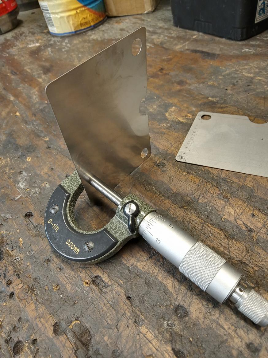

      Well, the SS shim material I'm using is .012", perhaps the flashing material you're using is a bit thinner and can't absorb the vibration?

        You might be onto something there bikerphil. What I used was Home Depot roof flashing that comes in a 6" wide roll, brown on one side - white on the other and listed as being .0115" thick. Also like your configuration of home-made shim. I got fancy and almost wrapped the pad, except where it it would obstruct movement. Kind of thinking now that it needs to be a little less attached to work properly. Do you think it would make any difference if I put one behind the non-puck-side pad, too? And of course grease the (bad word) out of everything.

          You could try a shim on the inboard side, it couldn't hurt. I wouldn't go too crazy with the grease, you sure don't want it to migrate to the pad material, just a thin layer behind and on top of the shim and also on the slots on each end of the pad. I think new fresh organic pads would definitely reduce the tendency of squeeling.

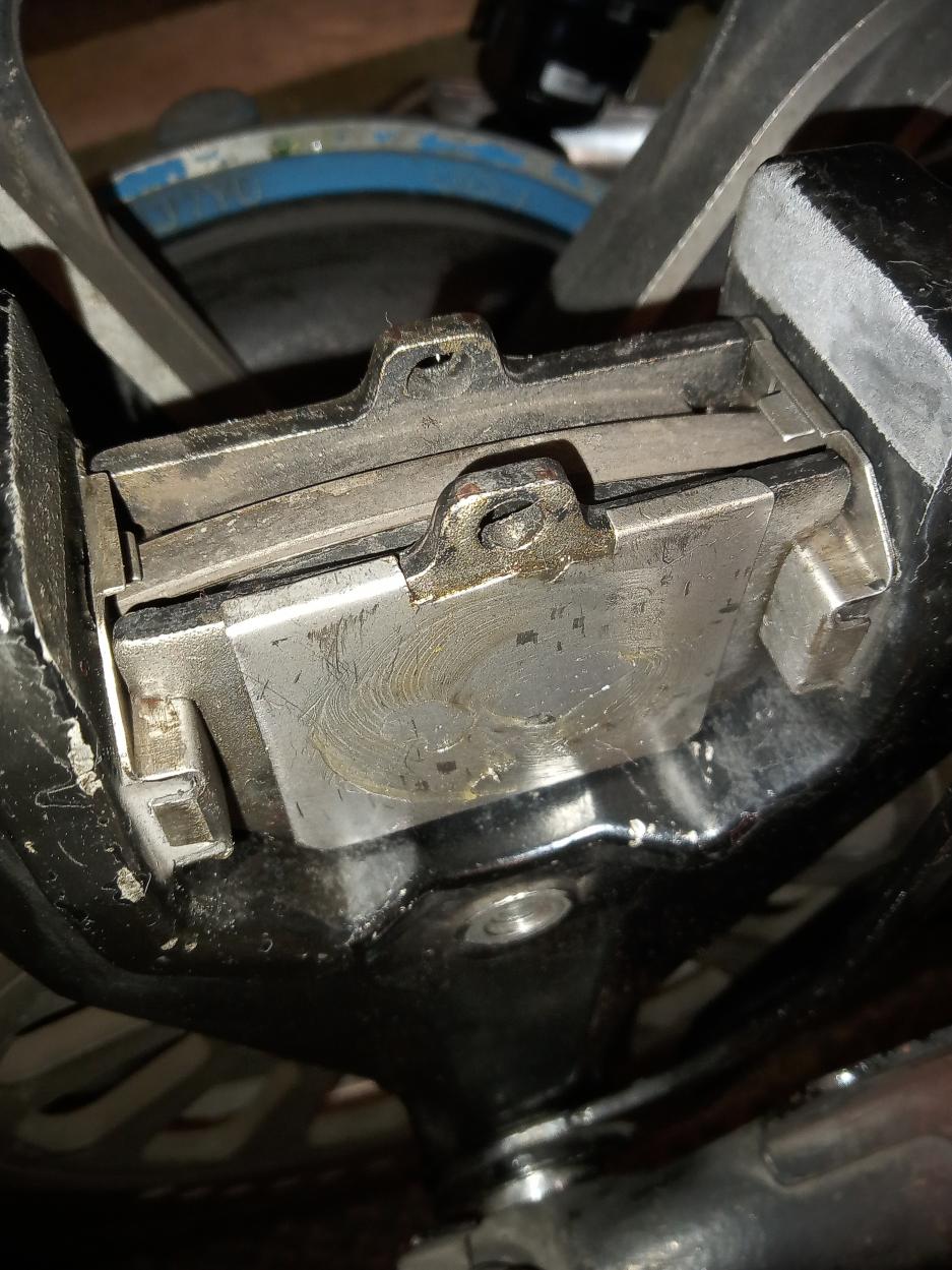

                Striipped everything apart again and applied a little grease on the pad sides of the shims - only applied on the puck sides before. Also found that my home-made replacement inboard pad locator screw tips weren't small enough and, when fully snugged down, actually secured the pads instead of allowing them to float - a possible further cause for noise and eventually uneven wear. The long/short of it is that once all bolted back together, a quick blast down the back lane, stopping hard several times, produced even, quiet braking. Good for now - we'll see how long this will last. Maybe Santa will hook me up with a nice set of organic pads. If only I'd been a good boy.....
