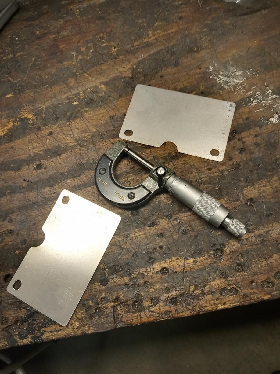

    Make a shim for the back of the piston side pad, usually solves the problem, has for me. This is the material I use, need to custom cut and form to fit our brake pads...

      Am I right in identifying this as a piece of stainless steel sheetmetal? I assume the thinner the better. Also assume this will help absorb any noisy vibrations. Like to try and source something north of the 49th if I could (shipping/duties/exchange can get silly) Any opinions on this product?

        Yes, it's a .012" thick piece of stainless. The item in your link is a fiber type shim, who knows, may work as well or better. The adhesive backing would make it easier, no bending any tabs. The one I listed is for an old Volvo or Audi.
        Click image for larger version  Name:	IMG_20230828_233914.jpg Views:	0 Size:	166.3 KB ID:	875171

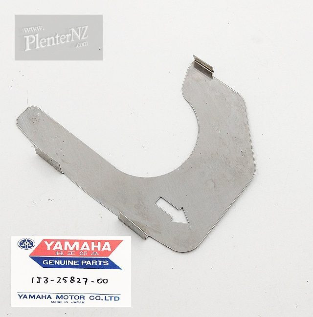

          The bike came with shims stock but as you know previous owners chucked those in the trash on an early brake pad change. This is a picture of a stock rear unit.

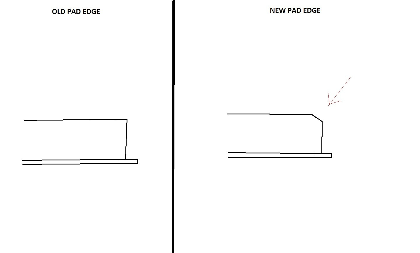

            • 2090
            When brake pads squeal it's actually a vibrating sound. Grease and brake squeal spray are effective to a point. The stainless shim is about the best material because it's so thin and can take intense heat. You can also shape the leading edge of the pad by grinding it off to a slight angle. Be careful of the dust as it's most likely asbestos.
            Click image for larger version  Name:	BRAKE PAD EDGE.jpg Views:	0 Size:	54.7 KB ID:	875177

              Owned my standard from the showroom floor - never had any shims for the front brake pads. At least they're all the same so I can rotate them directionally maintaining location (fronts stay front only).
              bikerphil - not paying over $30 shipping for a .49 cent part - thanks for the link anyway - will try and source some sheetmetal stock of the same specs here. May try the fiber ones but don't think they'll be very durable.
              DEEBS11 - thanks for the tip regarding slight bevelling the leading edge - will do both leading and trailing as I rotate directionally.

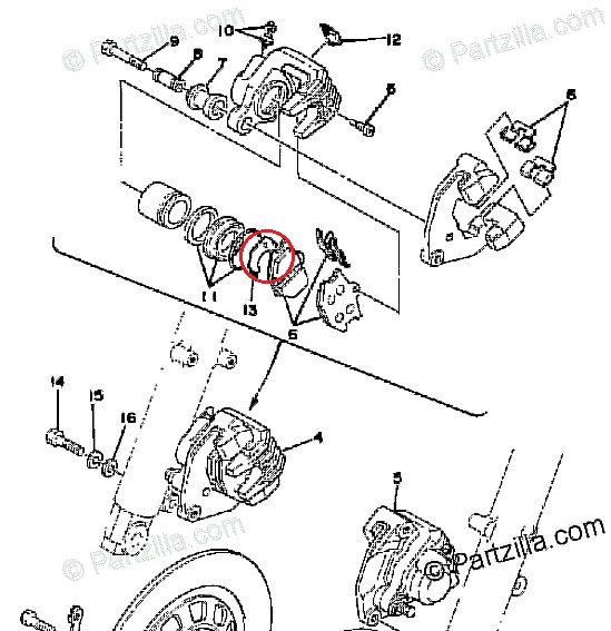

                  • 2090
                  It's true. Yamaha 1J3-25827-10-00 SHIM, CALIPER. 99% of these were thrown away with the worn pad because they look like they are part of the pad. My 78 that I pulled out of the swamp still has them and I transferred them to the new pads.

                    Thanks Ray - will do! Silent stopping here I come!
                    DEEBS11 - only the front brakes making any noise - no shims shown on that fiche.

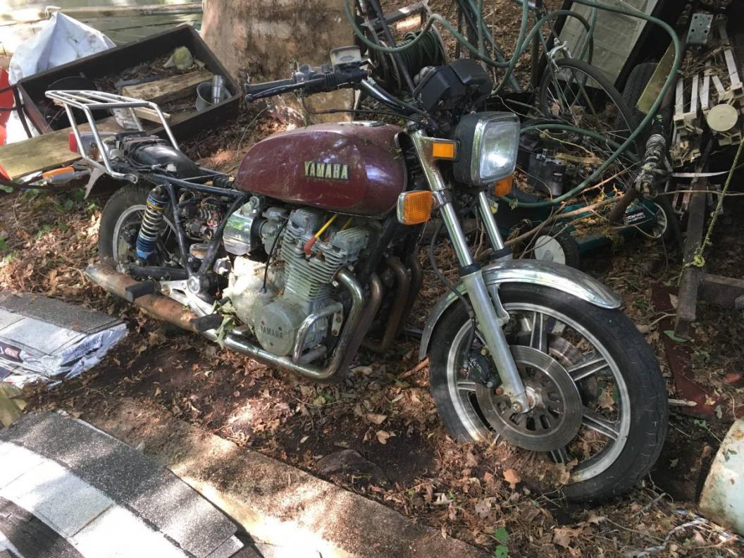

                      • 2090
                      Brake shims somehow survived on this basket case bike.
                        • 2090
                        Len, what year is that diagram? Mine is a 78. 1980? (I just checked) looks like the shims were dropped for later bikes. Cost savings?

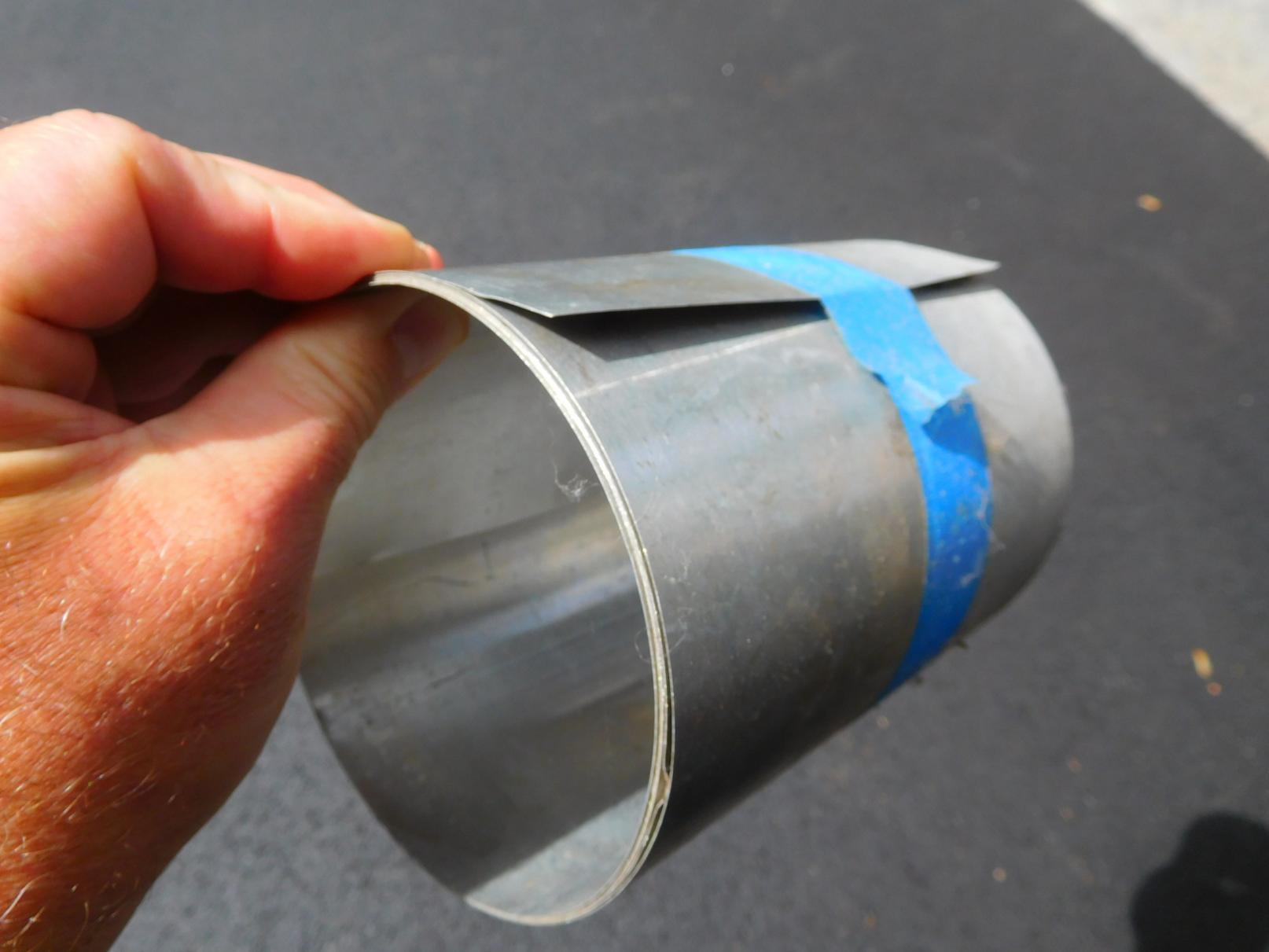

                          • 2090
                          Flashing material for roofing is cheap and could be used for shims.

                              DEEBS11 - took your roof flashing suggestion and ran with it. A little fancy cutting to make a nice "glove" for the puck-side front pads + a dab of brake grease and so far - dead silent! Neighbors already think I'm nuts - now it's for sure after flying down the front street and hammering on the brakes several times to help seat the shims.
